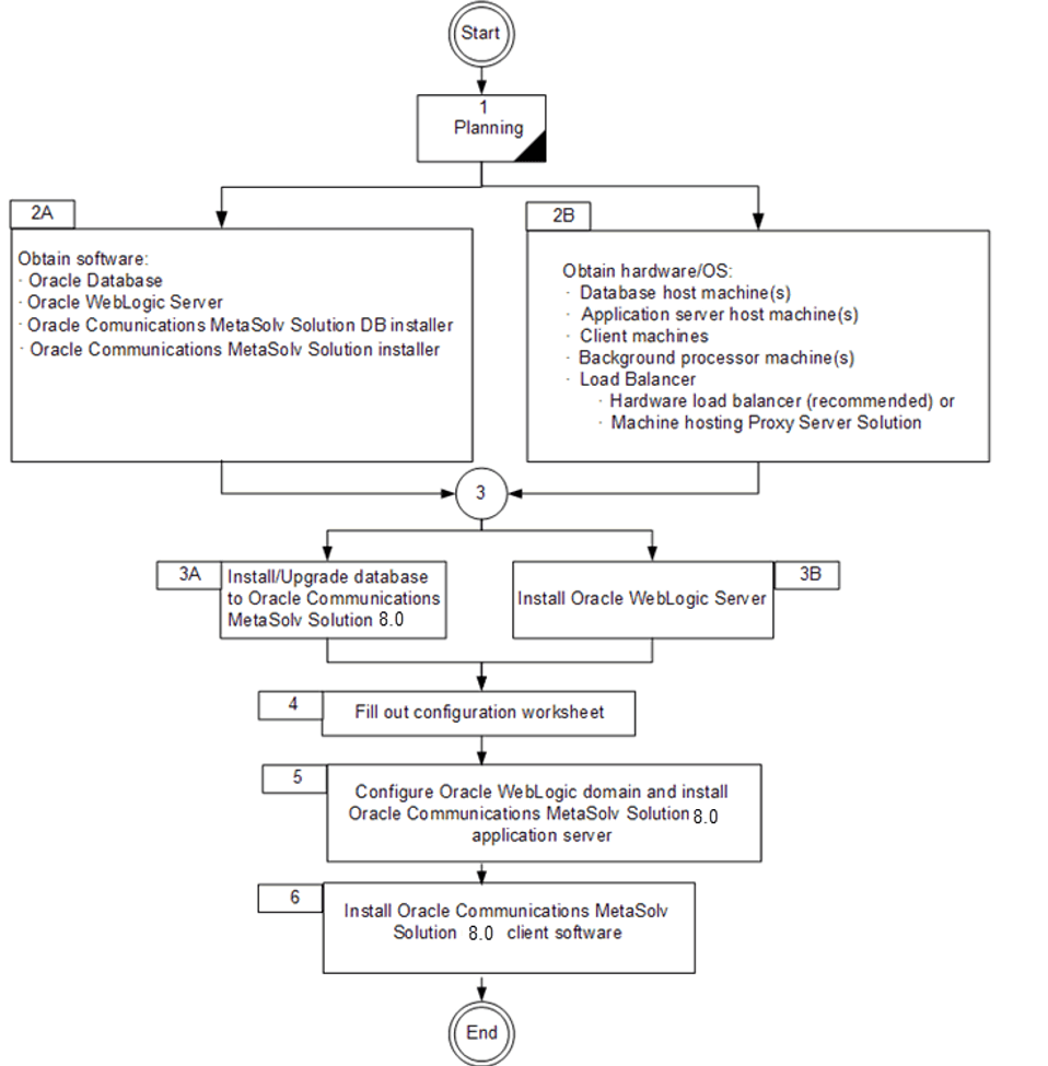

Installation Process
This section provides an overview of the installation process. The chapters that follow provide full information on each step. Figure 1-1 shows the high-level installation process.
Figure 1-1 Overview of the MSS Installation Process
Description of Figure 1-1 follows
Description of "Figure 1-1 Overview of the MSS Installation Process"

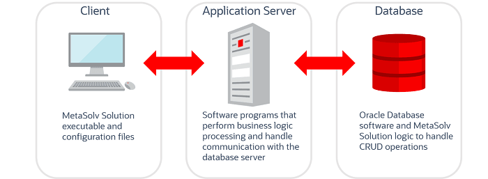

Where MetaSolv Solution Files Reside After Installation
In a MetaSolv Solution installation, application files are divided among the following locations:
  • Application server: MetaSolv Solution software that controls business logic and processing is loaded to a designated computer or computers. This software is designed to work with the Oracle WebLogic server software and improve the speed and efficiency of the information flow between the client workstation and the MetaSolv Solution database.
  • Client workstation: The files loaded to the client workstation include executable files that allow the operation of MetaSolv Solution for the user interface and INI files that configure the software. Initially, these files are loaded onto the application server in CAB files.
  • Citrix server (optional): If you are using a Citrix server, the client workstation files are loaded onto the Citrix server, and the client workstations use a Citrix browser to interact with MetaSolv Solution.
Figure 1-2 shows a simple MetaSolv Solution configuration.
Figure 1-2 Simple MetaSolv Solution configuration, showing where files are loaded
Description of Figure 1-2 follows
Description of "Figure 1-2 Simple MetaSolv Solution configuration, showing where files are loaded"

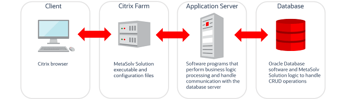

You can use a Citrix server to increase efficiency between the client workstation and the application server. In this configuration, the client workstation files are loaded to the Citrix server and a browser allows the user to access and use the application files on the Citrix server. The Citrix configuration is a good solution in cases where a wide area network (WAN) is used and users must communicate with the application server and database over great distances.
Figure 1-3 shows a MetaSolv Solution configuration with the Citrix server.
Figure 1-3 A MetaSolv Solution configuration, showing the Citrix server
Description of Figure 1-3 follows
Description of "Figure 1-3 A MetaSolv Solution configuration, showing the Citrix server"

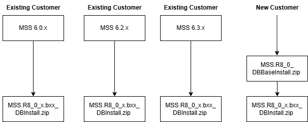

Database Upgrade Path
Figure 1-4 shows the upgrade path for the MSS database if you are on a pre 8.0 version.
Figure 1-4 MSS Database Upgrade Path
Description of Figure 1-4 follows
Description of "Figure 1-4 MSS Database Upgrade Path"

Basic Installation Steps
Each of the steps shown here for installing MSS contains additional tasks and information that you must know to proceed with the installation. The chapters in this book discuss each basic step.
  1. Plan the installation by completing the following tasks:
    1. Plan for the hardware and software you will need to implement MSS.
      See "MetaSolv Solution System Requirements" for hardware requirements. Also, see MSS Compatibility Matrix for information on software version requirements.
    2. Complete the pre-installation checklist in this chapter.
      The checklist contains planning tasks that should be done before you begin the installation process.
  2. Obtain the appropriate hardware and software.
  3. Prepare the database and application server environments by completing the following tasks:
    1. Install Oracle Database. See "MSS Traditional Deployment Software Compatibility" in MSS Compatibility Matrix for information on required software versions.
    2. Install the MSS database.
      To complete this step, you must run the appropriate MSS database scripts. If you do not currently have the recommended release of the database installed, see "Setting Up The MSS Database" for information on getting your database to the current release level so that you can apply the current maintenance release.
    3. Install WebLogic server and JDK on machines that will host the application server.
      To complete this step, you must install Oracle WebLogic Platform on each machine hosting MSS. You can install your system in different configurations, but each machine must have Oracle WebLogic software installed. See "MSS Traditional Deployment Software Compatibility" in MSS Compatibility Matrix for information on required software versions.
  4. Complete the worksheets that define properties for the installation machines.
    Worksheets are included for each installation configuration type that MSS provides. The worksheets let you identify, in advance, information that is needed during the installation.
  5. Install and deploy MSS on the Oracle WebLogic application servers by completing the following tasks:
    1. Create the Oracle WebLogic domain and define the administration server and its clustered servers, or the single server.
      When you create the domain and define the servers that belong to the domain, the Oracle WebLogic software creates the necessary files on the servers you indicate.
      If you are upgrading from MSS 6.3.1 to MSS 8.0, you can migrate the WebLogic domain from MSS 6.3.1. If you are upgrading from any other version, perform a fresh installation.
    2. Install and deploy MSS.
      To complete this step, you must:
      • Run the installer to copy MSS files to every machine that will host Oracle WebLogic application server(s).
      • In the situation where the administration server is on a separate machine, it is not necessary to load MSS on that machine.
      • Deploy MSS from the single server or administration server to the managed servers.
  6. Install on the client workstation.
    You must perform an initial client installation to perform post-installation tasks that require the use of the client.
    1. Install the client on a workstation.
      See "Installing The Client Workstation" for more information.
    2. Install utilities or any other MSS components.
  7. Complete the post-installation tasks.
    Tasks include:
    • Loading graphics to the database from a utility program.
    • Running a client utility to determine the health of the database.
    • Customizing the application with your company logo (optional).
    • Setting up user authentication.
