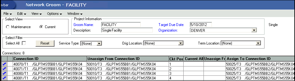

Single-Facility Groom
A single-facility groom is characterized by the following:
  • Lets you groom a facility that has only one parent.
  • A connection is represented by a single row.
  • The Connection ID column displays the connection identification of the connection being maintained.
  • The Unassign From Connection ID column represents the child circuit that will be removed after the groom has been processed, and the Ckt Pos (circuit position) column beside it represents the circuit position on the parent facility from which the groom originates.
  • The Assign To Connection ID column represents the new parent facility, and the Ckt Pos column beside it represents the circuit position.
  • The Service Type Code column represents the service-type code of the circuit.
    Figure 1-1 shows the columns that are displayed in the Network Groom Current View for a single-facility groom.
    Figure 1-1 Single-Facility Groom

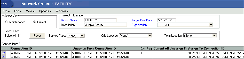

Multiple-Facility Groom
A multiple-facility groom is characterized by the following:
  • Lets you groom a facility that has multiple parents.
  • A connection rides more than one parent facility.
  • A row in the groom workspace represents each assignment. Both rows have the same connection ID as shown in the Connection ID column, but each has its own distinct unassign ID and connection position as shown in the Unassign From Connection ID and Ckt Pos columns, which represent the circuit position and the connection ID of the parent facilities, respectively.
  • Each row may be assigned to a different circuit position and facility.
    Figure 1-2 shows the columns that are displayed in the Network Groom Current View for a multiple-facility groom.
    Figure 1-2 Multiple-Facility Groom
