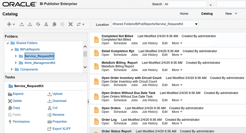

  4. Log in to Oracle Analytics Server.
  5. In the upper right corner of the Home page, click the Catalog link.
    The Catalog appears.
  6. Expand Shared Folders, and select the MSSReports folder.
    The sample reports are located in the MSSReports/Service_RequestKit and MSSReports/Work_ManagementKit folder, as shown in Figure 1-1.
  7. Change the data model file to point it to the data source you created earlier.
    See "Changing the Data Model Source" for instructions.

  21. The sample reports are located in the MSSReports/Service_RequestKit folder, as shown in Figure 1-1.
  22. Change the data model file to point it to the data source you created earlier.
    See Changing the Data Model Source for instructions.

  4. Expand Shared Folders, and select the MSSReports folder.
  5. Click the Open link for the report you want to run.

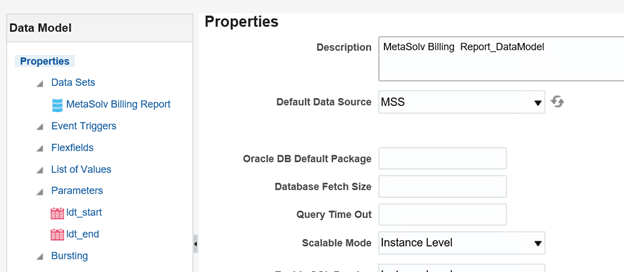

    The Properties page for the selected data model appears.
  7. From the Default Data Source list, select a different data source, as shown in Figure 1-2.

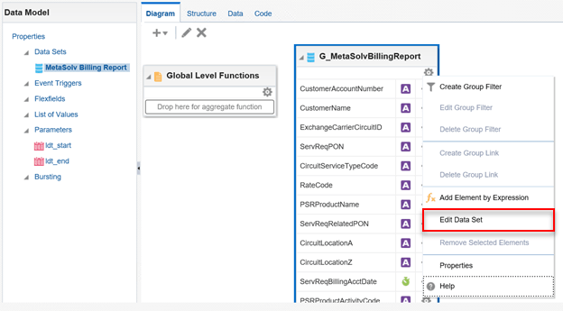

  10. Click the View Actions list menu located in right corner of the data set.
  11. From the View Actions menu, select Edit Data Set, as shown in Figure 1-3.

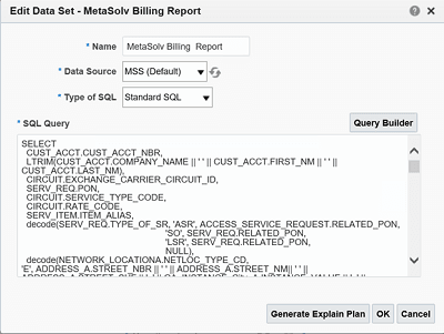

    The Edit Data Set dialog box appears, as shown in Figure 1-4.
    Figure 1-4 Edit Data Set Dialog Box
    Description of Figure 1-4 follows
    Description of "Figure 1-4 Edit Data Set Dialog Box"
  12. Change Data Source.

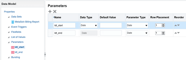

  6. Expand Data Model, and select Parameters.
  7. Select a parameter.
    The Parameters page for the selected parameter appears, as shown in Figure 1-5.
    Figure 1-5 Data Model Parameters Page
    Description of Figure 1-5 follows
    Description of "Figure 1-5 Data Model Parameters Page"
  8. Set or change the value in the Default Value field.
  9. Click the Save icon.

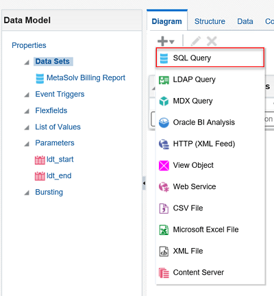

  5. Click the New Data Set list menu and select SQL Query, as shown in Figure 1-6.
    The Create Data Set - SQL dialog box opens.

  8. Click the View Actions list menu located in right corner of the data set.
  9. From the View Actions menu, select Edit Data Set, as shown in Figure 1-7.
    The Edit Data Set dialog box appears, as shown in Figure 1-8.
    Figure 1-8 Edit Data Set Dialog Box
    Description of Figure 1-8 follows
    Description of "Figure 1-8 Edit Data Set Dialog Box"
    Here, you can view the query.
