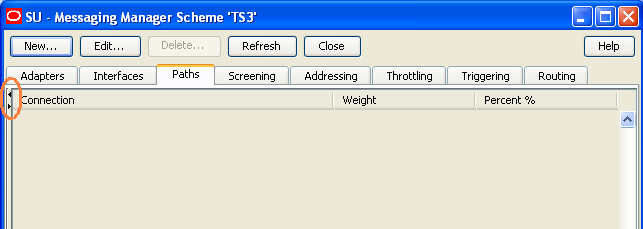

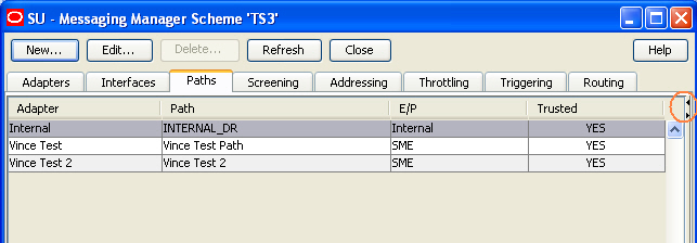

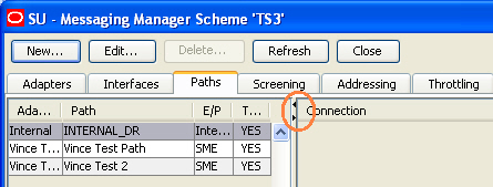

Adjusting panel displays
On the Screening and Paths tabs you can expand or collapse the panels on the screen using the arrows on the horizontal/ vertical bar between the panels.
Description of the illustration mmxmessagemaxschemepathspanelcropview1_4-1-1.jpg
The following describes how to adjust the display:
To Display only the right hand panel:
Click the arrow which points left.
Result: Only the right hand panel is displayed.
Description of the illustration mmxmessagemaxschemepathspanelcropview2_4-1-1.jpg -
To Display both panels when only the right hand panel is displayed
Click the arrow which points right.
To Display only the left hand panel
Result: Only the left hand panel is displayed.
Description of the illustration mmxmessagemaxschemepathspanelcropview3_4-1-1.jpg
Description of the illustration mmxmessagemaxschemepathspanelcropview3_4-1-1.jpg -

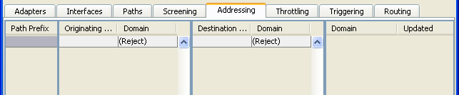

Pre-populated screen areas
The following areas of the Addressing tab will be pre-populated, if you have created a new scheme:
With a default domain:
Description of the illustration mmxmessagemaxschemeaddressingdefaultdomain_4-1-1.jpg -
With no default domain:
Description of the illustration mmxmessagemaxschemeaddressingnodefaultdomain_4-1-1.jpg
The default path prefix is blank, therefore the default address rules will apply to any prefix.
A default rule with a (Reject) domain is created when there is no domain applied.
