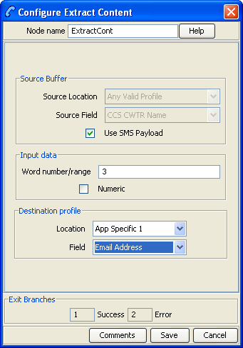

Example
Here is an example of the process, using the Extract Content node to extract the email forwarding address.
Users can enable forwarding by sending an SMS, for example:
Fwd on joe.bloggs@telco.com
The control plan would use the Format Text node to check if it was a valid message.
The Extract Content node is configured as shown below.
Description of the illustration mmxconfigureextractcontent_ex_email_3-3.jpgResult: This node would store the third word (that is, 'joe.bloggs@telco.com') in the user's profile under the 'Email Address' tag.
