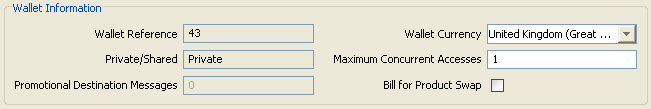

New Wallet fields
This table describes the function of each field.

Adding a distributed wallet
Follow these steps to add a new distributed wallet to a subscriber.
See New Wallet fields for a description of the fields on the New Wallet screen.
In the New Wallet screen, ensure Link To Existing Wallet is not selected.
From the Charging Domain drop down list, select the domain to use for chargeable balances.
This field is populated by the Domain tab. For more information, see Domain.
From the Tracking Domain drop down list, select the VWS domain to use for expense and fraud balances.
If you selected a third party charging domain then in the Wallet Reference field type the external wallet reference.
From the drop down list, select the Product Type that will be associated with this wallet.
This field is populated by the Product Type tab. For more information, see Subscriber Management - Product Type.
From the Display Currency drop down list, select the currency that the Minimum Credit field will be displayed in.
From the Wallet Currency drop down list, select the currency that will be used for monetary values for this wallet.
All available currencies are displayed in this list.
If required, select the Customer from the drop down list who will have access to this wallet.
This field is populated by the Customer tab. For more information, see Customer.
Note: This field will be disabled if a non VWS charging domain is selected.
Select the Limit Type from the drop down list that will be used for this wallet.
If you selected
Limited Postpaidfor the limit type, enter the minimum credit value for this Wallet in the Minimum Credit field.Note: This field will be disabled if a non VWS charging domain is selected.
In the Maximum Concurrent Accesses field, enter the total number of accesses that can be supported against the wallet at any one time.
Click OK to save the new wallet.

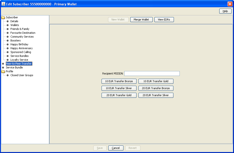

Editing Subscribers
The Edit Subscriber screen allows you to edit subscriber configuration and profile configuration options.
From this screen you can also:
If the NCC EDR auditing feature is enabled, and you update the financial data for a subscriber; for example, by updating their wallets, then you will be required to record the reason for the change when you save the subscriber record. For more information, see About Auditing Changes to Subscriber Data.
Topics:
Edit subscriber screen layout
The configuration and layout for the Edit Subscriber screen is defined in the Subscriber Profile Manager (SPM). When you open the Edit Subscriber screen, the fields and options you see depend on the configuration defined in the SPM for the subscriber's product type and service provider (see following screen example). This means that you may see one of the following:
The default configuration for the Edit Subscriber screen containing all the fields and options available as a standard
A customized Edit Subscriber screen containing a subset of the standard fields and options, plus any subscriber profile groups, fields and zones that have been configured specifically for you. The labels given to the fields and options may also be different from the default labels
You see the available options listed in the menu on the left hand side of the screen. To view or edit the fields for a particular option, select the option in the list.
Note: For information on configuring the Edit Subscriber screen, refer to Subscriber Configuration.

Editing subscriber configuration
Follow these steps to edit the configuration for an existing subscriber.
Note: You can also access the Edit Subscriber screen and edit subscriber configuration from the CCP Dashboard. For details, refer to Customer Care Portal User's Guide.
In the Subscriber Management screen, select the service provider from the Service Provider list.
On the Subscriber tab, search for the subscriber to edit. For details see Finding subscribers.
Select the row in the search results for the subscriber to edit.
Note: If the subscriber has both a primary and a secondary wallet, there will be a row in the search results for each wallet. The wallet type is displayed next to the wallet reference number. Select the row for the wallet type to edit.
Click Edit.
Result: You see the Edit Subscriber screen with the wallet type indicated in the screen title bar.
Edit the subscriber details fields as required. See Editing configuration options.
Edit the subscriber profile options as described in Adding Subscribers.
Edit the wallets for the subscriber as required. See Edit Wallets.
Execute business process logic actions as required. See Execute Business Process Logic.
Perform credit transfers as required. See Perform Credit Transfers.
Click Save.

Wallet Information group
Here is an example Wallet Information group.
Description of the illustration ccseditsubscriberwalletscropinformation_3-1-4.jpg
Related topic
Editing wallet information
Follow these steps to edit the details in the Wallet Information group.
Warning: Although the names of the fields in the group remain the same, the group name will depend on how the Edit Subscriber screen has been configured.
From the left hand menu in the Edit Subscriber screen, select the option containing the Wallet Information group of fields.
In the Wallet Information panel select a different Wallet Currency from the drop down list, if required.
This defines the currency used for monetary values for this Wallet.
If required, enter a new number for the Maximum Concurrent Accesses that can be supported against the subscriber at any one time.
If you have changed the subscriber's product type and you want to charge for this change then select the Bill for Product Swap check box.
Tip: This charge is made when the current subscriber edits are saved. The next time you edit this subscriber this check box will have been cleared.
If you have completed your subscriber edits, click Save.
If EDR auditing is enabled, then the Change Reason dialog displays. Enter the reason for the change in the Change Reason field, and click OK. The reason can be up to 200 characters long.

Performing a credit transfer
Follow these steps to make a credit transfer for a subscriber.
In the Edit Subscriber screen choose the credit transfer option you require from the left hand menu:
To make a peer-to-peer credit transfer, select Peer-to-Peer Transfer.
To make a service bundle credit transfer, select Service Bundle.
Result: You see a series of buttons on the Edit Subscriber screen such as in this example. There is one button for each of the available credit transfer definitions.
Description of the illustration ccseditsubscriberpeer-peertransferppp_3-1-4.jpg -
In the Recipient MSISDN field, enter the CLI for the subscriber who will receive the credit.
Tip: This field is optional. If you do not enter a value, then the current subscriber ID is used.
Click the button for the credit transfer to make.
Result: You see the Confirm Credit Transfer prompt.
If the subscriber has two wallets, then Wallet Type selection will be enabled for the purchaser/recipient. Select the required wallet types for the transfer.
If the Security PIN field is enabled then you must enter the PIN for the purchaser subscriber.
Warning: The PIN must be already configured in the subscriber details.
To save any changes you have made to the subscriber configuration in the Edit Subscriber screens before making the credit transfer, click Save & Execute.
To make the credit transfer without saving changes to the subscriber configuration, click Execute Only.
If you clicked Save & Execute, and EDR auditing is enabled, then the Change Reason dialog displays. Enter the reason for the change in the Change Reason field, and click OK. The reason can be up to 200 characters long.
