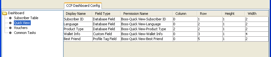

Configuring quick view in SPM
Follow these steps to add the Best Friend profile tag field to the Quick View screen in the SPM.
  1. In the Subscriber Profile Manager screen, select the Service Provider you want from the drop down list.
  2. From the left hand menu on the CCP Dashboard Config tab, select the Quick View option.
    Result: You see the list of fields included in the Quick View default configuration.
  3. Click New.
    Result: You see the New Field for Group - Quick View screen.
  4. From the Field Type drop down list, select Profile Tag Field.
  5. In the Display Name field type Best Friend.
  6. From the Profile Tag Name drop down list, select the Best Friend (LNSTRING) profile tag you added in ACS. See Adding best friend profile tag.
  7. In the Layout Details section, specify the Grid Position for the field. Set the:
    • Column to 0
    • Row to the next available row number
    • Width to 2
    • Height to 1
  8. Click Save.

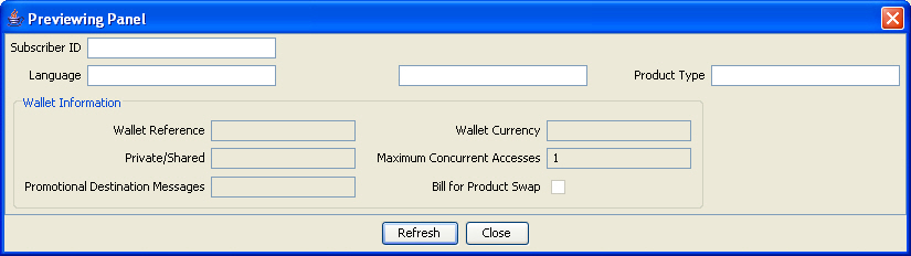

Follow these steps to adjust the Quick View screen layout to put the Best Friend and Product Type fields on the same row.
  1. Select the Quick View option on the CCP Dashboard Config tab.
  2. Click Preview.
    Result: You see the Previewing Panel screen for Quick View.
  3. Leaving the Previewing Panel open, on the CCP Dashboard Config tab, select the Best Friend field in Quick View grid and click Edit.
    Result: You see the Editing Field from Group - Quick View screen.
  4. Edit the Grid Position. Set the:
    • Column to 1
    • Row to 2.
  5. Click Save.
  6. In the Previewing Panel screen, click Refresh.
    Result: You see the updated Quick View layout.
    Description of spmpreviewingpanelquickviewex2-1-0.jpg follows
    Note: In this example, the Best Friend field is displayed without a label. This is because it needs 2 columns to display the label and the data entry box, and there is only 1 column available between the Language and Product Type fields.

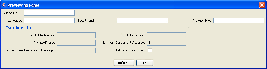

  7. To improve the screen layout, edit the Wallet Information Panel Grid Position as above. Set the:
    Width to 4.
  8. Edit the Product Type field Grid Position as above. Set the:
    Column to 4.
  9. Edit the Best Friend field Grid Position as above. Set the:
    Column to 2.
  10. In the Previewing Panel screen, click Refresh.
    Description of spmpreviewingpanelquickviewex3-1-0.jpg follows

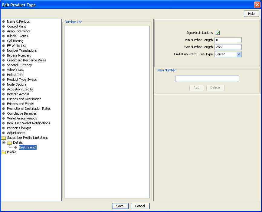

Product Type Limitations
You set the limitations for the Best Friend numbers by Product Type. For example, you can set the minimum length allowed for the Best Friend number.
Configuring product type limitations
Follow these steps to configure the Product Type limitations for the Best Friend number.
  1. Open the Subscriber Management screen.
  2. From the Service Provider drop down list, select the Service Provider.
  3. On the Product Type tab, select the Best Friend Product Type you added previously and click Edit.
    Result: You see the Edit Product Type screen.
  4. From the left hand menu, open the Subscriber Profile Limitations group that includes the Best Friend option.
  5. Select Best Friend.
    Result: You see the Best Friend configuration options in the Edit Product Type screen, such as in this example.
    Description of cmaxeditproducttypebestfriendprofilefieldlimitations-4-0.jpg follows
    Description of the illustration cmaxeditproducttypebestfriendprofilefieldlimitations-4-0.jpg
  6. Specify Best Friend number limitations and click Save.
