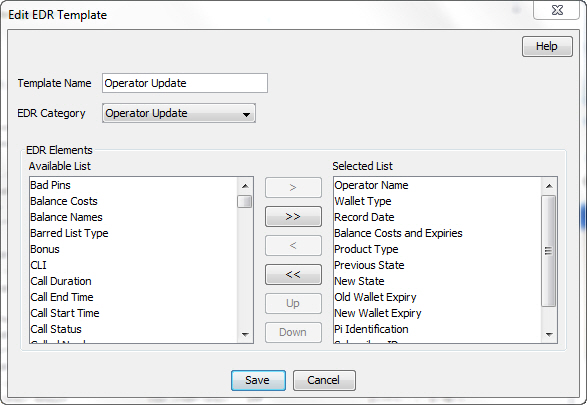

EDR Templates
This screen enables you to add, modify or delete EDR templates. EDR templates are used on the EDR Details for Subscriber screen to display the information in the EDR.
Note: The standard CCS EDR templates are configured on installation.
Adding EDR templates
Follow these steps to add a new EDR template.
  1. In the EDR Management screen, select the service provider from the Service Provider List.
  2. On EDR Templates tab, click New.
    Result: The New EDR Template screen is displayed.
  3. In the Template Name field, type a unique name for this template.
  4. From the EDR Category list, select the category EDRs with this template should be associated with.
  5. From the Available List field, select an EDR element you want to display in this template and click >.
    Note: To use all the EDR elements in the Available List, click >>.
  6. The display order of the elements in the Selected List is used to set the order in which the fields appear in the View EDRs for Subscriber screen.
    To change the display order for an element in the Selected List, select the element you want to move, and click the Up or Down button.
  7. Click Save.

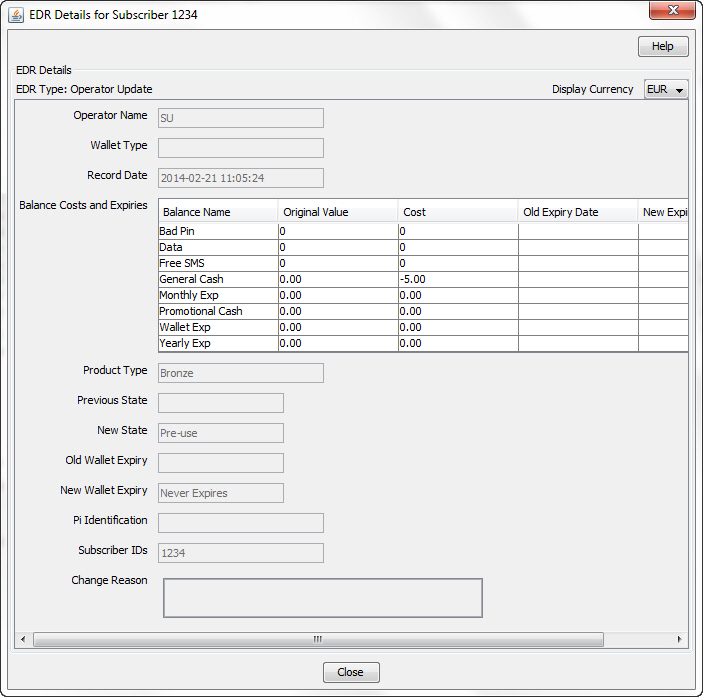

Example EDR template
These two screens show an EDR template, and the EDR Details screen using that EDR template.
Description of ccseditedrtemplate-502.jpg follows
Description of ccsviewedrdetails-502.jpg follows

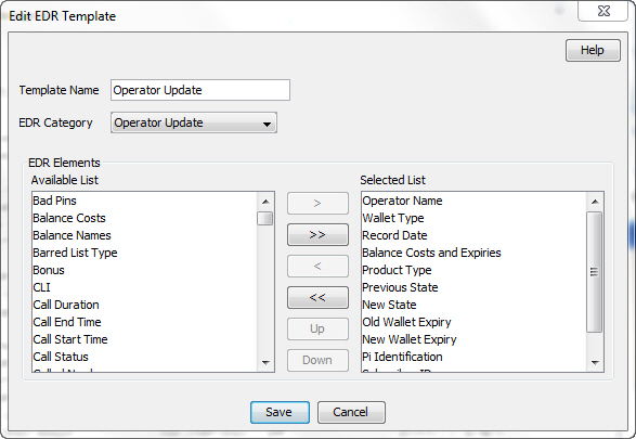

Editing EDR templates
Follow these steps to edit an existing EDR template.
  1. In the EDR Management screen, select the Service Provider from the drop down box.
  2. On the EDR Templates tab, select the EDR template you want to edit.
  3. Click Edit.
    Result: You see the Edit EDR Template screen.
  4. Edit the details as described in Adding EDR templates.
  5. If you want to remove any EDR elements from this EDR template, select it from the Selected List and click <.
    Note: To remove all EDR elements from the list, click <<.
  6. Click Save.

  4. The display order of the elements in the Selected List is used to set the order in which the fields appear in the EDR Viewer.
  5. Click Save.
