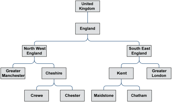

Rate tables are used to map currency to a geography set and a holiday set.
  • Geography set: an ACS reusable resource set, defining the set of geographies. Each single Geography is based on an E.164 number range.
  • Holiday set: an ACS reusable resource set, representing the calendar of predefined annual holidays.

Deriving a CLI-DN Tariff for a Call
The CLI-DN tariff for a call is always chosen according to the closest matching link across a geography set. The system searches for:
  1. a direct link first, then
  2. looks for the nearest available link if a direct link is not available.
If no link between the two points is recognized, the call is disconnected. Location is based on the CC Calling Network Address tag from the call context profile.
Example: This diagram demonstrates the algorithm for obtaining the tariff. For simplicity’s sake, all calling significant entries are on the left of England and all destination significant entries are on the right.
Description of ccscli-dntariffd1-2-3-3.jpg follows
Calling number X destination number
The following table shows the links that are available for mapping calls.
Calling Number Destination Number
North West England Maidstone
North West England Kent
Cheshire Greater London
Cheshire South East England
Chester South East England
Destination geography map
The following table shows the links mapping DN (Destination Numbers).
Significant_Entry Lowest_Entry Level Usage
Greater London Greater London 3 1
Kent Chatham 3 1
Kent Maidstone 3 1
Maidstone Maidstone 4 1
South East England Chatham 2 2
South East England Greater London 2 2
South East England Maidstone 2 2
Calling geography map
The following table shows the links mapping CLI (Calling Line Identifiers).
Cheshire Chester 3 2
Cheshire Crewe 3 2
Chester Chester 4 1
North West England Chester 2 2
North West England Crewe 2 2
North West England Greater Manchester 2 2
First attempt
A call made from Crewe to Maidstone does not have a direct link mapped. Failing to find a link to Maidstone, the system will search for the most direct link. An attempt is made at each location along the same branch as Maidstone. The DNs on the Maidstone branch of the geography tree are Kent and South East England. There are no direct links from Crewe to either of these destinations.
DN significant entry
The following table shows the destination significant entries on the geography tree. A destination significant entry is a destination or the parent entry of a destination, or any parent entry of any destination significant entry.
Destination Significant Entry Level
Maidstone 4
Kent 3
South-East England 2
Second attempt
The system then searches from the next CLI along the same branch as Crewe, in an attempt to make a direct link.
The CLIs on the Crewe branch of the geography tree are Cheshire and North West England. There is no direct link from Cheshire to Kent, but there is a link from Cheshire to South East England (see Destination geography map). There is then no need to search for any links from North West England. The system will charge the call using Cheshire to South East England as the CLI-DN Tariff.
CLI significant entry
The following table shows the calling significant entries on the geography tree. A calling significant entry is a CLI (calling location) or the parent entry of a CLI, or any parent entry of any calling significant entry.
Calling Significant Entry Level
Cheshire 3
North West England 2
