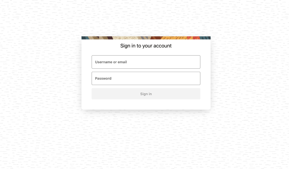

8.1 OCNWDAF Login
Log in to the OCNWDAF Graphical User Interface (GUI) using valid credentials. The OCNWDAF supports three kinds of users listed below:
- Network Operator
- Network Architect
- Network Capacity Planner
The Network Architect and Network Capacity Planner have access to the Configuration screen to add new slices, manage existing slices, modify slice settings and access geographical settings to create new regions.
Enter the Username and Password, and click Sign in to log in to the OCNWDAF application.
Figure 8-1 Login

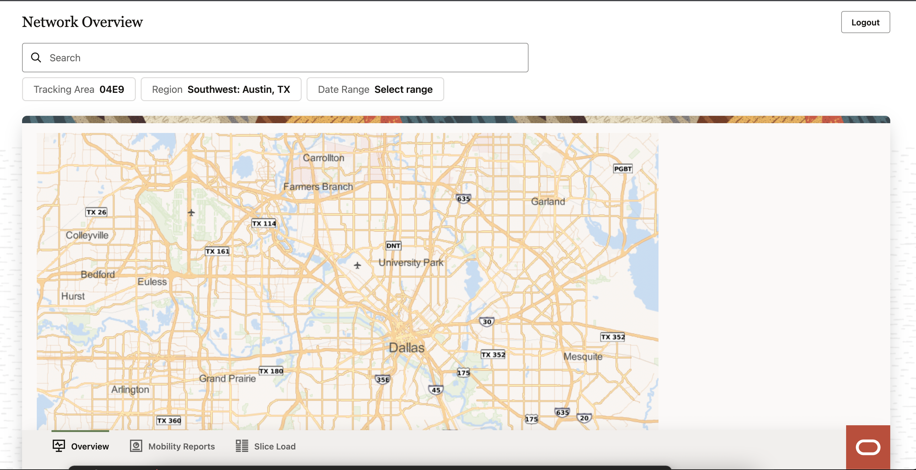

8.2 Network Overview Screen
The Network Overview displays the overview of the network and allows the user to perform the following actions:
- Search: A search bar is available with option to select the following filters:
- Tracking Area
- Region
- Date Range
- Logout
- Generate Mobility Reports
- Obtain Slice Load analytics
- Access to the Configuration screen (only if the user is a Network Planner or Network Architect).
The following Network Overview screen is visible to the Network Operator:
Figure 8-2 Network Overview Screen

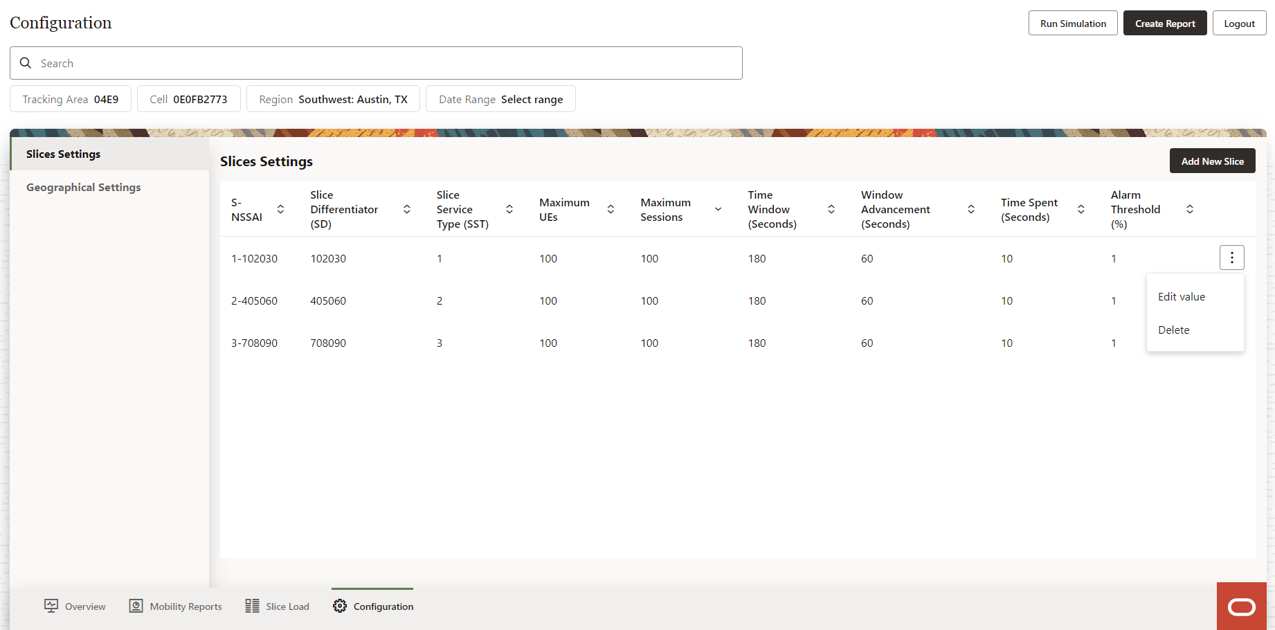

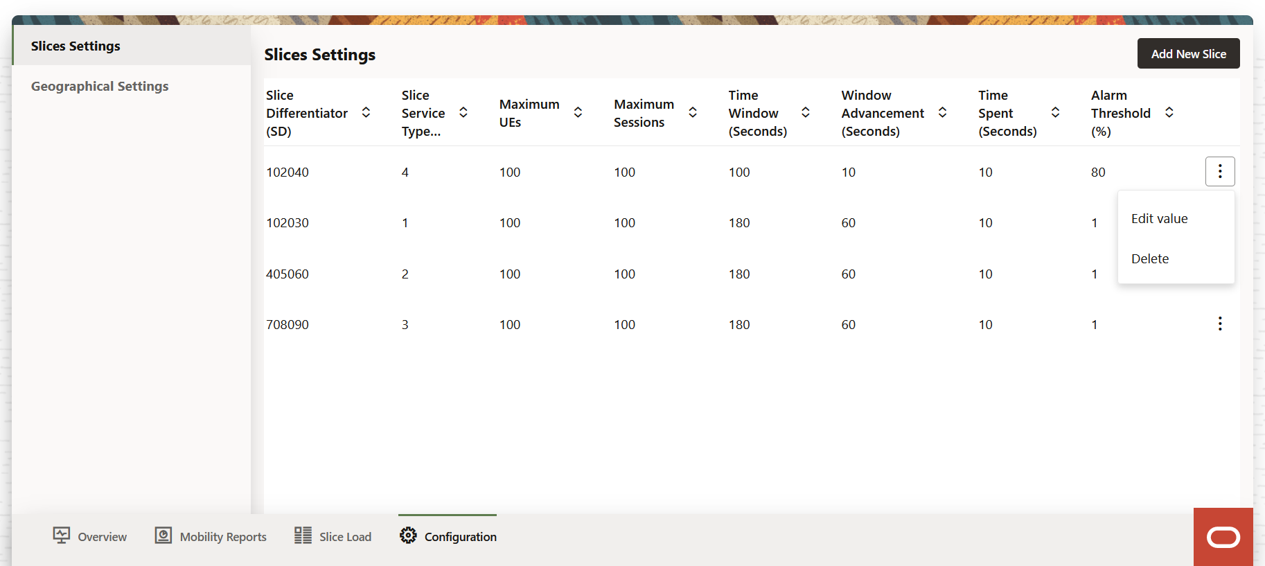

8.3.1 Slice Setting Screen
The Configuration screen displays the Slice Settings option. The user can perform the following actions on the Slice Settings screen:
- Add New Slice
- View the configured slices and the following slice parameters:
- S-NSSAI
- Slice Differentiator (SD)
- Slice Service Type (SST)
- Maximum UEs
- Maximum Sessions
- Time Window (Seconds)
- Window Advancement (Seconds)
- Time Spent (Seconds)
- Alarm Threshold (%)
- Modify existing slice information using the Edit Value button. This button appears as a pop up on clicking the three dot menu option on the right side of each configured slice listed on the screen.
- Delete an existing slice, using the Delete button. This button appears as a pop up on clicking the three dot menu option on the right side of each configured slice listed on the screen.
The Slice Settings screen is displayed below:
Figure 8-4 Slice Settings

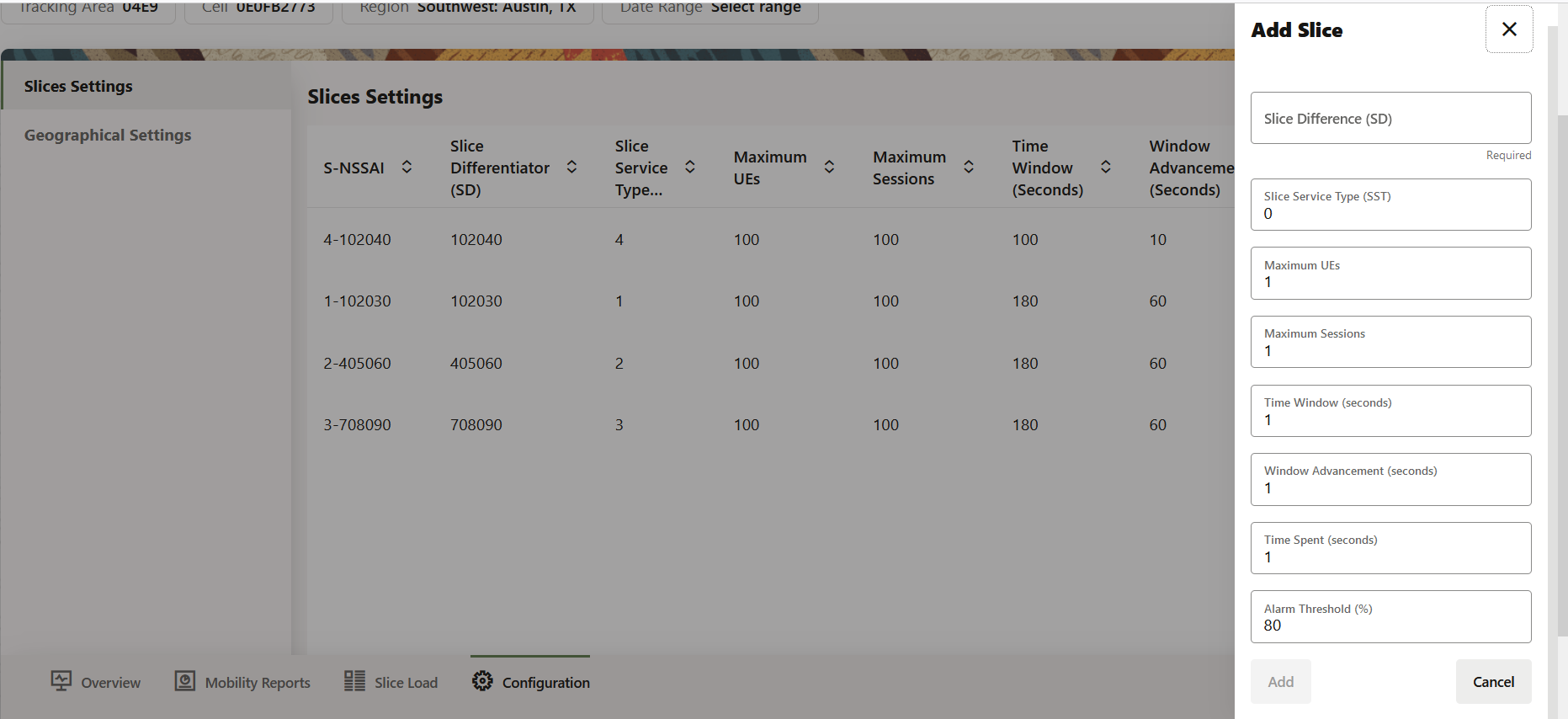

8.3.1.1 Add a New Slice
To add a new slice, click Add New Slice button in the Slice Settings screen. A form with the fields to add a new slice "Add Slice", appears on the right side of the screen:
Figure 8-5 Add Slice
Provide the following information to create a new slice:
Table 8-1 New Slice
| Parameter | Type | Description |
| Slice Difference (SD) | String | Is a 3-octet hexadecimal number to identify different slices of the same type. |
| Slice Service Type (SST) | Unsigned integer | Value: 0 up to 127 is standardized, and 128 up to 255 is operator specific. |
| Maximum UEs | Integer | The maximum number of user equipments allowed in the slice. |
| Maximum Sessions | Integer | The maximum number of sessions allowed in the slice. |
| Time Window | Seconds | Threshold detection window time. Default: 5 minutes. |
| Window Advancement | Seconds | Threshold detection window advancement. Default: 15 seconds. |
| Time Spent | Seconds | Time spent in window opposite accepted state. Default: 80% . |
| Alarm Threshold | Percentage | Indicates the value of the Alarm Threshold. |
Click the Add button after entering all the fields to create a new slice. The new slice will be listed in the Slice Settings screen.

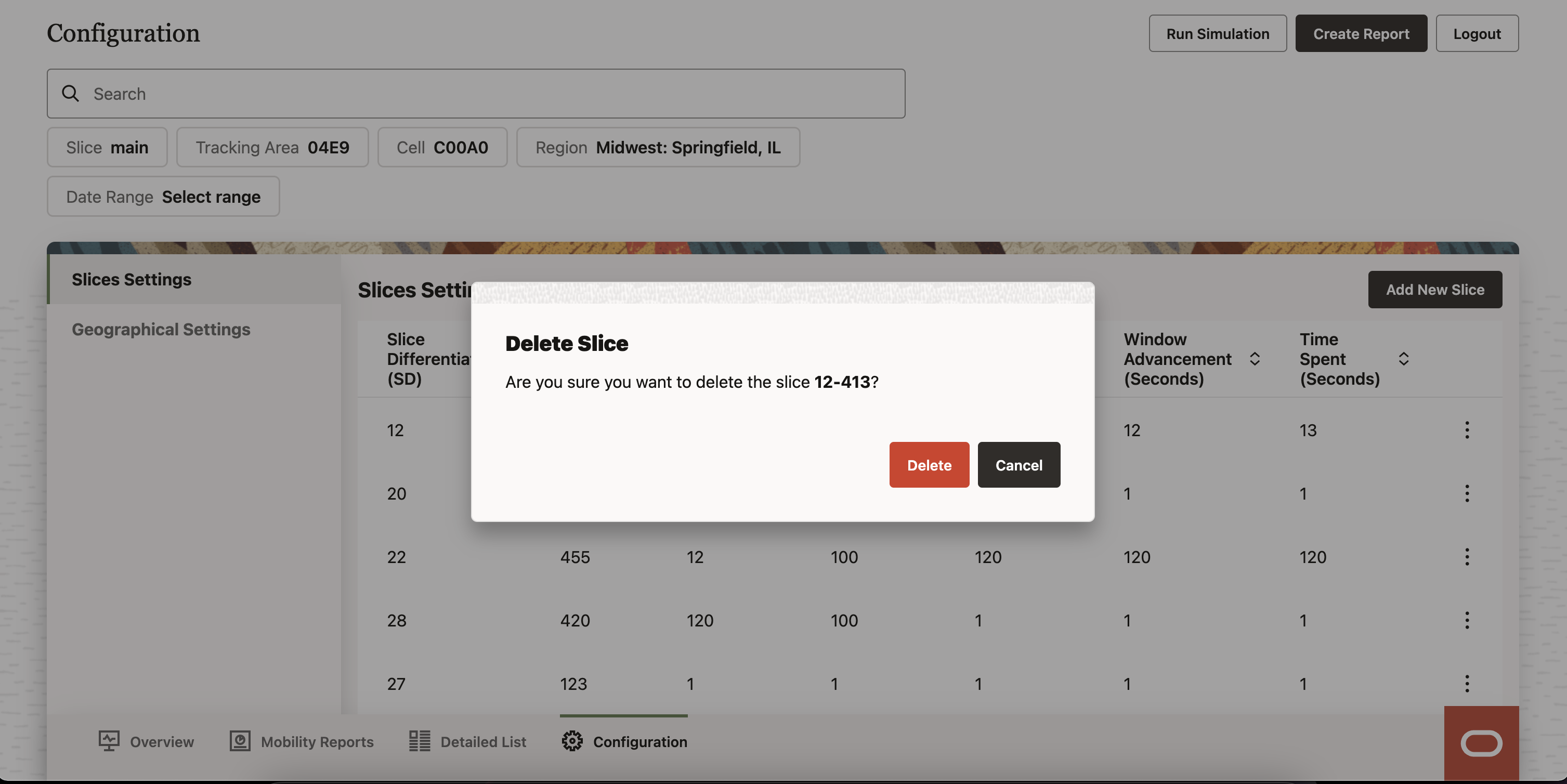

8.3.1.2 Delete a Slice
To delete a slice, click the three dot menu button on the right side of the slice to be deleted. A pop up appears which has an option to Delete slice.
Figure 8-6 Delete
Click Delete, a Delete Slice confirmation dialog box appears on the screen. Click Delete to confirm deletion or Cancel to cancel slice deletion.

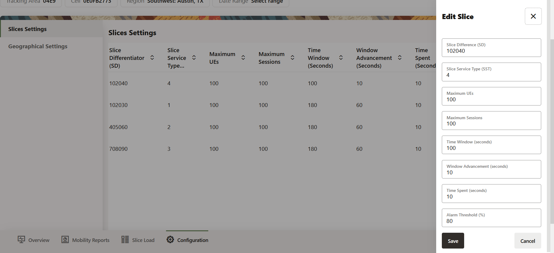

8.3.1.3 Edit an Existing Slice
To edit a slice, click dotted menu button on the right side of the slice to be edited. Click the Edit value option that appears as a pop up on the screen.
Figure 8-9 Edit value
The Edit Slice form appears on the right side of the screen.
Figure 8-10 Edit Slice
Modify the required fields to edit the slice. Click Save to apply the changes to the slice.

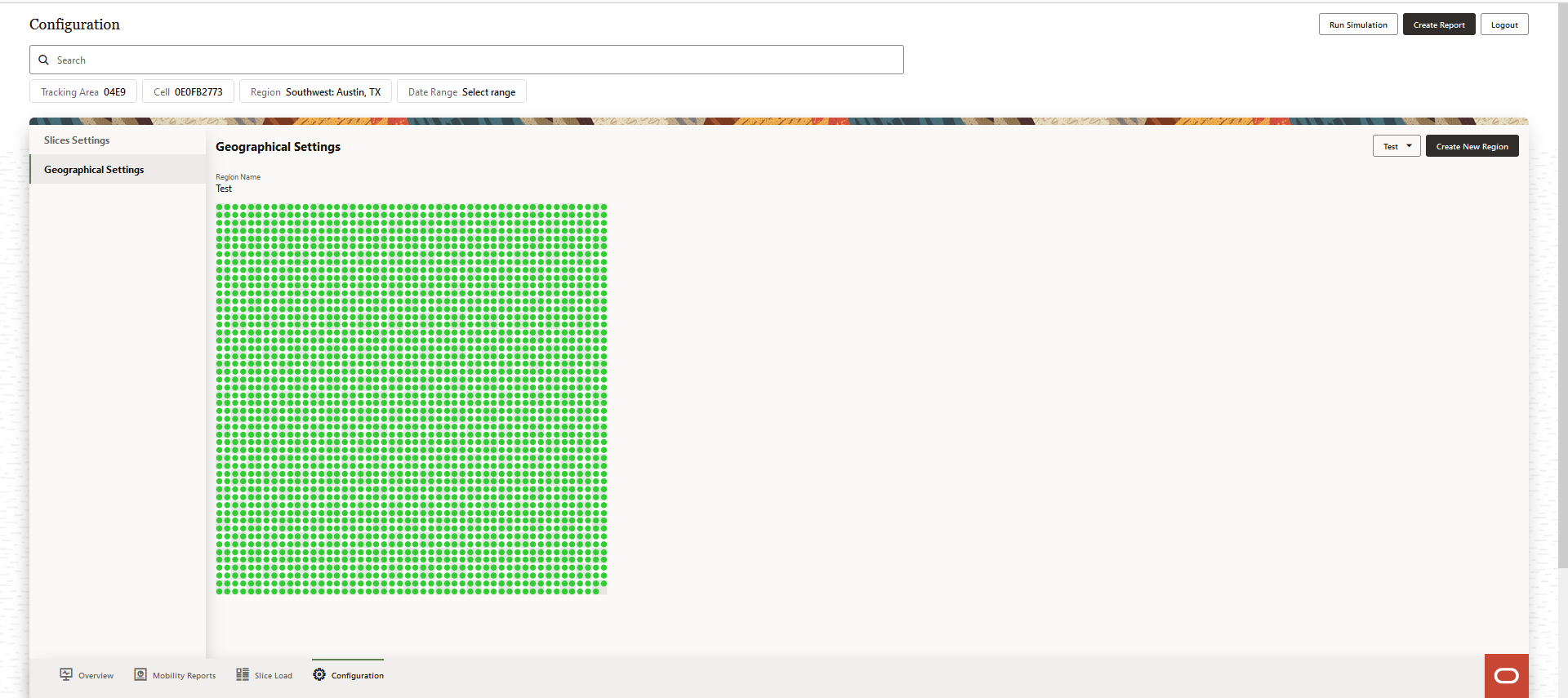

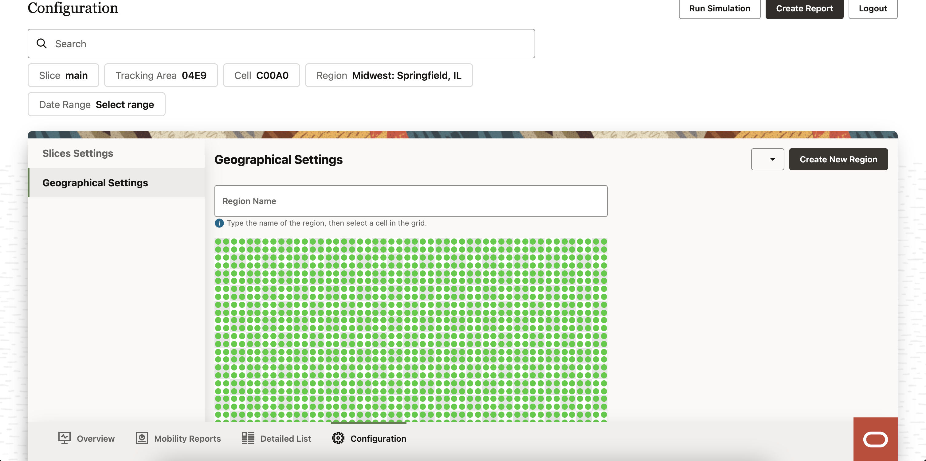

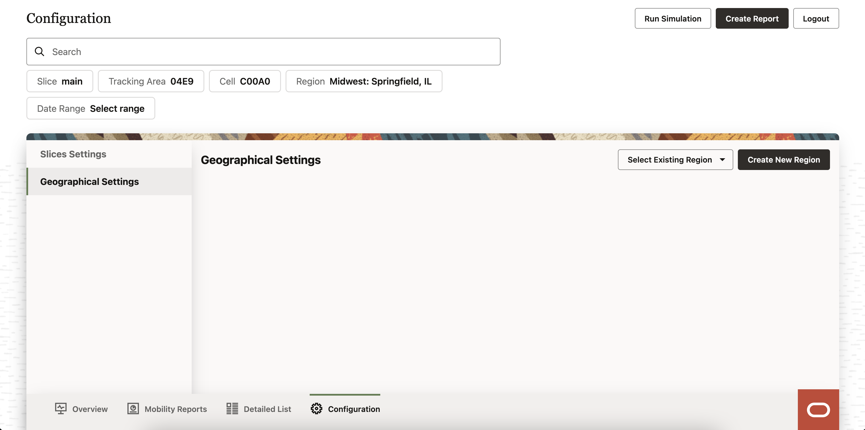

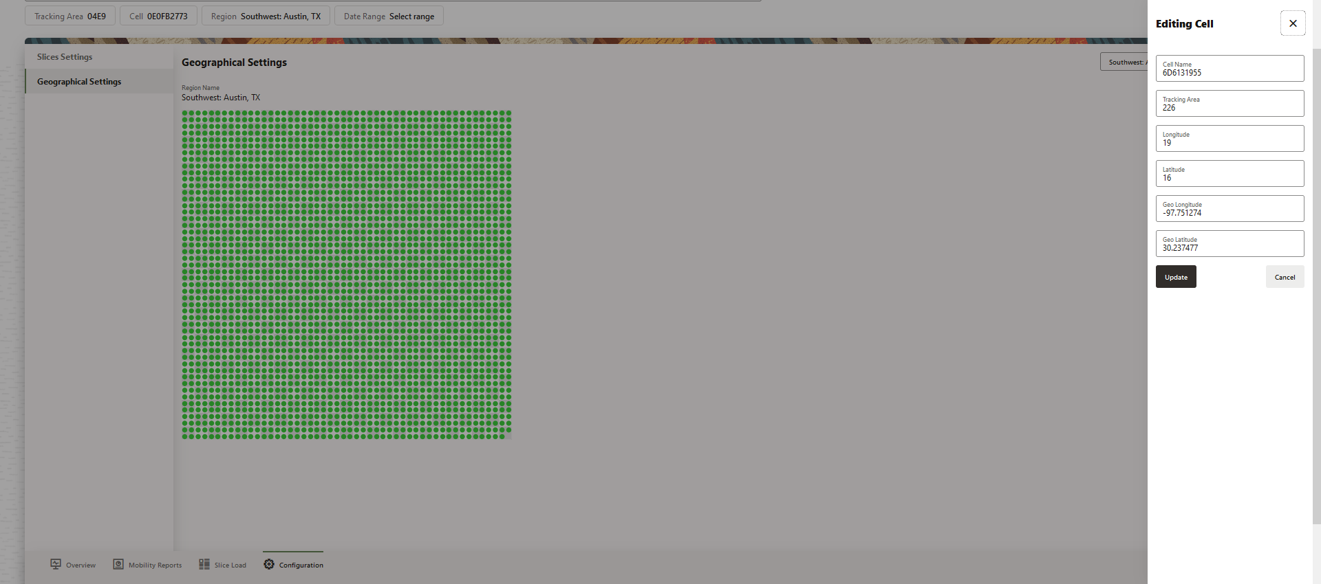

8.3.2 Geographical Settings
The Configuration screen displays the Geographical Settings option. Click on the Geographical Settings option on the left side of the screen. The Geographical Settings screen appears.
Figure 8-11 Geographical Settings
Use this screen to Select Existing Region or Create New Region.
8.3.2.1 Create New Region
Click Create New Region to create a new region.
Figure 8-12 Create New Region
- Provide a Region Name, and then select the cell in the grid.
- The Editing Cell screen displays on the right side of the screen to update the region information. Provide the following details:
- Cell Name
- Tracking Area
- Longitude
- Latitude
- Geo Longitude
- Geo Latitude
- Click Update to save the changes.
- Click Cancel to discard the changes.
Figure 8-13 New Region Parameters
The New Region appears in the Regions drop down list.
Figure 8-14 New Region

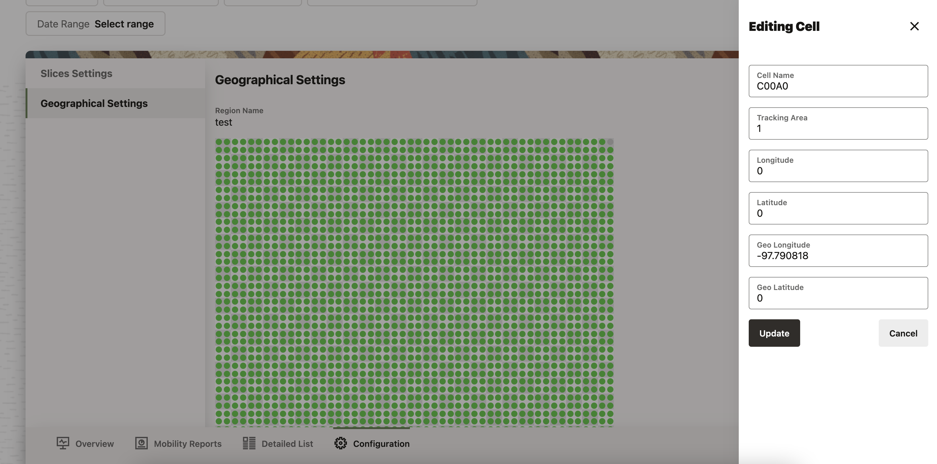

8.3.2.2 Select Existing Region and Edit Cells
The Geographical Settings screen has an option to Select Existing Region. To visualize an existing region, click Select Existing Region drop down and select the desired region from the displayed list.
A grid of cells in the selected region are displayed:
Figure 8-15 Existing Region
Select cell that you want to edit and the Editing Cell form appears on the right side of the screen:
Figure 8-16 Edit Cell
The following fields can be edited:
- Cell Name
- Tracking Area
- Longitude
- Latitude
- Geo Longitude
- Geo Latitude
Click Update to save the changes or Cancel to discard the changes.

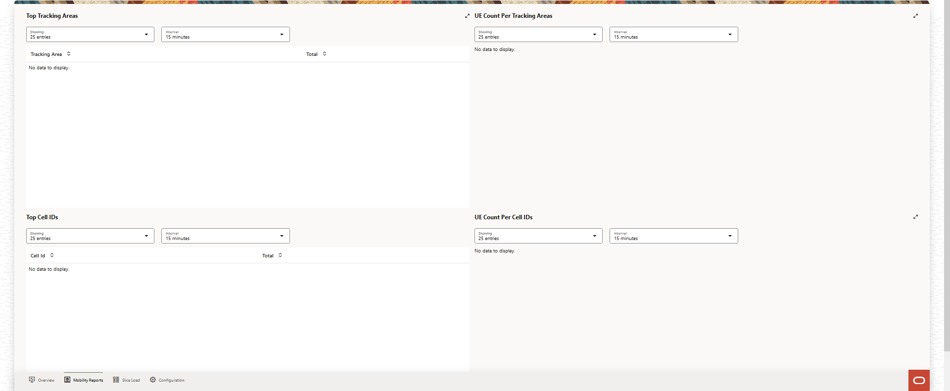

8.4 Mobility Reports
After successful login, the Network Overview screen is displayed. Click the Mobility Reports button, and the Mobility Reports screen appears.
Figure 8-17 Mobility Reports
- Top Tracking Areas
- UE Count Per Tracking Areas
- Top Cell IDs
- UE Count Per Cell IDs

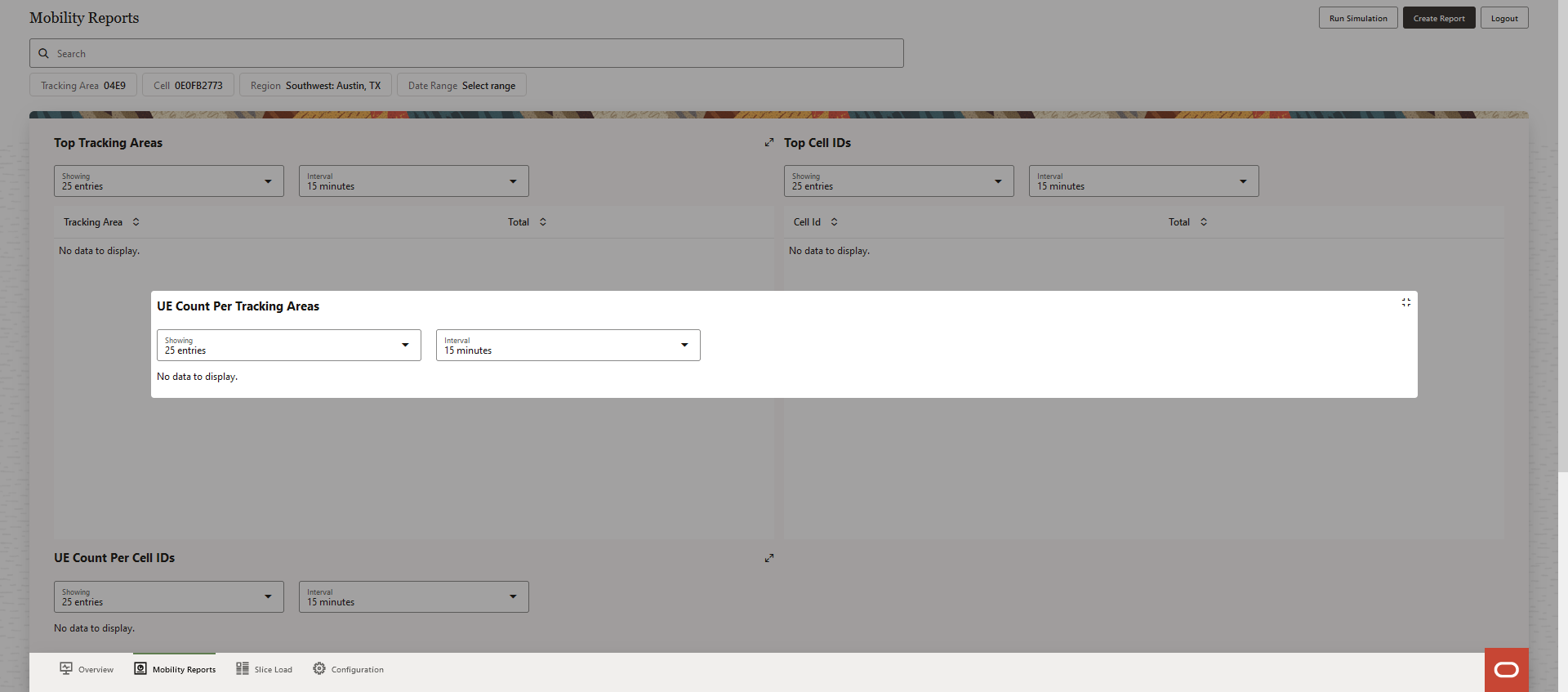

Displays the UE Count Per Tracking Areas. Drop down options are available to select number of entries to be displayed and the time interval. Select Showing, to select the number of entries to be displayed, the available options are 10 entries, 25 entries, and 50 entries. Select the Interval, the available options are 5 minutes, 15 minutes, 30 minutes and 60 minutes.
User has an option to obtain an expanded view of the UE Count Per Tracking Areas. Click the option to expand the view, the UE Count Per Tracking Areas appears as a pop up on the screen.
Figure 8-19 UE Count Per Tracking Areas

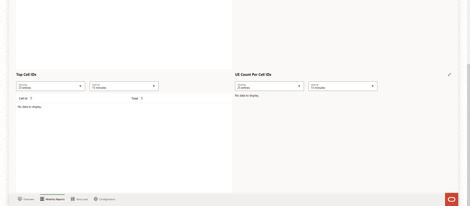

Top Cell IDs
Displays the Top Cell IDs. Drop down options are available to select number of entries to be displayed and the time interval. Select Showing, to select the number of entries to be displayed, the available options are 10 entries, 25 entries, and 50 entries. Select the Interval, the available options are 5 minutes, 15 minutes, 30 minutes and 60 minutes.
The Cell Id and the Total are displayed based on the number of entries and interval selected in the drop down list.
User has an option to obtain an expanded view of the Top Cell IDs. Click the option to expand the view, the Top Cell IDs appears as a pop up on the screen.
Figure 8-20 Top Cell IDs

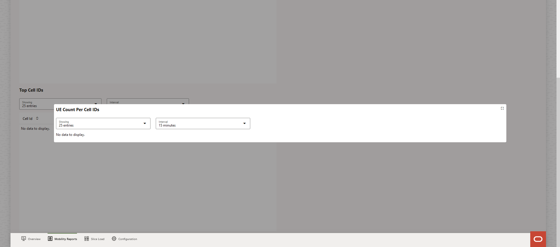

Displays the UE Count Per Cell IDs. Drop down options are available to select number of entries to be displayed and the time interval. Select Showing, to select the number of entries to be displayed, the available options are 10 entries, 25 entries, and 50 entries. Select the Interval, the available options are 5 minutes, 15 minutes, 30 minutes and 60 minutes.
User has an option to obtain an expanded view of the UE Count Per Cell IDs. Click the option to expand the view, the UE Count Per Cell IDs appears as a pop up on the screen.
Figure 8-21 UE Count Per Cell IDs

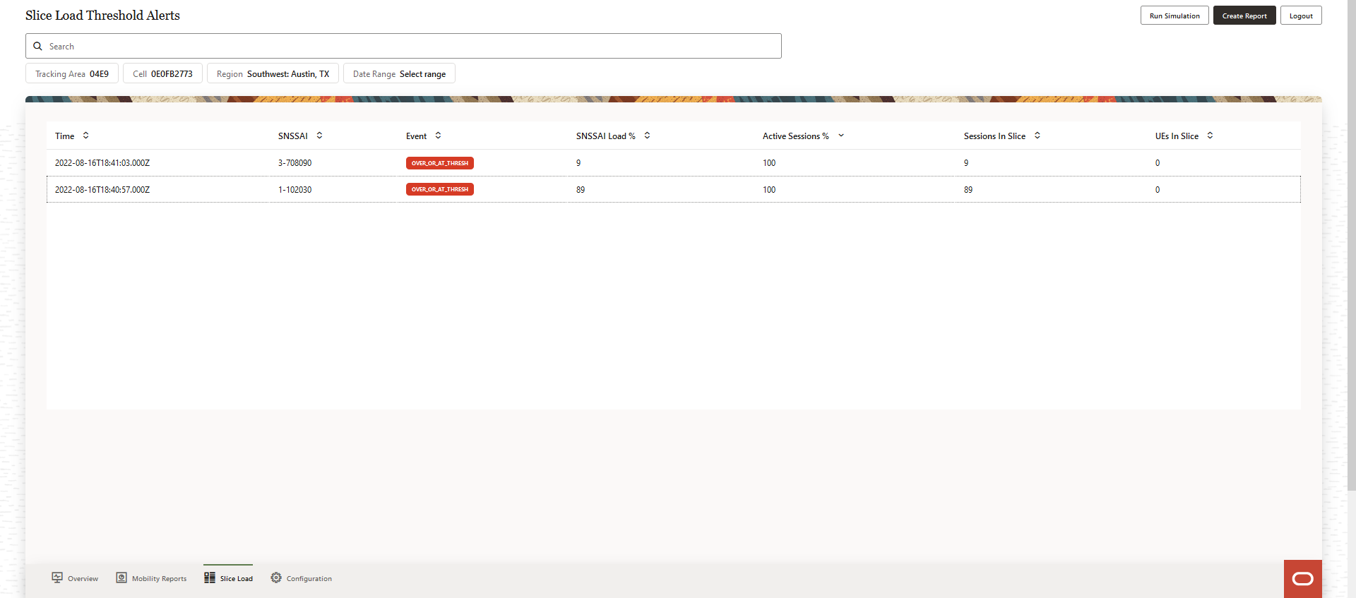

8.5 Slice Load Threshold Alerts
After successful login, the Network Overview screen is displayed. Click the Slice Load button, and the Slice Load Threshold Alerts screen appears.
- Time
- SNSSAI
- Event
- SNSSAI Load %
- Active Sessions %
- Sessions In Slice
- UEs In Slice
Figure 8-22 Slice Load Threshold Alerts
