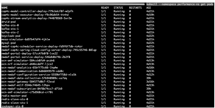

7.4.7 Microservice Deployment Issue
Follow the procedure below to resolve microservice deployment issue:
  1. Run the following command to obtain information on the pods deployed and their status:
    kubectl --namespace [namespace name] get pods --sort-by='.status.containerStatuses[0].restartCount'
    Sample Output:
    Figure 7-1 Sample Output
    Sample Output
  2. Observe the Restarts column, the ideal value is "0", indicating the pods have not re-started. If the column Status is not Running and the value of the Restarts is constantly increasing implies an underlying problem with the microservice or any dependency.
  3. Refer to the Oracle Communications Networks Data Analytics Troubleshooting Guide to resolve the issue.
  4. If required, re-deploy the microservice.
In a Kubernetes setup, at least one pod of each microservice must be deployed so, if the problem root cause is due to a dependency, re-deploying the microservice is not required. It is sufficient to fix the dependency and wait for Kubernetes to retry the deployment.
If there are any changes in the Spring Cloud Config properties of the microservice, refreshing the property through its actuator with a POST request to http://{host}:{port}/actuator/refresh. If the issue is not resolved (not all properties support online refresh), redeploy the microservice.
