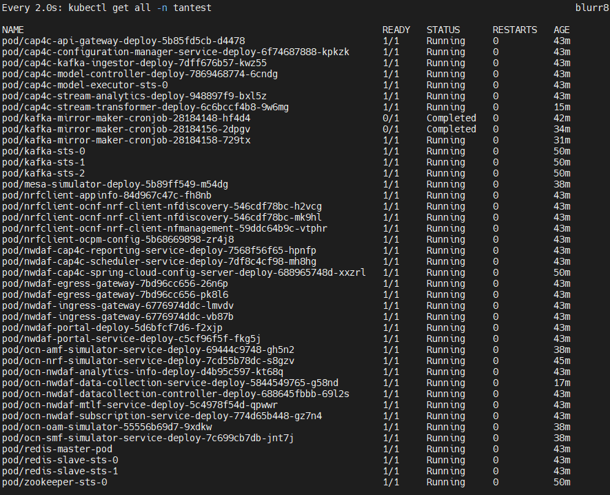

  7. Verify if the Mirror Maker is running, run the following command:
    kubectl get all -n $K8_NAMESPACE
    Sample output for a two-site deployment:
    kafka-a-sts-0                   1/1     Running   0          6d22h
    kafka-a-sts-1                   1/1     Running   0          6d22h
    kafka-b-sts-0                   1/1     Running   0          6d22h
    kafka-b-sts-1                   1/1     Running   0          6d22h
    nwdaf-data-replication-sts-0    1/1     Running   0          6d22h
    zookeeper-a-sts-0               1/1     Running   0          6d22h
    zookeeper-b-sts-0               1/1     Running   0          6d22h

    Run the following command to view all the resources present in the namespace:
    For example:
    [cloud-user@occne224-cluster-bastion-1 ~]$ kubectl get all -n $K8_NAMESPACE
    NAME                                   READY   STATUS              RESTARTS   AGE
    pod/ocn-nwdaf-db-creation-hook-jj9mx   0/1     ContainerCreating   0          15s
    NAME                                   COMPLETIONS   DURATION   AGE
    job.batch/ocn-nwdaf-db-creation-hook   0/1           15s        15s
    Sample output when the installation completes:
    [cloud-user@occne224-cluster-bastion-1 ]$ helm install nwdaf helmChart/ -n $K8_NAMESPACE --timeout 30m
    W0404 04:44:48.456730 3847781 warnings.go:70] autoscaling/v2beta2 HorizontalPodAutoscaler is deprecated in v1.23+, unavain v1.26+; use autoscaling/v2 HorizontalPodAutoscaler
    W0404 04:44:48.459573 3847781 warnings.go:70] autoscaling/v2beta2 HorizontalPodAutoscaler is deprecated in v1.23+, unavain v1.26+; use autoscaling/v2 HorizontalPodAutoscaler
    W0404 04:51:41.957767 3847781 warnings.go:70] autoscaling/v2beta2 HorizontalPodAutoscaler is deprecated in v1.23+, unavain v1.26+; use autoscaling/v2 HorizontalPodAutoscaler
    W0404 04:51:41.963127 3847781 warnings.go:70] autoscaling/v2beta2 HorizontalPodAutoscaler is deprecated in v1.23+, unavain v1.26+; use autoscaling/v2 HorizontalPodAutoscaler
    LAST DEPLOYED: Tue Apr  4 04:44:47 2023
    NAMESPACE: nwdaf-test
    STATUS: deployed
    REVISION: 1
    TEST SUITE: None
    Verify if all the dependencies are in Running state (if any pod is not in Running state wait for a maximum of five restarts).
    Sample output:

  2. Run the following command to verify if the pods are up and active:
    kubectl get pods -n <namespace>
    Where,
    <namespace> is the namespace of OCNWDAF deployment.
    The STATUS column of all the pods must be 'Running'.
    The READY column of all the pods must be n/n, where n is the number of containers in the pod.

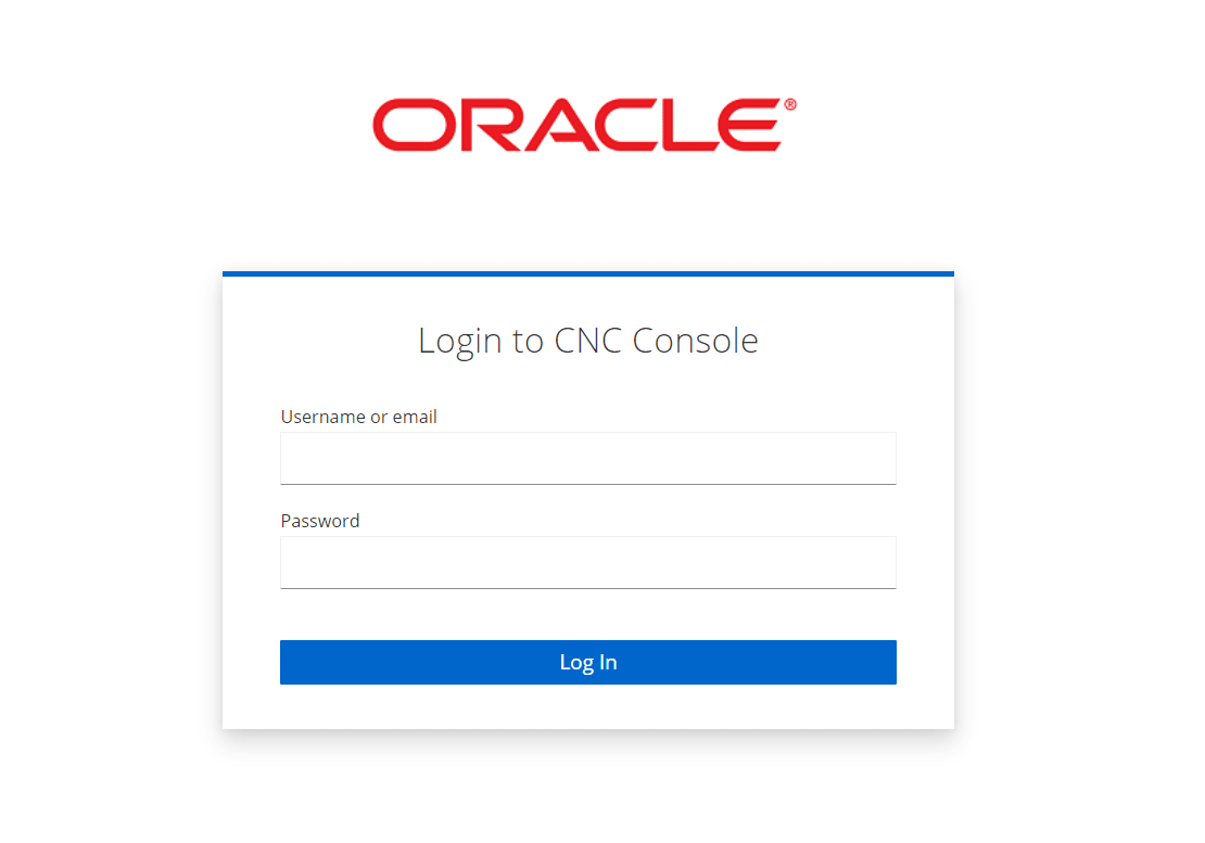

  12. Login to the CNC Console.
    Provide the Username and Password.
    Figure 2-4 Login
    Login
    Click Login.

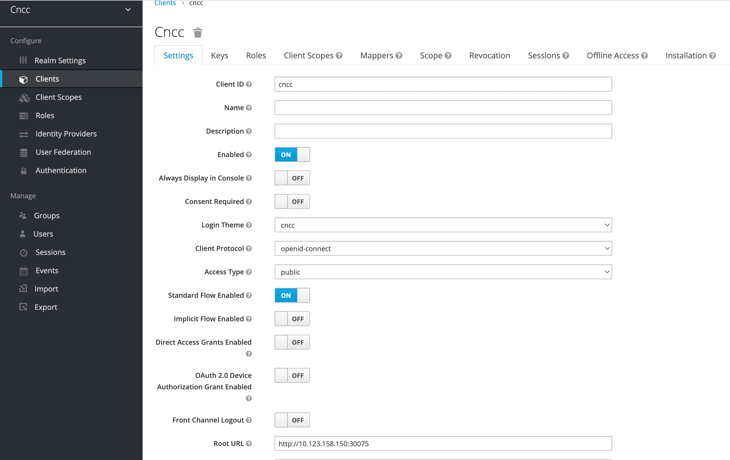

  1. Login to the CNC Console
  2. Click Clients option, In the Settings tab update the Root URL field with the IP on which CNC Console is running and the port defined on mcore-ingress-gateway service.
    Figure 2-5 Clients
    Clients
    Click Save

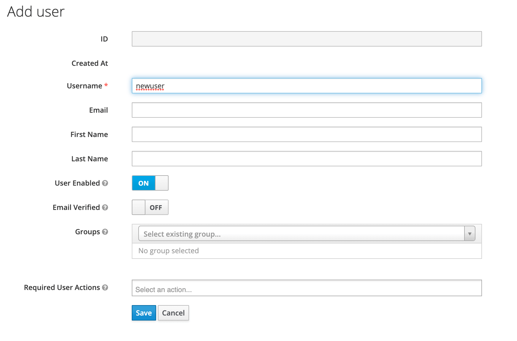

  3. To add new user, click Users and click Add User. Provide a Username and fill the form. Click Save.
    Figure 2-6 Add User
    Add User

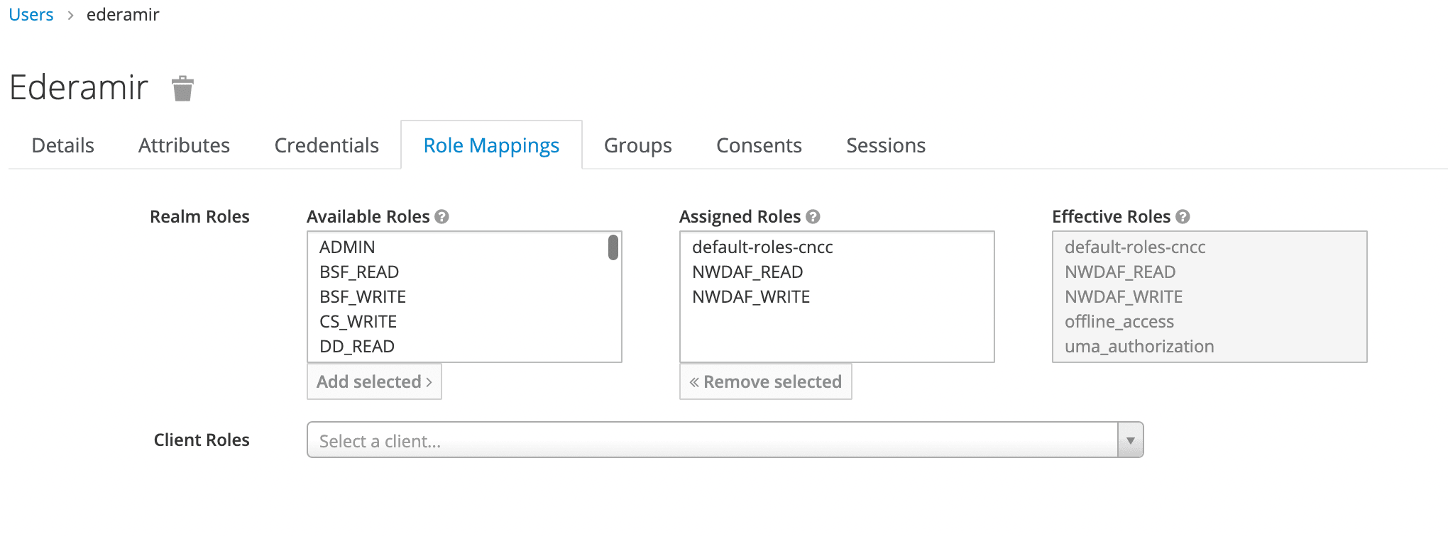

  4. Click Users, select the newly added user, go to the Role Mappings tab.
    For example:
    Figure 2-7 Role Mapping
    Role Mapping
    Add NWDAF_READ and NWDAF_WRITE to the Assigned Roles.

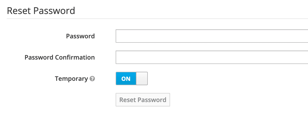

  5. Use the Reset Password screen to create a new password for the user.
    Figure 2-8 Reset Password
    Reset Password
