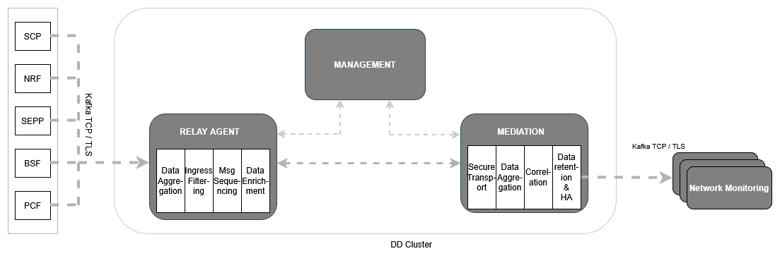

2.1.3.1.1 Model 1: OCNADD Management Group Services, Relay Agent Group Services and Mediation Group Services in Same Cluster
This OCNADD deployment model includes all the services deployed in the same cluster. For each OCNADD group, separate namespaces must be created during the deployment. In this deployment option, all the features are available. This is the default model, and the required services are enabled by default in each OCNADD group custom values file (ocnadd-<ocnadd-group>-custom-values-25.2.200.yaml).
In this deployment model, the default Kafka storage options are as follows:
  • Relay agent Kafka is enabled with the Volatile (RAM Drive) storage option.
  • Mediation Kafka is deployed with the Persistence (Disk) storage option.
Use the UI to configure message feeds on OCNADD. The Oracle Producer NFs (SCP, NRF, SEPP, BSF, and PCF) copy the messages to their respective source topics.
Figure 2-1 Model 1
Model 1
For this model, the user only needs to enable the required aggregation services in the ocnadd-relayagent-custom-values-25.2.200.yaml. The default parameters are as below.

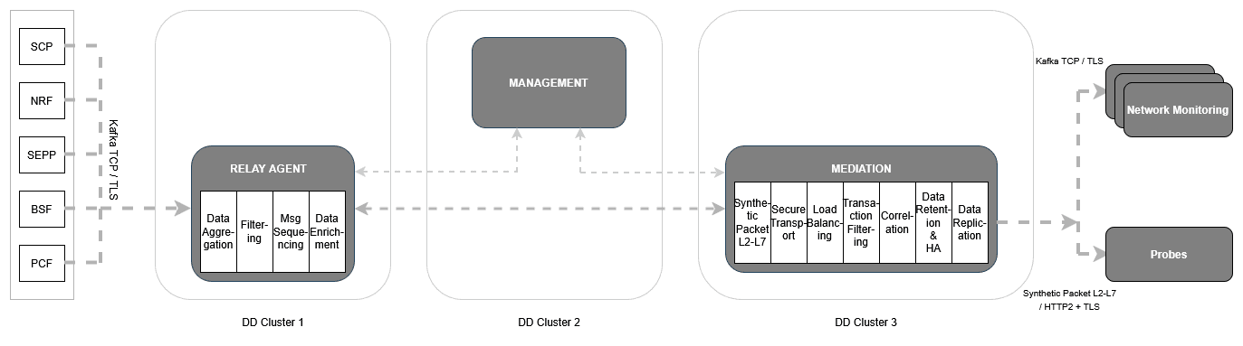

2.1.3.1.2 Model 2: OCNADD Management Group Services, Relay Agent Group Services and Mediation Group Services in Different Clusters
In this OCNADD deployment model, all the OCNADD groups, for example the Management group, Relay agent group and Mediation group, are deployed in different clusters. In this deployment option, all the features are available.
For this deployment model, the default Kafka storage options are as follows:
Figure 2-2 Model 2
Model 2
To utilise this deployment option, ensure that mTLS is enabled across OCNADD for all groups. Additionally, configure all gateways and the mediation Kafka cluster with external access enabled.
For detailed instructions on enabling External Communication Between Gateways and Enable External Access For Kafka Cluster, refer to the Oracle Communications Network Analytics Data Director User Guide.
In this deployment mode, various combinations are supported. Some possible deployment combinations include:

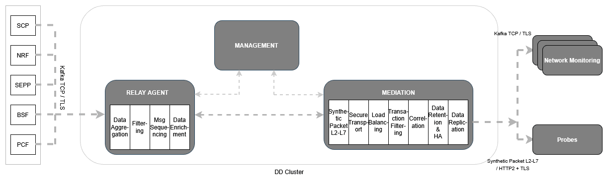

2.1.3.1.3 Model 3: OCNADD Management Group Services, Relay Agent Group Services and Mediation Group with Kafka Only
Use this model when the customer does not wish to receive the message feed using HTTP/2 or TCP connection mode. The third-party monitoring application available to the customer can consume data directly from the Kafka cluster. The Egress adapter is not required in this deployment model; however, the OCNADD deployment requires common services such as UI, Configuration, Health Monitoring, Alarm, and Admin. Features like correlation-id-based load balancing, synthetic feed, and HTTP/2 feeds are unavailable in this deployment model, although the filtering and correlation features will be available using Kafka feeds only.
This model saves the Egress adapter resource; however, additional resources will be required for Filtering and Correlation services once these features are used in the configurations from the UI. The export feature is also possible; however, it has to be enabled in the charts by enabling the ocnaddexport service and further export configuration from the UI.
Figure 2-3 Model 3
Model 3
This deployment model supports a direct Kafka feed. For more information, see the External Kafka Feeds section in the Oracle Communications Network Analytics Data Director User Guide.
In this deployment option, Mediation Group Services can co-exist with Relay Agent Group Services and Management Group Services, or they can exist independently in a separate cluster. Higher end-to-end latency may be reported if the Relay Agent Group and Mediation Group are deployed in separate clusters.
