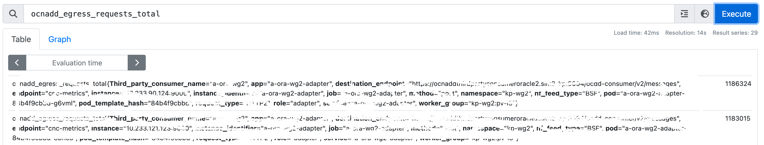

ocnadd_egress_requests_total
This metric will be pegged as soon as the request reaches the ocnadd egress adapter.
This metric peg count of total request which has to be forwarded to third party. This metric is used for the Egress MPS at DD.
Metric Type: Counter
  • app
  • method
  • instance_identifier
  • nf_feed_type
  • request_type
  • Third_party_consumer_name
  • worker_group
  • relay_agent_group
  • mediation_group
  • destination_endpoint
  • role
  • service

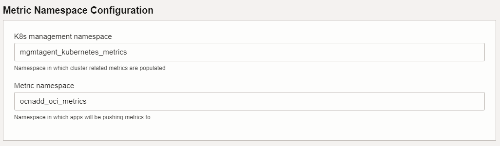

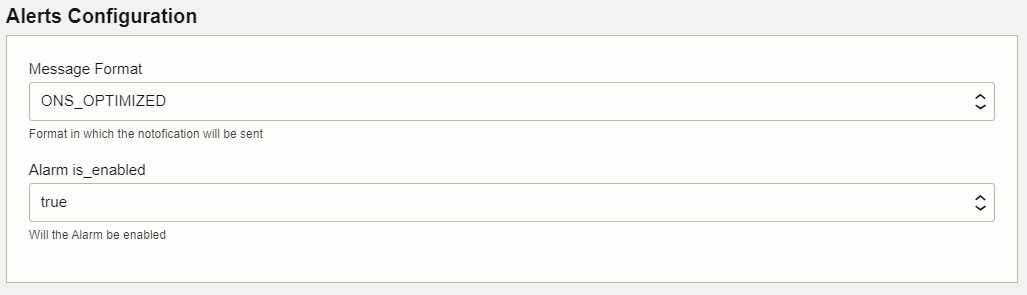

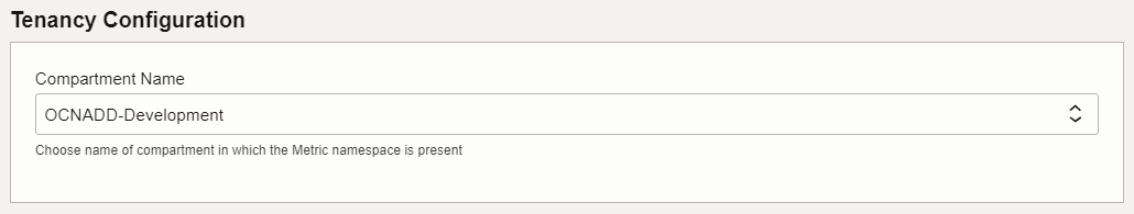

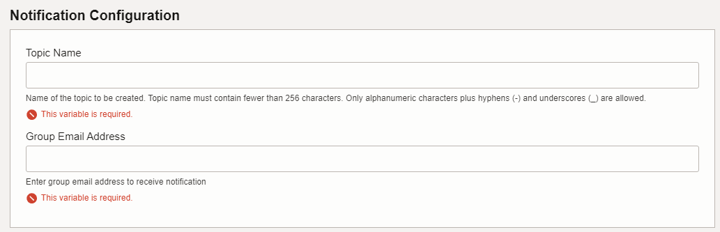

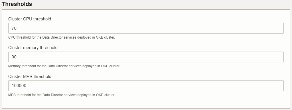

  3. Provide appropriate values for the parameters requested in the Terraform script as shown in the following screenshots:
    Tenancy Configuration
    Metric Namespace Configuration
    Notification Configuration
    Alerts Configuration
    Thresholds
OCNADD supports alarm subscription through email on OCI, and here are some important points for configuring alarms:
  1. Alarm Categories in OCI: Alarms in OCI are categorized into critical, warning, info, and error. Note that the error category is not available in Prometheus alert rules. Therefore, alarms with severity minor and major in Prometheus are converted to error in OCI. For more information, see OCI Alert Template.
  2. Notification and Topic Setup: During the execution of the Terraform script, notifications and topics for the alerts will be automatically created.
  3. User Modification/Deletion: If users need to create new alarms or modify and delete the alarms added through Terraform, they can perform these actions by editing the corresponding alarm definitions through the OCI Console.
  4. OCI Notification Reference: For more information on OCI Notification, see OCI Notification.

      2. Verify metrics availability in Prometheus.
        Verify metrics on prometheus.

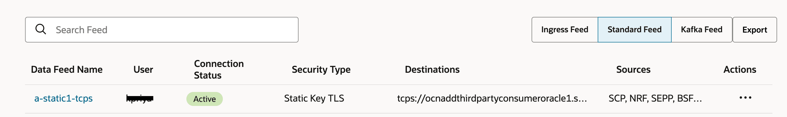

      3. Confirm "ACTIVE" status of feeds on the DD UI when traffic is successfully flowing.

pod_cpu_usage_seconds_total[10m]{pod=~"*admin*|*kraft*|*mediation*"}.rate().groupby(namespace,pod).sum()*100>={{ CPU Threshold }} || pod_cpu_usage_seconds_total[10m]{pod=~"corr*"}.rate().groupby(namespace,pod).sum()*100>=3*{{ CPU Threshold }}||pod_cpu_usage_seconds_total[10m]{pod=~"*kafka*"}.rate().groupby(namespace,pod).sum()*100>=6*{{ CPU Threshold }} || pod_cpu_usage_seconds_total[10m]{pod=~"*export*"}.rate().groupby(namespace,pod).sum()*100>=4*{{ CPU Threshold }} || pod_cpu_usage_seconds_total[10m]{pod=~"*storageadapter*"}.rate().groupby(namespace,pod).sum()*100>=3*{{ CPU Threshold }} || pod_cpu_usage_seconds_total[10m]{pod=~"*ingressadapter*"}.rate().groupby(namespace,pod).sum()*100>=3*{{ CPU Threshold }} || pod_cpu_usage_seconds_total[10m]{pod=~"filter*"}.rate().groupby(namespace,pod).sum()*100>=2*{{ CPU Threshold }}
Note: CPU Threshold will be assigned will executing the terraform script

Note: The thresholds are configurable in the ocnadd-common-custom-values.yaml and ocnadd-mediation-custom-values.yaml files. If guidance is required, contact My Oracle Support.
