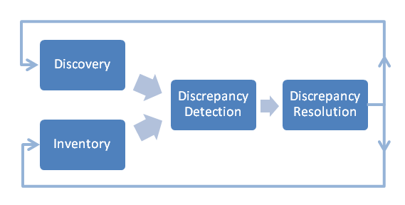

Figure 1-1 illustrates a typical Network Integrity discovery and discrepancy resolution process flow.
Figure 1-1 Network Integrity Typical Process Flow
Description of "Figure 1-1 Network Integrity Typical Process Flow "
The typical Network Integrity process flow is:
Run an import scan to import inventory data from an inventory system.
Run a discovery or assimilation scan, to discover or assimilate network data from a network system, with the Detect Discrepancies option enabled.
Elements, physical resources, and logical resources in the network are discovered by scanning Network Elements (NEs), Element Management Systems (EMSs), and Network Management Systems (NMSs). For example, you poll an NE to find all ports and to determine whether each port is free or assigned, or you poll an optical EMS to find unused ports.
Discovered or assimilated entities are matched with the inventory view of networks and services and generate discrepancies. For example, you match the discovered NE and each port on it with objects in inventory.
See "Managing Scans and Viewing Scan Results" for more information.

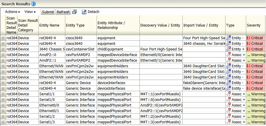

Discrepancies are evaluated in the Network Integrity UI, or by viewing generated reports, which can be studied to obtain a deeper understanding of the inventory discrepancies.
For more information, see "About Discrepancy Detection, Review, and Resolution" and "About the Reporting Solution".
Figure 1-2 Network Integrity UI View of Discrepancies
Description of "Figure 1-2 Network Integrity UI View of Discrepancies " -
Discrepancies are corrected using Network Integrity. You can make individual or bulk corrections. Network Integrity synchronizes the discovered data with the inventory reference data. You can assign, rank and annotate discrepancies. Using the UI to perform synchronization reduces the likelihood of errors, compared to making changes manually, and better supports a multi-user environment.

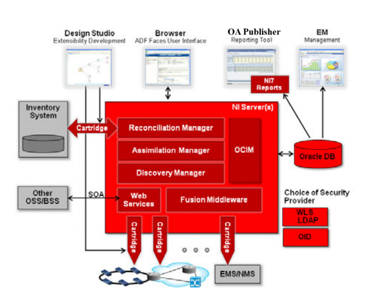

About the Network Integrity Architecture
Figure 1-3 outlines the Network Integrity architecture.
Figure 1-3 Network Integrity Architecture
Network Integrity runs on Oracle WebLogic Server, and includes the following features and functions:
Support for cartridges developed in Oracle Communications Service Catalog and Design - Design Studio, to provide extensibility. See "Using Design Studio for Network Integrity".
A browser-based web UI based on Oracle Fusion Middleware ADF Faces technology which provides a single user experience for network discovery and data reconciliation. The web UI supports localization. See "About the Network Integrity UI".
Reporting provided by Oracle Business Information (BI) Publisher (optional) or other third-party solution. See "About the Reporting Solution".
Reference implementations are provided against Oracle Communication Unified Inventory Management (UIM) and MetaSolv Solution (MSS) for the import of data and resolution of discrepancies; support for other third-party systems is possible through extensibility. See "Integrating with Inventory Systems".
Support for the Oracle Communications Information Model, which is based on the TM Forum's Information Framework (SID). See "Integrating with UIM".
Network Integrity 7.4.0 supports Oracle Communications Information Model 7.3.0. For specific technical details about the Oracle Communications Information Model and the Network Integrity information model, see Oracle Communications Information Model Reference and Network Integrity Information Model Reference.
Oracle Communications Information Model Reference and Network Integrity Information Model Reference are located in Network Integrity Developer Documentation on the Oracle software delivery website.
Runs on Oracle Fusion Middleware platform. See "About Oracle Fusion Middleware Platform".
SOA-based JEE compliant web services API to facilitate customized solutions for external management of Network Integrity. See "Managing Network Integrity Using the Web Services API".
Support for application and database clustering for scalability and high availability.
Able to integrate with external Security Providers, preventing replication of user accounts and credentials in Network Integrity. See "About User and Identity Management".
Discrepancy detection is the process where Network Integrity compares discovered network data with imported inventory data and reports on differences between the sets of data. Discrepancy detection is an optional part of a scan run.
Network Integrity reports the following types of discrepancies:
Attribute Value Mismatch: an entity exists in both the network and the inventory results, but an attribute has different values.
Extra or Missing Entity: an entity (or any dependent children) is present in one set of results but is missing from the other side.
Extra or Missing Association: an association exists for an entity in one set of results, but is missing from the other side.
Ordering or Association Ordering Error: matching entities or associations appear in different orders in the network and inventory results.
You can edit the details of a discrepancy, ignore the discrepancy, or send details of the data discrepancies to an external system. See "Integrating with Inventory Systems".
Discrepancy review is facilitated by extensive search capabilities, a color-coded severity system, and the ability to assign a priority and owner to each discrepancy. You can also store notes to track progress and enhance an audit trail.
Discrepancy resolution enables you to carry out in-context correction, multiple corrective actions, or bulk discrepancy correction. You can also ignore certain discrepancies. You can use Design Studio to create cartridges that extend Network Integrity to discover new types of devices, to import from different inventory systems, or to enhance Network Integrity to automatically resolve discrepancies.
