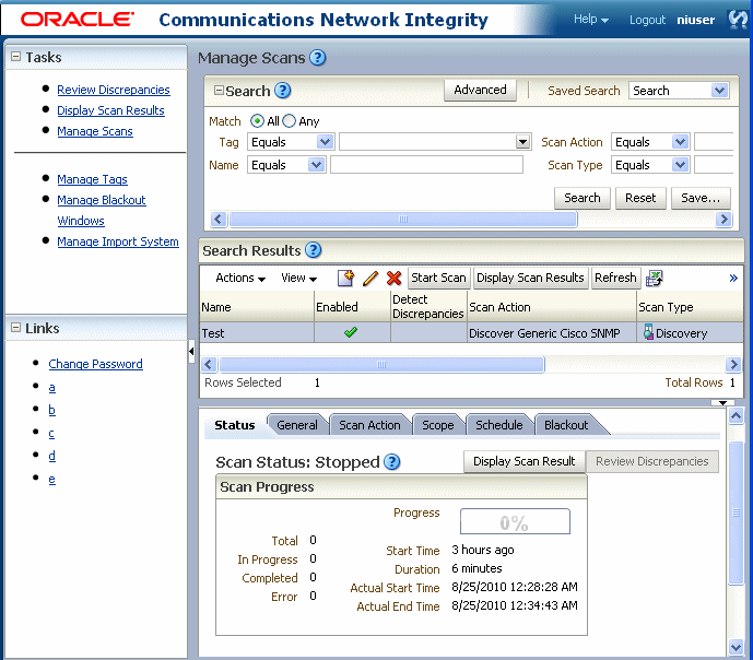

About the UI
The following figure provides an overview of the Network Integrity UI.
The Network Integrity UI enables you to carry out tasks such as:
Configuring network device discovery and inventory system import scans
Initiating and/or scheduling scans
Checking scan results
Managing discrepancy comparisons between network and discovery results
The UI is made up of a number of work areas:
The global area. See "About the Global Area".
The regional area. See "About the Regional Area".
The local area. See "About the Local Work Area".
The global area at the top of the Network Integrity UI consists of:
A product identification area; Oracle Communications Network Integrity
An area showing the name of the currently logged in user; niuser
A logout link. See "Logging Out of Network Integrity"
A Help menu. See "About the Help Menu"
A processing indicator. See "About the Processing Indicator".
The following figure displays the global area.

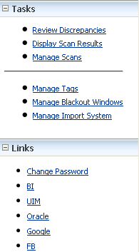

About the Tasks Panel
The Tasks panel provides access to tasks required to complete the business process associated with a work area. When you select a task link, it replaces the local area contents.
The following figure displays the Tasks panel.
The task panel for Network Integrity has the following links:
Review Discrepancies. See "About the Review Discrepancies Link".
Display Scan Results. See "About the Display Scan Results Link".
Manage Scans. See "About the Manage Scans Link".
Manage Tags. See "About the Manage Tags Link".
Manage Blackout Windows. See "About the Manage Blackout Windows Link".
Manage Inventory System. See "About the Manage Import System Link".

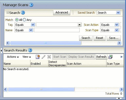

Click this link to load the Manage Scans page. Initially, the search pane is expanded and the results table is empty. Enter some search criteria, execute a search, and then review the resulting list of scans.
If you use the default search criteria, and click Search, you carry out a search for all scans.
See "Using Scans".

About the Links Panel
You can place convenient web links in the Links panel. Typically, these are links to the web pages of external systems that may be used in conjunction with Network Integrity; for example, a link to the Oracle Communications Unified Inventory Management (UIM) login page or to the technical specifications for equipment on the network.
The following figure displays the Links panel.
Links are configured by the Network Integrity administrator. All links are application-wide, so all Network Integrity users see the same links with the same link text. For more information on creating links, see “Configuring System Wide Links" in Oracle Communications System Administrator's Guide.
If Oracle BI Publisher is installed as part of the Network Integrity install, then a link to the installed BI Publisher instance is created automatically by the installer. The Network Integrity administrator can edit or remove this link later.
A link to the Change Password page is optionally created by the installer. This link is displayed as the Change Password link. The Network Integrity Administrator can edit or remove this link later. See "About the Change Password Link".

The local work area is on the right of the UI. The default work area displays the Manage Scans page when Network Integrity first starts up. When a task link is selected from the Tasks panel, it replaces the local area contents.
The following figure shows the default work area at startup.
