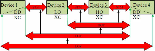

Figure 5-1 shows the relationships for an unprotected LOP. There are relationships between the LOP, LOT, HOT, and STMs. The LOT can reference both an HOT and an STM as the parent. The LOP has only one path.

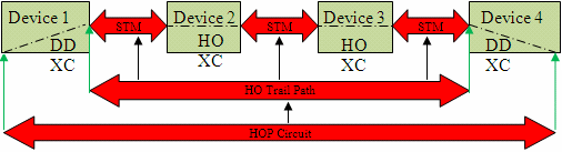

Figure 5-2 shows the relationships for an unprotected HOP. This HOP has only one path.

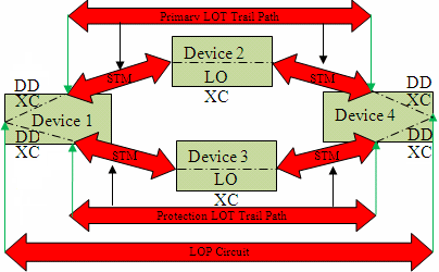

Figure 5-3 shows a circuit with multiple paths. One path is the primary path and the other is the protected path. This is an example of a fully-protected circuit where the LOP has two LOT paths.

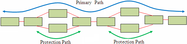

Figure 5-4 shows a partially-protected circuit. The protection path only represents the protected segments of the LOP. The protection path is protecting only part of the circuit, between device 2 and device 5, by taking a different path through device 4. The segments between device 1 and 2 and between device 5 and 6 are not protected.
Figure 5-5 shows a more complex example of a partially-protected LOP, containing multiple protected segments.
