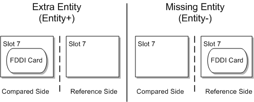

Extra Entity and Missing Entity
This discrepancy indicates that an entity (and any dependent children) is present on one side of the comparison, but is absent from the other side.
An Extra Entity discrepancy indicates that the entity is present in the Compared side, but not in the Reference side.
In Figure 4-1, the example for the Extra Entity discrepancy shows an FDDI card in slot 7 present on the Compared side that is missing on the Reference side.
A Missing Entity discrepancy indicates the reverse: the entity is absent is the Compared side, but present in the Reference side.
In Figure 4-1, the example for the Missing Entity discrepancy shows that slot 7 is missing an FDDI card on the Compared side that is present on the Reference side.
Figure 4-1 Examples of Extra Entity and Missing Entity
Description of "Figure 4-1 Examples of Extra Entity and Missing Entity"

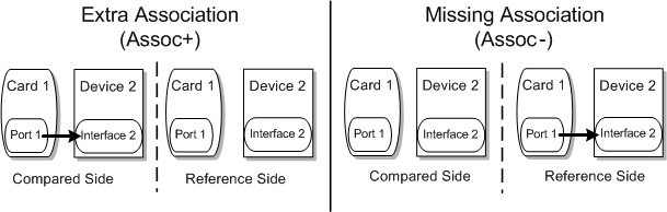

Extra Association and Missing Association
This discrepancy indicates that an association in one entity (source) referencing another entity (target) is present on one side of the comparison, but is absent from the other side.
An Extra Association discrepancy indicates that the association is present in the Compared side, but not in the Reference side.
In Figure 4-2, the example for the Extra Association discrepancy shows a Mapped Device Interface association from Port 1 to Interface 2 present on the Compared side that is missing on the Reference side.
A Missing Association discrepancy indicates the reverse: the association is absent in the Compared side, but is present in the Reference side.
In Figure 4-2, the example for the Missing Association discrepancy shows that the Mapped Device Interface association from Port 1 to Interface 2 is missing on the Compared side but is present on the Reference side.
Each discrepancy indicates a problem with a single direction of association. If two entities have a bidirectional association with each other, and this bidirectional association is completely missing on one side, two discrepancies are generated by Network Integrity.
Figure 4-2 Examples of Extra Association and Missing Association
Description of "Figure 4-2 Examples of Extra Association and Missing Association"

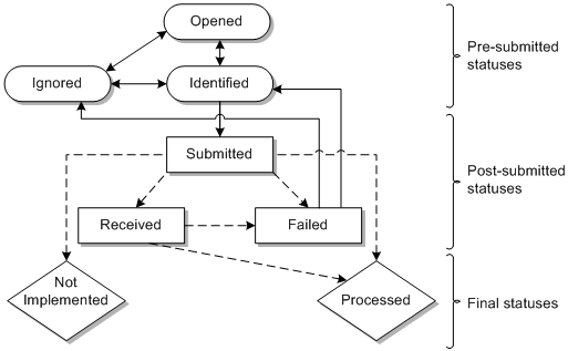

About Discrepancy Status
The discrepancy status field identifies the state of a discrepancy within its life cycle. Table 4-10 lists the possible discrepancy statuses.
Table 4-10 Discrepancy Statuses
| Status | Status Change Trigger | Valid Follow-On Statuses |
Opened |
NA |
Ignored, Identified |
Ignored |
UI command |
Opened, Identified |
Identified |
UI command |
Submitted, Ignored, Opened |
Submitted |
Programmatic operation |
Received, Failed, Processed, Not Implemented |
Received |
Failed, Processed |
Failed |
UI command |
Not Implemented |
NA |
NA |
Processed |
NA |
NA |
Figure 4-3 shows the discrepancy status lifecycle diagram.
Every discrepancy begins with a status of OPENED when it is first detected. It can then be moved to one of two states by a user using a web UI operation:
IDENTIFIED, by using a resolution action menu item
IGNORED, by using the Ignore menu item
When a discrepancy is in the IDENTIFIED state, a user can use the Submit operation to move it to the SUBMITTED state. At this point, the discrepancy has moved out of user control, and into the control of a resolution action.
The resolution action processes the submitted discrepancy, and reports the outcome by setting the status to:
PROCESSED, or
FAILED
If the status is PROCESSED, the operation has succeeded, and the discrepancy can no longer be acted upon. If the status is FAILED, it becomes available for the user to specify an operation again, just like when it was first opened.
A resolution action may set a discrepancy status to RECEIVED immediately after the submit operation. This status indicates that the resolution operation is in progress, and reports its final operation status later.

status |
DisDiscrepancyStatus (Enum) |
This is the current status of this discrepancy. Valid values are:
lastStatusChangeTime |
Date |
This is the timestamp when the status attribute was last updated. |
