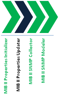

To extend the MIB II SNMP Discovery cartridge project for updated vendor and interface type information:
Create a Network Integrity cartridge project called Vendor_Type_Update. Make your cartridge project dependent on the MIB_II_SNMP_Cartridge cartridge project.
Create a discovery action called Discover Updated MIB II SNMP.
In Discover Updated MIB II SNMP, add the Discover MIB II SNMP action as a processor.
Create a discovery processor called MIB II Properties Updater and place it after the MIB II Properties Initializer processor. This processor will be used to update the two mapping tables.
Open the Processor editor Context Parameters tab for MIB II Properties Updater and add snmpIfTypeMap and snmpVendorNameMap as input parameters. These parameters are the output from the MIB II Property Initializer processor.
Create the implementation class for this discovery processor. See "Implementing a Processor" for instructions on how to add an implementation class to a processor.
Add the implementation code into the body of the invoke method of the discovery processor implementation class, similar to the following:
// Rename 34416 from "Ottawa Area Intermediate School District" // to "Ottawa Area Middle School District" // Add a new vendor ID 90210 = West Beverly Hills School District // Map<String, String> vendorNameMap = request.getSnmpVendorNameMap(); vendorNameMap.put("34416", "Ottawa Area Middle School District"); vendorNameMap.put("90210", "West Beverly Hills School District"); // Add a new interface type 333 as tachyonEther. // Map<String, String> ifTypeMap = request.getSnmpIfTypeMap(); ifTypeMap.put("333", "tachyonEther"); -
Build, deploy, and test your cartridge.
Figure 6-1 shows the processor workflow of the Discover Updated MIB II SNMP action and the placement of the MIB II Properties Updater processor.
This discovery action inherits all the processors from the Discover MIB II SNMP action. See "Overview" in MIB-II SNMP Cartridge Guide for more information.
Figure 6-1 Discover Updated MIB II SNMP Action
Description of "Figure 6-1 Discover Updated MIB II SNMP Action"

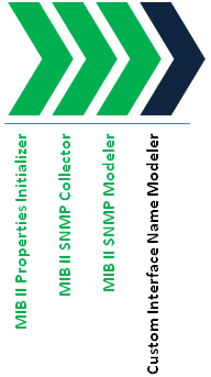

In the Discover Custom MIB II SNMP action, create a discovery processor called Custom Interface Name Modeler.
Open the Processor editor Context Parameters tab for Custom Interface Name Modeler and add logicalDevice as an input parameter. This parameter is the output from the MIB II SNMP Modeler processor.
On the Processor editor Details tab, create the implementation class for the discovery processor.
Add the implementation code similar to the following:
Import statements are required to successfully compile the following code, the imports should all be resolvable by Eclipse with the existing classpath, no classpath changes are necessary.
@Override public void invoke(DiscoveryProcessorContext context, CustomInterfaceNameModelerProcessorRequest request) throws ProcessorException { // if the user specified they do not want the ifDesc as the name of the interface then use the ifName instead if ("false".equalsIgnoreCase(request.getMibiiCustomParameters().getMapIfDescToInterfaceName())) { List<DeviceInterface> deviceInterfaces = request.getLogicalDevice().getDeviceInterfaces(); changeInterfaceNameToIFName(deviceInterfaces); } } private void changeInterfaceNameToIFName(List<DeviceInterface> deviceInterfaces) { // loop through every interface and change the mapping. for (DeviceInterface deviceInterface : deviceInterfaces) { // the Discover MIB II SNMP Discovery Action is inserting the ifName into the VendorInterfaceNumber so the following code copies that to the name field deviceInterface.setName(deviceInterface.getVendorInterfaceNumber()); // Change interface name on any sub-interfaces as well changeInterfaceNameToIFName(deviceInterface.getSubInterfaces()); } } -
To register discrepancy detection and discrepancy resolution on the new Discover Custom MIB II SNMP discovery action, add new result sources to the Detect MIB II UIM Discrepancies and Resolve MIB II in UIM in the MIB_II_UIM_Cartridge that register for results from the Discover Custom MIB II SNMP discovery action. See "About Discrepancy Detection Actions" and "About Discrepancy Detection Processors" for details.
Figure 6-2 shows the processor workflow of the Discover Custom MIB II SNMP action and the placement of the Custom Interface Name Modeler processor.
Figure 6-2 Discover Custom MIB II SNMP Action
Description of "Figure 6-2 Discover Custom MIB II SNMP Action"

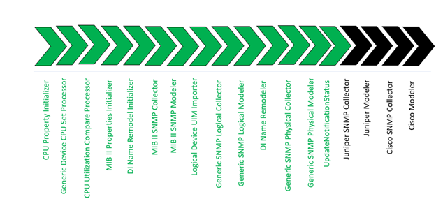

Create a Network Integrity cartridge project called Multi-Vendor. Make your cartridge project dependent on the Generic_SNMP_Cartridge cartridge project.
Create a discovery action called Discover Multi-Vendor.
In Discover Multi-Vendor, add the Discover Generic SNMP action as a processor.
Manually copy the JUNIPER-MIB to the MIB directory and to the SNMP adapter on the Network Integrity server. See "Supporting New MIBs" and "Extending the SNMP JCA Resource Adapter" for more information.
Create an SMMP processor called Juniper SNMP Collector and add it to Discover Multi-Vendor as the last processor.
In Juniper SNMP Collector, add the OID jnxBoxDescr (from JUNIPER-MIB).
In a production environment, you would add more OIDs to poll and model more information.In this example, only the description field is polled.
Create an SNMP processor called Juniper SNMP Modeler and add it to Discover Multi-Vendor as the last processor. This processor takes the SNMP output parameter from Juniper SNMP Collector as its input parameter. Implement this processor by implementing the invoke method. In this example, only the description field for the Juniper device is logged. In a realistic scenario, the complete model of the Juniper device would exist in this invoke method.
The following is the Java snippet for the invoke method.
@Override public void invoke(DiscoveryProcessorContext context, JuniperProcessorProcessorRequest request) throws ProcessorException { logger.log(Level.INFO, "Processing Juniper device " + request.getScopeAddress()); JuniperSNMPCollectorResponseType responseDoc = request.getJuniperSNMPCollectorResponseDocument(); DiscoveryResultType result = responseDoc.getDiscoveryResult(); JuniperMibMib juniperMibResults = result.getJuniperMibResults(); if(juniperMibResults != null) { logger.log(Level.INFO, "Juniper Device Description: " + juniperMibResults.getJnxBoxDescr()); } } -
Create an SNMP processor called Cisco SNMP Collector and add it to Discover Multi-Vendor as the last processor.
Add the OIDs from downloaded CISCO MIBS within Cisco SNMP Collector.
Create an SNMP processor called Cisco SNMP Modeler and add it to Discover Multi-Vendor as the last processor. This processor takes the SNMP output parameter from Cisco SNMP Collector as its input parameter. Implement this processor by implementing the invoke method. In this example, only the description field for the Cisco device is logged. In a realistic scenario, the complete model of the Cisco device would exist in this invoke method.
Create a Cisco condition that checks the sysObjectId to determine whether a device is a Cisco device or not. This condition takes the mibiisnmpCollectorResponseDocument (an output parameter from MIB II SNMP Collector) as the input parameter. The following is a Java snippet for this Cisco condition:
public class CiscoConditionImpl implements CiscoCondition { private static final String CISCO_PREFIX = "1.3.6.1.4.1.9."; @Override public boolean checkCondition(DiscoveryProcessorContext context, CiscoRequest request) throws ProcessorException { MIBIISNMPCollectorResponseType snmpResponse = request .getMibiisnmpCollectorResponseDocument(); logger.log(Level.INFO, "CiscoConditionImpl" + context.getProcessorName()); if (snmpResponse != null && snmpResponse.getDiscoveryStatus() == DiscoveryStatus.SUCCESS) { logger.log(Level.INFO, "CiscoConditionImpl discovery succeeded"); if (snmpResponse.getDiscoveryResult().getRfc1213MibResults() != null) { String sysObjectId = snmpResponse.getDiscoveryResult() .getRfc1213MibResults().getSysObjectID(); logger.log(Level.INFO, "CiscoConditionImpl raw sys object id:" + sysObjectId); if (sysObjectId != null) { if (sysObjectId.startsWith(".")) { sysObjectId = sysObjectId.substring(1); } return sysObjectId.startsWith(CISCO_PREFIX); } } } return false; } } -
12. Create a Juniper condition, that checks the sysObjectId to determine whether a device is a Juniper device. This condition takes the mibiisnmpCollectorResponseDocument (an output parameter from MIB II SNMP Collector) as the input parameter. This Juniper condition is similar to the Cisco condition. The difference is that the sysObjectId for Juniper device starts with 1.3.6.1.4.1.2636.
Apply the Cisco condition to the following processors and set Equals to true:
Cisco SNMP Modeler
Apply the Juniper condition to the following Juniper processors and set Equals to true:
Figure 6-3 shows the processor workflow of the Discover Multi-Vendor action and the placement of the Juniper SNMP Collector and Juniper Modeler processors.
This discovery action inherits all the processors from the Discover Generic SNMP action. See SNMP Discovery and UIM Integration Cartridge Guide for more information.

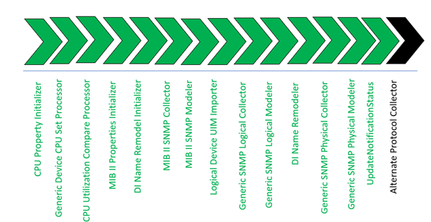

Create a discovery action called Discover MultiProtocol and make it dependent on the Generic_SNMP_Cartridge cartridge project.
Create a discovery action called Discover Multi-Protocol.
In Discover Multi-Protocol, add the Discover Generic SNMP action as a processor.
Create a discovery processor called Alternate Protocol Collector to implement the alternate protocol to discover a device and add it to Discover Multi-Protocol as the last processor.
Implement Alternate Protocol Collector by implementing the invoke method. In this example, one line is logged indicating that this processor implements an alternate protocol. In a realistic scenario, implement the alternate protocol to discover a device in this invoke method. The following is the Java snippet for the invoke method:
@Override public void invoke(DiscoveryProcessorContext context, AlternateProtocolCollectorProcessorRequest request) throws ProcessorException { logger.log(Level.INFO, "SNMP Failed - using alternate protocol to discover device " + request.getScopeAddress()); } -
Create a condition called SnmpSucceeds that checks the SNMP results from MIB II Collector to determine whether the SNMP discovery on a device is successful or not. This condition takes mibiisnmpCollectorResponseDocument (an output parameter from MIB II SNMP Collector) as the input parameter. The following is a Java snippet for this SnmpSucceeds condition:
public class SnmpSucceedsConditionImpl implements SnmpSucceedsCondition { @Override public boolean checkCondition(DiscoveryProcessorContext context, SnmpSucceedsRequest request) throws ProcessorException { MIBIISNMPCollectorResponseType snmpResponse = request.getMibiisnmpCollectorResponseDocument(); return snmpResponse != null && snmpResponse.getDiscoveryStatus() == DiscoveryStatus.SUCCESS; } } -
Apply the SnmpSucceeds condition to the following processors and set the Equals to be true:

By applying the SnmpSucceeds condition, these processors are invoked only if the SnmpSucceeds condition returns true.
Apply the SnmpSucceeds condition to the Alternate Protocol Collector processor and set the Equals to be false.
Figure 6-4 shows the processor workflow of the Discover MultiProtocol action and the placement of the Alternate Protocol Collector processor.
