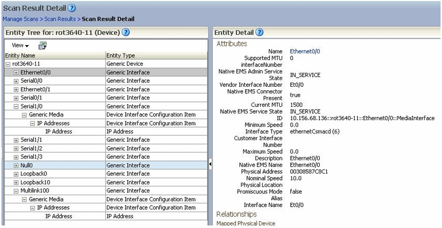

Sample Logical Device Hierarchy
Figure 4-2 shows a logical device hierarchy.
Figure 4-2 Sample Logical Device Hierarchy
Description of "Figure 4-2 Sample Logical Device Hierarchy"
