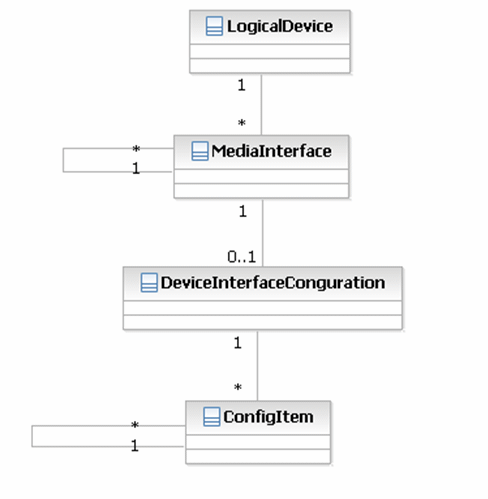

This chapter provides information on modeling the Oracle Communications Network Integrity MIB-II SNMP cartridge.
MIB-II SNMP Cartridge UML Representation
Figure 4-1 displays a unified modeling language (UML) diagram depicting the object relationship being rendered.
Figure 4-1 MIB-II SNMP Cartridge UML Representation
Description of Figure 4-1 follows
Description of "Figure 4-1 MIB-II SNMP Cartridge UML Representation"
Hierarchy Mapping
The logical device object is established and seeded with data sourced by RFC1213-MIB.mgmt.mib-2.system tables.
As a device is discovered, the media interface encapsulates common information about that interface. The device interface configuration captures the media type information that decorates the interface with media-specific parameters that define its behavior (that is; Generic, ATM, Frame Relay or VLAN). This cartridge supports only Generic.

About Oracle Communications Information Model
The logical device and media interface objects are Oracle Communications Information Model 1.0 compliant for static fields. The dynamic fields (sometimes referred to as characteristics) are considered application-specific.
The device interface configuration is considered a mechanism to customize the media interface to show application specific data. See Figure 4-1.

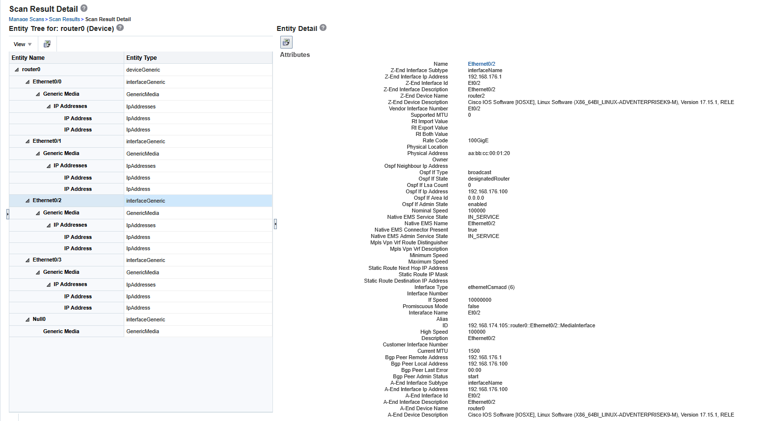

Sample Logical Device Hierarchy
Figure 4-2 shows a logical device hierarchy.
Figure 4-2 Sample Logical Device Hierarchy
Description of Figure 4-2 follows
Description of "Figure 4-2 Sample Logical Device Hierarchy"
