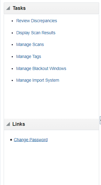

About the Regional Area
The regional area on the left of the UI consists of two panels:
The Tasks panel; see "About the Tasks Panel".
The Links panel; see "About the Links Panel".
Figure 1-2 displays the regional area.
Figure 1-2 Regional Area of Network Integrity UI
The Tasks panel provides access to tasks required to complete the business process associated with a work area. When you select a task link, it replaces the local area contents.
The task panel for Network Integrity has the following links:
Review Discrepancies. See "About the Review Discrepancies Link".
Display Scan Results. See "About the Display Scan Results Link".
Manage Scans. See "About the Manage Scans Link".
Manage Tags. See "About the Manage Tags Link".
Manage Blackout Windows. See "About the Manage Blackout Windows Link".
Manage Inventory System. See "About the Manage Import System Link".

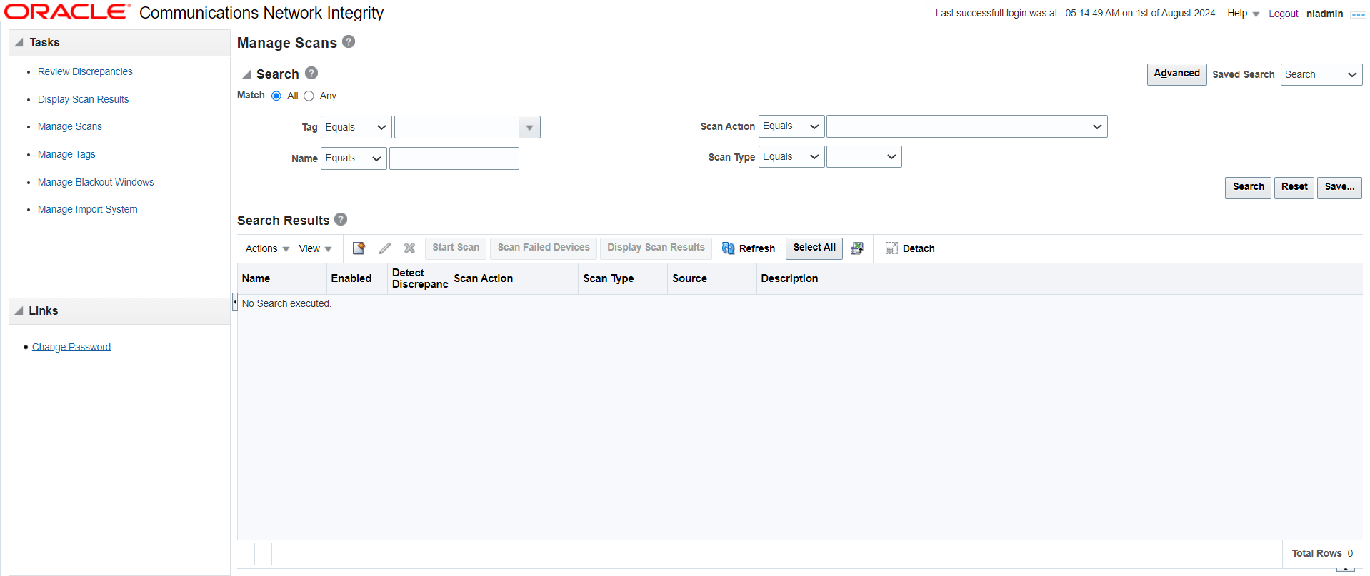

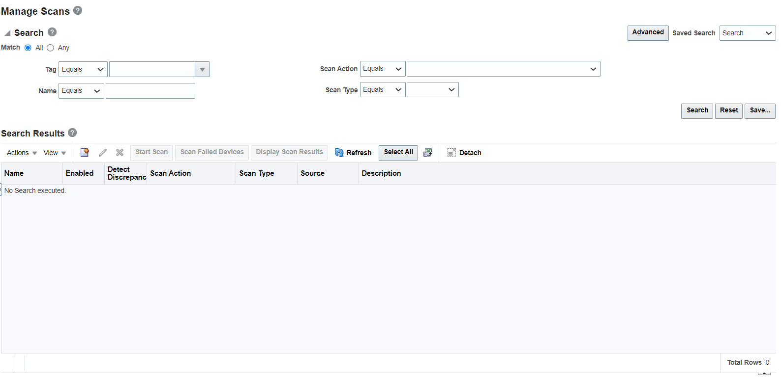

Click this link to load the Manage Scans page. Initially, the search pane is expanded and the results table is empty. Enter some search criteria, execute a search, and then review the resulting list of scans.
If you use the default search criteria, and click Search, you carry out a search for all scans.
See "Using Scans".

About the Local Work Area
The local work area is on the right of the UI. The default work area displays the Manage Scans page when Network Integrity first starts up. When a task link is selected from the Tasks panel, it replaces the local area contents.
The following figure shows the default work area at startup.
Figure 1-3 Local Work Area of Network Integrity UI

The following table describes the keyboard shortcuts defined for the Manage Scans page.
Table 1-3 Keyboard Shortcuts for Manage Scans page
| Action | Shortcut |
| Create a new scan | Alt+Shift+c |
| Edit an existing scan | Alt+Shift+e |
| Delete an existing scan | Alt+Shift+t |
| Start running a scan | Alt+Shift+a |
| Start scanning for failed resources | Alt+Shift+u |
| Display scan results | Alt+Shift+p |
| Refresh the page | Alt+Shift+f |
| Select all scans | Alt+Shift+l |
| Export the scan to Excel | Alt+Shift+x |
