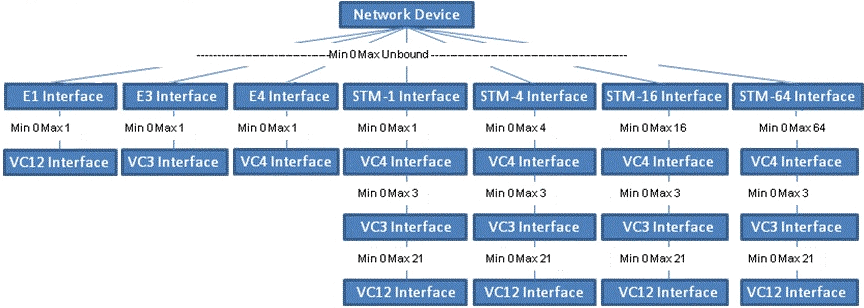

Logical Specification Lineage
This section describes the Device Interface specification hierarchy under a network device that supports the synchronous digital hierarchy (SDH). The discovered TMF814 logical device is mapped to these Logical Device specifications.
Figure 6-1 shows the Logical specification lineage.

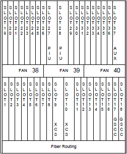

This cartridge is modeled using Design Studio for Inventory specifications, using a visual equipment model to represent the shelf and slots of the device.
Figure 6-2 shows the visual model of a Huawei slot distribution.
Figure 6-2 Visual Model of Huawei Slot Distribution
Description of "Figure 6-2 Visual Model of Huawei Slot Distribution"
Table 6-3 shows how slots in a Huawei device are distributed.
Table 6-3 Huawei OptiX OSN Board Slot Range Distribution
| Board Type | Distributed Slot Ranges |
Service interface boards |
19 to 26 and 29 to 36 |
Service processing boards |
1 to 8 and 11 to 17 |
XCS boards |
9 to 10 |
GSCC boards |
17 to 18 (slot 17 can also hold a service processing board) |
Power interface boards |
27 to 28 |
Auxiliary interface boards |
37 |
