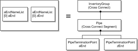

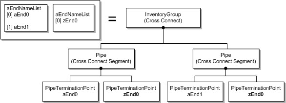

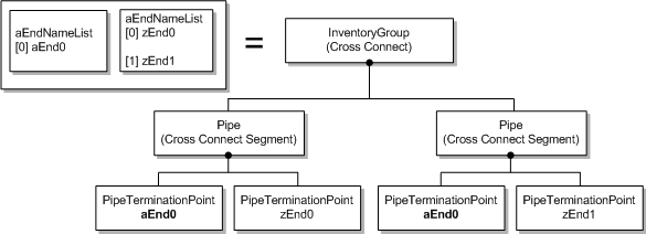

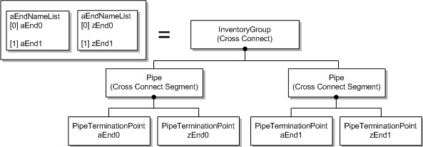

Cross-connect |
InventoryGroup |
tmf814XCGeneric |
aEndName, zEndName (of a cross-connect |
Pipe |
tmf814XCSegmentGeneric A pair of related aEndName and zEndName objects are treated as a cross-connect segment. |
aEndName, zEndName (of a cross-connect segment) |
PipeTerminationPoint |
tmf814PortTerminationPointGeneric |

The Optical TMF814 CORBA cartridge models cross-connects as one of the following types:
ST_SIMPLE: Cross-connects with only one segment, as shown in Figure 5-1.
Figure 5-1 ST_SIMPLE Type Cross-Connect Model Mapping
Description of "Figure 5-1 ST_SIMPLE Type Cross-Connect Model Mapping"Some vendors represent a bidirectional cross-connect as two unidirectional cross-connects, meaning one has A1-Z1 as its ends and other has Z1-A1 as its ends. Such cross-connects are modeled as bidirectional.
ST_EXPLICIT: The cross-connect object is modeled as multiple pipe objects, as shown in Figure 5-2.
Figure 5-2 ST_EXPLICIT Type Cross-Connect Model Mapping
Description of "Figure 5-2 ST_EXPLICIT Type Cross-Connect Model Mapping"The number of objects into which a single cross-connect is modeled depends on aEndNameList and zEndNameList size. The explicit subnetwork connection (SNC) type has an n-entry aEndNameList and zEndNameList pairing. The tuples are pairs matched by index, for example (A1,Z1), (A2, Z2), ...,(An,Zn). A pipe object is modeled for each pair. These multiple pipes are grouped by a parent Inventory Group object.
ST_ADD_DROP_A: The cross-connect object is modeled as two pipe segments with aEndPoint repeating on both cross-connects segment, as shown in Figure 5-3.
Figure 5-3 ST_ADD_DROP_A Type Cross-Connect Model Mapping
Description of "Figure 5-3 ST_ADD_DROP_A Type Cross-Connect Model Mapping" -
ST_ADD_DROP_Z: The cross-connect object is modeled as two pipe segments with zEndPoint repeating on both cross-connects segment, as shown in Figure 5-4.
Figure 5-4 ST_ADD_DROP_Z Type Cross-Connect Model Mapping
Description of "Figure 5-4 ST_ADD_DROP_Z Type Cross-Connect Model Mapping"
