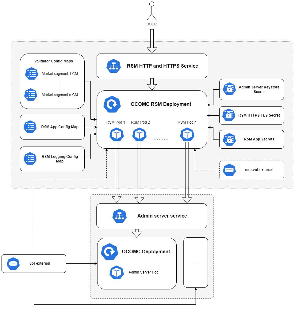

About Offline Mediation Controller REST Services Manager Cloud Native Architecture
Figure 5-1 Offline Mediation Controller REST Services Manager Cloud Native Architecture
- REST Services Manager Deployment: The primary deployment of REST Services Manager with all the necessary components and configurations.
- REST Services Manager HTTP and HTTPS Service: This service exposes REST Services Manager to ports, allowing access to REST Services Manager through HTTP and HTTPS protocols.
- Validator ConfigMap: There is a unique ConfigMap for each market segment.
- REST Services Manager App ConfigMap: The ConfigMap contains the application.yaml file, which holds the configurations required to initiate the REST Services Manager server.
- REST Services Manager Logging ConfigMap: The ConfigMap holds the log4j2.yaml file, encompassing logging-related configurations.
- Admin Server Keystore Secret: This secret contains the administration server KeyStore file in a Base64-encoded format.
- RSM HTTPS TLS Secret: This secret contains the HTTPS TLS store utilized by REST Services Manager when the HTTPS protocol is enabled.
- REST Services Manager App Secret: This secret contains all confidential information necessary to launch the REST Services Manager server.
- vol-external: This is an optional PV reference. REST Services Manager will incorporate it only if the flag rsm.pvc.ocomcExternal.enabled in the override-values.yaml file is set to true. When enabled, the REST Services Manager will share the vol-external PV of the OCOMC core deployment. It is mandatory to enable this flag if the node chain solution includes cartridges containing sensitive information such as FTP or database passwords.
- rsm-vol-external: This PV is optional and can be enabled by setting the flag rsm.pvc.external.enabled to true in the values.yaml file. When enabled, the REST Services Manager will load custom cartridges from the specified PV into the classpath. The source directory for it can be configured in the override-values.yaml file.
