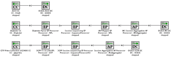

Figure 4-1 shows the architecture of the ECE DC node.
Figure 4-1 ECE DC Node Configuration Architecture
Description of Figure 4-1 follows
Description of "Figure 4-1 ECE DC Node Configuration Architecture"
