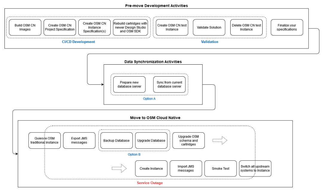

About the Move Process
The move to OSM cloud native involves offline preparation as well as maintenance outage. This section outlines the general process as well as the details of the steps involved in the move to OSM cloud native. However, there are various places where choices have to be made. It is recommended that a specific procedure be put together after taking into account these choices in your deployment context.
The OSM cloud native application layer runs on different hardware locations (within a Kubernetes cluster) than the OSM traditional application layer.
The process of moving to OSM cloud native involves the following sets of activities:
  • Pre-move development activities, which include the following tasks:
    • Building OSM cloud native images (cloud native task)
    • Creating project specification OSM cloud native (cloud native and solution task)
    • Creating instance specification OSM cloud native (cloud native and solution task)
    • Rebuilding cartridges using Design Studio and OSM SDK (solution task)
    • Creating an OSM cloud native instance for testing (cloud native task)
    • Validating your solution cartridges (solution task)
    • Deleting the test OSM cloud native instance (cloud native task)
    • Finalizing your specifications (cloud native and solution task)
  • Data synchronization activities, which include the following tasks:
    • Preparing a new database server (database task)
    • Synchronizing the current database server (database task)
  • Tasks for moving to OSM cloud native, which include the following:
    • Quiescing the OSM traditional instance (solution task)
    • Exporting JMS messages (WebLogic Server administration task)
    • Backing up the database (database task)
    • Upgrading the database (database task)
    • Upgrading the OSM schema and cartridges (database task)
    • Creating an OSM cloud native instance (cloud native task)
    • Importing JMS messages (WebLogic Server administration task)
    • Performing a smoke test (solution task)
    • Switching all upstream systems (solution task)
The following diagram illustrates these activities.
In the diagram, the short form of "OSM CN" stands for "OSM cloud native".
Figure 14-1 Move to OSM Cloud Native Process

If you do need a database server upgrade, choose one of the following options:
  • Option A: Create an additional database server: Create a second database server of the target database version (with required patches), seeded with an RMAN backup of the OSM traditional database. Enable Oracle Active DataGuard to continuously synchronize data from the OSM traditional database to this new database. Use this new database for the OSM cloud native instance. For further details, see Mixed Oracle Version support with Data Guard Redo Transport Services (Doc ID 785347.1) knowledge article on My Oracle Support. The exact mechanisms to be used are subject to circumstances such as resource availability, size of data, timing, and so on but the goal is to have a second database server running the target database version but always containing the data from the OSM traditional database.
    This option has the following advantages:
    • Allows switching from a standalone database to a Container DB and Pluggable DB model that is required for OSM cloud native, without impacting other users of the existing database.
    • Reduces the duration of a service outage since you can avoid having to backup the database and upgrade it as part of the maintenance window.
    • Preserves the OSM traditional database unchanged reducing the risk and cost associated with reverting to OSM traditional instance, if that becomes necessary.
  • Option B: Retain the existing DB server: You can retain the existing database server, upgrading it in-place to the target database version and patches.
If you choose option A, the upgrade process must pause after the export of JMS messages, and ensure the Active DataGuard sync is complete (if there are pending redo logs). Then, before proceeding, the sync must be turned off and the new database must be brought online fully.

After you shut down the OSM traditional instance fully, do the following:
  • Ensure that the OSM cloud native instance has its JMS and SAF objects unpaused and its DB jobs restarted.
  • Configure the upstream and peer systems to resume sending messages. See "Integrating OSM" for more details.

During the move to OSM cloud native, if there is a need to revert to your OSM traditional deployment, the exact sequence of steps that you need to perform depend on the options you have chosen while moving to OSM cloud native.
In general, the OSM traditional deployment application layer should be undisturbed through the upgrade process. If Option A was followed for upgrading the database, the OSM traditional instance can simply be started up again, still pointing to its database.
If however, Option B was followed for upgrading the database, the following steps are required before the OSM traditional instance can be spun up:
  • Revert the database server version to the earlier version (if a database server upgrade was performed as part of the switch to OSM cloud native)
  • Restore the database contents from the backup taken as part of Option B for upgrading the database.
Cleaning Up
Once the OSM cloud native instance is deemed operational, you can release the resources used for the OSM traditional application layer.
If Option A was adopted for the database, then you can delete the database used for OSM traditional instance and release its resources as well. If Option B was followed and your OSM traditional instance was using JDBC persistent stores, the tables corresponding to these are now defunct and you can delete these as well.
