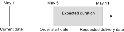

About Determining Order Completion Dates
An order received by OSM includes a requested delivery date. This is the date that the customer wants the order to be completed. OSM can calculate the expected completion date based on the time OSM expects to take to complete all of the tasks in the order.
If the requested delivery date is the same as or earlier than the expected completion date, OSM can start processing the order immediately. However, in some cases, the start date of an order should be delayed. For example, a customer might request that a new VoIP service be added at the beginning of the next month, when the customer's current service expires. In cases where the requested delivery date is later than the expected completion date, you can specify to start the order in the future.
In addition, there might be groups of order items within an order that need to be fulfilled at different times. For example, an order might contain three services, such as internet, IPTV, and VoIP. The internet and IPTV services might have an immediate requested delivery date, but the VoIP service might only be required at the end of the month, after the customer's current phone service plan has expired. In this case, you can enable OSM to calculate an order start time that would allow the service to be activated at the requested delivery date at the end of the month.
To calculate when an order should start so that it can meet a requested delivery date, OSM calculates the expected duration of the order. To enable OSM to calculate the expected duration, you assign processing duration values, for example:
  • You can assign processing duration values to order components.
  • You can assign processing duration values to tasks. These values can be used for calculating the processing duration for order components.
  • You can assign requested start dates to order items.
To calculate the expected duration for the order, OSM uses the expected duration of the order components and tasks in the order. Dependencies between order components are included in the calculation.
After the expected duration for the order has been calculated, OSM assigns an expected completion date to the order, based on the current date and the expected duration. For example, if the current date is May 1, and the expected duration is 5 days, the expected completion date is May 6.
If the expected completion date is later than the requested delivery date, OSM can set the order start date to a date in the future. For example, if the current date is May 1, the expected duration is 5 days, and the requested delivery date is May 11, OSM sets the order start date to May 6. Figure 6-1 shows how a start date is determined for a future order.
Figure 6-1 Future Order Start Date
Description of Figure 6-1 follows
Description of "Figure 6-1 Future Order Start Date"

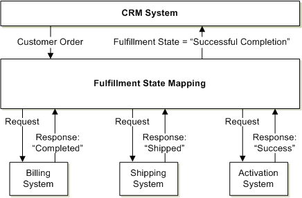

Processing states are a predefined set of states that an order item can enter. OSM aggregates the values returned from external systems in each order component for the order item to determine the overall processing state of the affected order item. You can apply processing states based on values in response messages from external systems that OSM receives in automated task automation plug-ins or based on direct operator input in manual tasks. In addition, because order items can be arranged hierarchically, when a child order item processing state changes, OSM also evaluates whether the parent order item should change, all the way up the hierarchy.
Fulfillment states allow you to send meaningful status values to an upstream system, which would not be able to parse all of the individual statuses returned by the external systems. You can use fulfillment states to manage system complexity in the following ways:
  • Normalize status names. For example, to indicate success, one system might return OK, while another returns Complete. You can map both of these responses to the same value, for example Successful.
  • Create statuses based on multiple statuses. For example, if one system returns the status Complete, and another system returns the status In Progress, you can create a status named Partially Complete.
  • Define composite status values for order items, order components, and the order itself. For order items, you can change the status of a parent order item when the status of a child order item changes.
In addition to using fulfillment states to provide order item and order processing state information to upstream systems, you can also use them to restrict processing of order amendments from the upstream system. This functionality is provided by point-of-no-return processing, which uses fulfillment states. See "About Point of No Return" for more information.
Figure 6-2 depicts a fulfillment state scenario.
Figure 6-2 Fulfillment State in an Order
Description of Figure 6-2 follows
Description of "Figure 6-2 Fulfillment State in an Order"

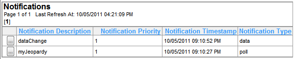

About Notifications
You can use notifications to alert users and external systems to events that occur in the order as it processes or to tell users that an action must be carried out.
There are two types of notifications:
  • Use jeopardy notifications when you want to alert users that an order or a task might have a problem. To trigger jeopardy notifications, OSM checks order and task conditions at specified intervals. If an action has not occurred as expected, OSM sends a notification. Jeopardy notifications are displayed in the Task web client Notifications page.
  • Use event notifications to alert users of changes to an order based on its progress. Event notifications can be triggered by:
    • A change in task state
    • A change in order status
    • A change to order data
You typically configure notifications by using automation plug-ins, which send notification data to end users or systems.
Figure 6-3 shows notifications displayed in the Task web client. You can specify which workgroups can see the notifications.
Figure 6-3 Notifications Displayed in the Task Web Client
Description of Figure 6-3 follows
Description of "Figure 6-3 Notifications Displayed in the Task Web Client"

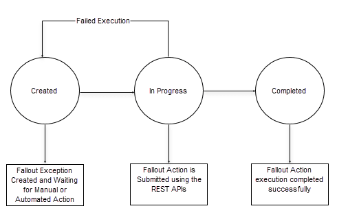

Simplified fallout exception management framework includes:
  • Automation plugin APIs that allow automation code to mark an order as having experienced fallout.
  • For TMF cartridges using an OSM extended specification, custom states indicating fallout.
  • The Fallout Dashboard UI provides a user-friendly interface for easily identifying orders affected by fallout. It also enables you to perform order-level and task-level resolution actions, with clear on-screen messages indicating whether each action succeeds or fails.
  • Specialized fallout resolution actions are accessible to the Fallout Specialist through the Fallout Dashboard UI.
    The Fallout Specialist must be assigned the OSM_fallout role.
  • Fallout Management REST APIs for retrieving fallout exception details and submitting remedial actions.
The simplified fallout exception management is available for both Freeform cartridges as well as TMF cartridges.
Simplified fallout exception management is supported for OSM cloud native deployments only.

Fallout Exception Lifecycle
The lifecycle of a fallout exception includes the following stages:
  • A fallout exception is raised.
  • Task processing is halted.
  • The Fallout Orders dashboard displays the fallout exception.
  • The fallout exception is remediated through the actions available in the Fallout Orders dashboard or via the Fallout Exception Management REST API.
  • Remediation actions can be performed on both the order and task levels:
    • Order-level actions: Abort, Cancel, and Fail Order.

Remedial Actions For Fallout Exceptions Using the Fallout Exception Management REST APIs
The following remedial actions can be submitted using the Fallout Exception Management REST APIs.
  • Force Complete Task: The task will be marked as Complete with the task status provided by you. This resolves the fallout exception. You have to take care of the required data updates that are needed to perform the force complete prior to submitting the action.
  • Retry Task: The task is retried and the fallout exception is cleared. If the Retry is successful, the task completes. If the Retry runs into problems, the cartridge code can raise a new fallout exception.
  • Cancel Order: This operation cancels an order. All outstanding work items associated with the order are deleted, and all complete work items associated with the order are compensated (undone).
  • Fail Order: This results in the entire OSM order failing and triggers an update to the final TMF state in case of TMF orders. The fallout exception is resolved automatically, marked with the action code Fail.
  • failOrderItems: This operation marks all order items as Failed, when a fallout exception is raised on them. The fallout exception is resolved automatically. This action is only applicable for TMF orders.
    • The task that has detected the Order Item state as Failed will remain in the accepted state. However, it will be marked with the action code Stopped and will not process any messages that arrive. This also stops the current tasks of the order component and prevents the order component from completing. All other order components that depend on this failed order component will not start.
    • Other order components that do not have failed order items associated with them will continue processing as normal. However, if any TMF order item within these components later fails, then attempting to force accept or force complete this component will move all of its containing TMF order items to the Failed state. The task will stay in its current state, such as, Accepted.
    • Amendment (revision or cancellation) to the Order is allowed only before the OSM order state is marked Failed. Therefore, the usual order lifecycle policy applies, wherein if the amended TMF order item is in the TMF Failed state, any revisions will be rejected. If there is a revision request that has changes related to the order items which have failed as part of the failOrderItems fallout action, the request is rejected.
      The failOrderItems behavior can also be achieved on a task when there is no fallout exception raised. This can be done with help of the Automation API FailTmfOrderItems() which is provided by OrderContext.
  • Abort Order: This operation tells OSM to stop working on the selected order without triggering any further work.
The remedial actions submitted using the Fallout Exception Management REST APIs updates the fallout exception state from Created to In Progress.
The fallout actions submitted using the REST APIs are processed using the internal OSM automation user (oms-automation). The user oms-automation should have visibility for tasks and orders to perform the fallout action.
The below diagram illustrates the fallout exception state lifecycle changes when remedial actions are submitted using the Fallout Exception Management REST APIs.
Figure 6-4 Fallout Exception Lifecycle
For more detailed information on using the Fallout Exception Management Rest APIs, refer to the OSM Developers Guide

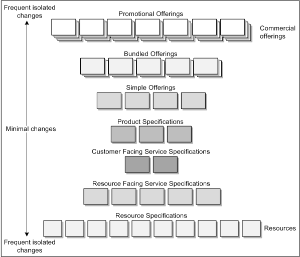

Managing Changes in Your Business
As a service provider, you need to manage changes in your service fulfillment implementation, for example, changes to product offerings, service configurations, and network resources.
By running OSM in the COM, SOM, and TOM roles, you can decouple your product offerings from your network resources, and minimize the changes required in order processing. For example:
  • Changes to product offerings do not change how resource-facing services are configured, and do not change how technical orders are processed. A change in how a product is packaged has no effect on how OSM manages the activation of the services in the offer.
  • Changes to how you implement your services on the network typically do not change your product offerings, unless you add resources for a new type of service. For example, you might make equipment-level changes to your network that require changes to technical orders. However, those changes do not affect how a customer order is processed.
Figure 6-5 shows how frequent changes occur at both ends of the process; to commercial offerings and to network resources. Changes occur less frequently in the middle of the process, where services are designed according to predefined models, and resources are assigned to the services.
In addition, whereas there are many commercial offerings and many network resources, there are considerably fewer service designs. A single service design can be used by many different commercial offerings and resources.
Figure 6-5 How Changes Occur in an Order Fulfillment Process
Description of Figure 6-5 follows
Description of "Figure 6-5 How Changes Occur in an Order Fulfillment Process"
Decoupling commercial offerings from network resources is important because system changes typically occur at both ends of the order fulfillment process. For example, when managing product offerings, you might introduce a new pricing for an existing service. When managing network resources, you might add more circuit capacity. These changes should have only minimal changes to an isolated part of the order fulfillment process.
The following are some typical scenarios that require changes to the order fulfillment process:
  • Change product offerings. Examples include: introduce a new pricing for an existing service, introduce a new product in an existing product family, introduce a new bundle of existing services. In this case, changes are usually required only in customer orders. No changes need to be made in the SOM and TOM processing.
  • Upgrade network elements to a new vendor. This requires new activation tasks to be able to send commands to the new network elements. Because there are no changes to the services offered, no changes need to be made to the order management process or to customer-facing services. The COM, SOM, and TOM processes remain the same. No changes are needed in product offerings or in the product specifications defined in OSM.
  • Introduce a variant to an existing technology. For example, you might introduce a VDSL option when ADSL is already available. In this case, you probably need to make changes to the definitions of resource-facing services, add resources to inventory, change some service activation tasks carried out by technical order management, and create new activation tasks. COM and SOM remain the same. No changes are needed in product offerings or in the product specifications defined in OSM.
