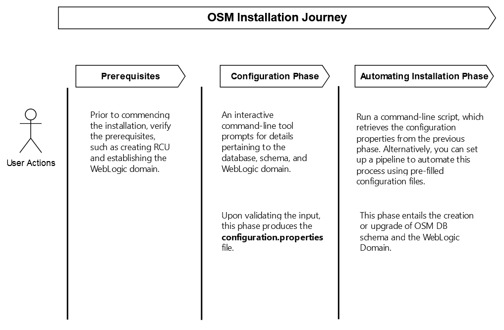

About the Installation Journey
The following image illustrates the installation journey.
Figure 6-1 OSM Installation Journey
Before installing OSM, read the following chapters:
