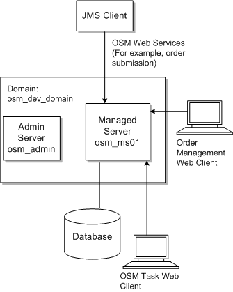

Figure C-1 shows a development system topology with one administration server, one managed server at the application server layer. The database layer contains a non-partitioned database. This OSM system can be deployed on a single Linux machine or VM.
Figure C-1 OSM Development System Topology
Description of Figure C-1 follows
Description of "Figure C-1 OSM Development System Topology"
