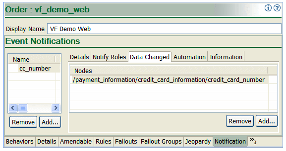

You can trigger an event notification when a change is made to order data. You typically use these notifications to update external systems (such as a CRM) with information about the progress of the order when a specific data element in the order data is changed. See "About Using Order Data Changes to Trigger Notifications" for more information.

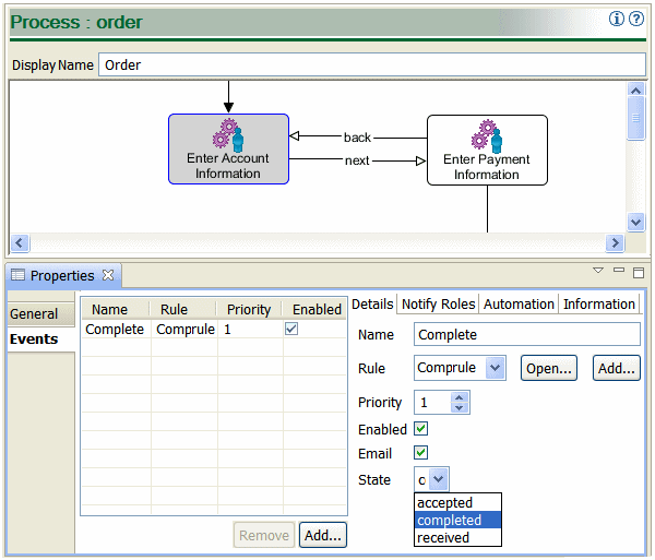

About Using Task States and Rules to Trigger Event Notifications
An event notification triggered by a task state change and rules works as follows:
When the task state changes to the state that you define for the notification, the notification runs a rule to evaluate if the conditions are true.
If the conditions are true, the event notification is triggered.
For example, you can specify that when the Completed task state is reached, a rule evaluates if the billing address is in California.
This type of notification does not apply to all instances of the task. It applies to a task only as it is used in a specific process. Therefore, you create this type of notification when you create processes in Design Studio. Figure 16-2 shows how to assign an event notification to a task in a process. In this figure, the EnterAccountInformation task is selected, and the rule and state are defined in the Properties window Events tab below.

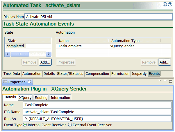

About Using Task States to Trigger Automated Event Notifications
You can use a task state to trigger an automated event notification. In this case, only the task state is evaluated (no rules are applied to evaluate a condition), and the notification triggers an automation plug-in which handles the notification actions. This type of notification runs for every instance of the task, independent of the process that it is in. Event notifications triggered by task states are not displayed in the Task web client.
For example, you can define an automated notification that sends a notification when the task reaches the Assigned state. The event notification works as follows:
When the task reaches the Assigned state, a notification is created.
When the notification is created, the automation plug-ins run.

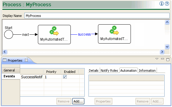

Figure 16-3 shows an event notification configured in Design Studio. Any time this task runs, the event notification is triggered when the task reaches the Completed state.
Figure 16-3 Event Notification Based on Task Status
Description of "Figure 16-3 Event Notification Based on Task Status"

You define event notifications based on order data changes when you create orders in Design Studio. For example, you can define an event notification that sends a notification when a telephone number is entered. Event notifications triggered by data changes are shown in the Task web client.
When you create an event notification based on order data changes, you can specify the data field that triggers the notification when the data is changed. Any change to the field causes the notification to trigger. However, this value is not evaluated for content. To trigger the notification based on the value of the data, you must configure a rule to evaluate it.
For example, to trigger a rule when the billing address is changed to California, you specify the billing address field as the field that triggers the notification and run a rule that evaluates if the address was changed to California.
You can specify an automation plug-in that the notification runs; however, an automation plug-in is not required.
Figure 16-5 shows an event notification based on data change in an order. In this example, when a credit card number changes, the notification is triggered.
Figure 16-5 Event Notification Based on Data Change in an Order
Description of "Figure 16-5 Event Notification Based on Data Change in an Order"
