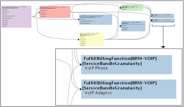

The inset in Figure 5-1 shows details for three executable order components, as displayed in the orchestration plan decomposition.
Figure 5-2 shows the orchestration plan displayed in the Order Management web client dependency graph. The dependency graph shows the executable order components which are the components shown in the final stage of the decomposition display. In this case, executable components are based on three orchestration stages corresponding to fulfillment function, fulfillment system, and processing granularity. The different colors represent fulfillment functions, such as InitiateBilling or FulfillBilling. The inset shows a detailed view of two order components. Even though the two fulfillment functions are targeted to the same system (BRM-VOIP), processing granularity rules defined for this order require that they take place as two separate actions.
Both of these representations are useful at design time and when debugging orchestration plans. For example, you can use the dependency graph to confirm that an order goes to all of the correct systems in the correct order. Use the decomposition tree to verify that decomposition happens as expected at a particular stage and that the order was decomposed into the correct components, each containing the correct order items.

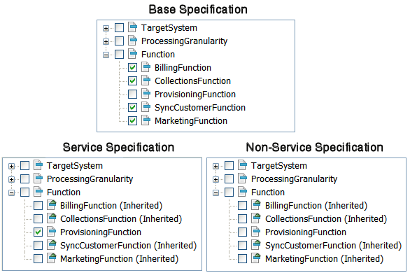

Each order item belongs to a product specification. A product specification is a group of related products that share common attributes. For example, the products Broadband Light, Broadband Medium, and Broadband Ultimate would all belong to the ServiceBroadBand product specification. OSM maps the product specification to a fulfillment pattern.

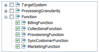

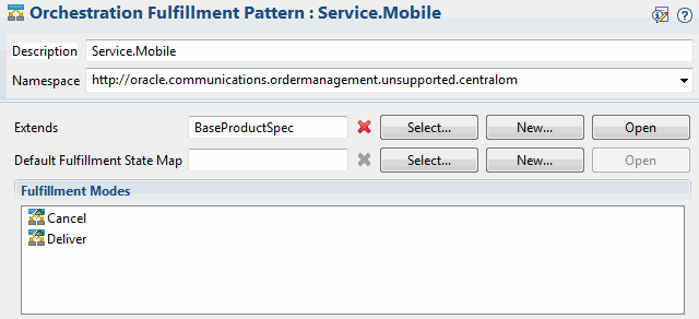

The fulfillment pattern manages the first stage of orchestration. It assigns order items to function order components in the first stage of orchestration. It also specifies the dependencies between the function order components. For example, the fulfillment pattern might specify to process function order components in this order:
ProvisioningFunction
BillingFunction
CollectionsFunction

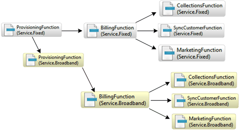

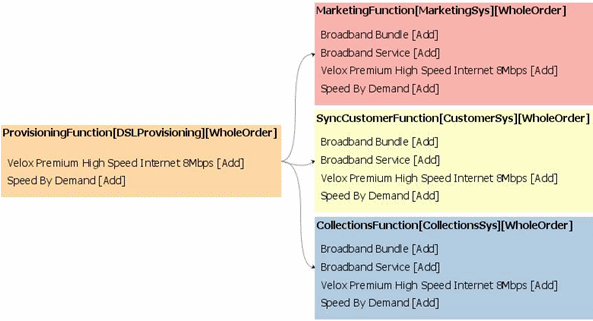

The fulfillment pattern also specifies the fulfillment mode that the order items can be used for. See "About Mapping Order Items to Fulfillment Patterns" for more information.

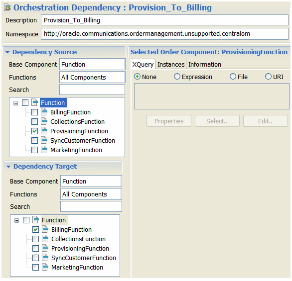

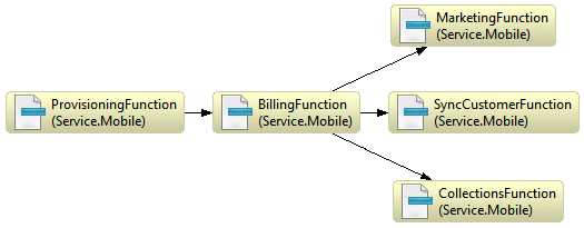

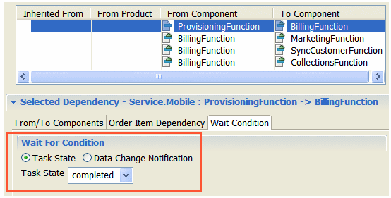

Provisioning must occur before billing, which must occur before marketing, customer updates (SyncCustomer), and collections.
Figure 5-4 Dependency Relationships for Order Item Dependency
Description of "Figure 5-4 Dependency Relationships for Order Item Dependency" -
After assigning order items to function components, OSM further decomposes the order into target system order components and granularity order components, following the specifications defined in the orchestration stages. See "About the Decomposition of Function to Target System Components" and "About the Decomposition of Target System to Granularity Components" for more information.
While decomposing the order, OSM finds dependencies between order components and generates an orchestration plan. Dependencies determine the order in which order components can be processed.

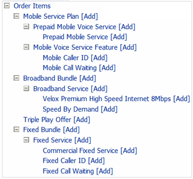

Figure 5-5 shows all of the order items derived from an order, including the order item shown in Example 5-1.
In Figure 5-5, notice that order items are hierarchical. For example, the Fixed Service order item shown in Example 5-1 is part of the Fixed Bundle order item. In addition, the Fixed Service order item includes three more order items: Commercial Fixed Service, Fixed Caller ID, and Fixed Call Waiting. When you model orchestration, you ensure that the hierarchy in the incoming customer order is duplicated in the OSM order items. See "Modeling Order Item Hierarchies" for more information.

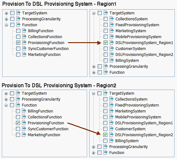

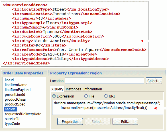

Figure 5-6 shows part of an order input file and how the city field is mapped to the region order item property in Design Studio. In this example, the <city> element in the XML file is used in the order item property expression.
See "About the Decomposition of Function to Target System Components" for an example of how the region order item property is used in orchestration.
Figure 5-6 Order Line and Definition in Order Item Specification

region: This property is an example of data that can be used to manage decomposition into target system order components. See "About the Decomposition of Function to Target System Components" for more information.

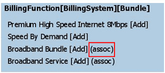

About Associated Order Items

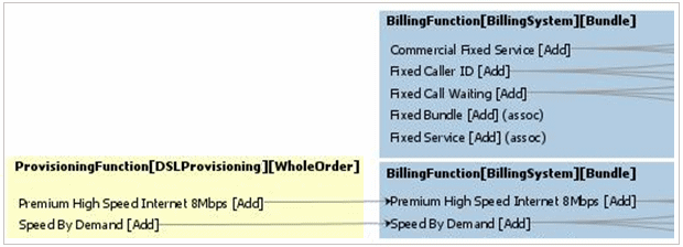

Figure 5-7 shows the associated order items, displayed with (assoc) in the orchestration plan.
Figure 5-7 Associated Order Items Displayed in the Order Management Web Client
Description of "Figure 5-7 Associated Order Items Displayed in the Order Management Web Client"
Caution:
Associated order items are not considered as part of the decomposition and dependency calculations when OSM generates an orchestration plan. Therefore, you cannot reference associated order items in decomposition or dependency rules.

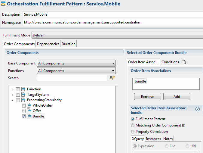

You model order item associations in fulfillment patterns. Figure 5-8 shows an order item association modeled for the Bundle order component in the Service.Mobile fulfillment pattern.
Figure 5-8 Order Item Associations in a Fulfillment Pattern
Description of "Figure 5-8 Order Item Associations in a Fulfillment Pattern"
There are three ways to associate order items:
Fulfillment pattern: This is the default entry. It associates order items by fulfillment pattern, which is the normal orchestration method.
Matching Order Component ID: This associates order items by matching component ID.
Property correlation: This associates order items by using order item properties. See "About Associating Order Items Using Property Correlations XQuery Expressions" for more information.

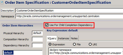

Order items can be organized hierarchically based on the content of the original customer order. You can configure OSM with the following types of order item hierarchies:
Physical Hierarchy: The hierarchy can include various types of order line items, such as offers, products, and bundles of products or services. For example, an order could include a Broadband-VoIP offer with a High Speed Internet bundle, an Internet Services service bundle, and a Wireless Router product item. OSM maintains the order line item hierarchy from the customer order in the order item hierarchy.
Composition Hierarchy: You can use composition hierarchies with fulfillment state composition rule sets to determine the parent/child relationship between order items so that OSM can determine aggregate fulfillment states for parent order items. See OSM Concepts for more information.
Dependency Hierarchy: You can specify a dependency hierarchy that OSM uses to automatically configure dependencies between order items on an order. For more information, see "About Processing Order Items Sequentially".
Figure 5-9 shows a physical order item hierarchy that reflects the structure of the original customer order.
The hierarchy is defined in the <lineID> and <parentLineId> elements. Figure 5-10 shows the first part of Figure 5-9, as it appears in an incoming customer order.
Figure 5-10 Item Hierarchies in an Incoming Customer Order
Description of "Figure 5-10 Item Hierarchies in an Incoming Customer Order"
To define the order item properties that specify the hierarchy, you configure the order item hierarchy in the order item specification using an XQuery expression. See "About Order Item Specification Order Item Hierarchy XQuery Expressions" for more information.

Fulfillment modes are configured in the following places:
Fulfillment mode entities: These entities include no data other than a name. They provide the means to assign fulfillment modes to other entities, such as orchestration sequences and fulfillment patterns.
Orchestration sequences define a single fulfillment mode using an XQuery expression based on a customer order attribute (see "About Order Sequence Fulfillment Mode XQuery Expressions").
Fulfillment patterns list the fulfillment modes that the associated order items can be used with.
Figure 5-11 shows the fulfillment modes defined in a fulfillment pattern. Any order item that uses this fulfillment pattern can be processed in either the Cancel or Deliver fulfillment mode.
Figure 5-11 Fulfillment Modes Defined in a Fulfillment Pattern
Description of "Figure 5-11 Fulfillment Modes Defined in a Fulfillment Pattern"
When a fulfillment pattern includes multiple fulfillment modes, you can model a different set of order components and dependencies for each fulfillment mode.

About Assigning Order Items to Fulfillment Pattern Function Components
The first step in decomposition is to assign order items to function components. To do so, OSM uses the product specification to find the fulfillment pattern that the order item uses. (See "About Mapping Order Items to Fulfillment Patterns" for more information.) The fulfillment pattern defines the order components to add the order item to.
Figure 5-12 shows the function order components selected in the Service.Broadband fulfillment pattern. In this case, order items that use this fulfillment pattern need all of the functions; billing, collections, provisioning, and so on.
Figure 5-12 Function Order Components Selected for a Service Fulfillment Pattern
Description of "Figure 5-12 Function Order Components Selected for a Service Fulfillment Pattern"
Figure 5-13 shows how to use a base specification to define the same function order components as described above. In this case, the base fulfillment pattern selects all of the function order components except provisioning. The service and non-service fulfillment patterns inherit the selections. The service fulfillment pattern adds the provisioning function. The non-service fulfillment pattern does not add it.
Figure 5-13 How to Use a Base Specification to Define Function Components
Description of "Figure 5-13 How to Use a Base Specification to Define Function Components"

A decomposition rule specifies a source order component and a target order component. Figure 5-14 shows a decomposition rule from the billing function component to the billing target system component.
About Decomposition Rule Conditions for Choosing a Target System
You can use decomposition rules to decompose order items from one function component to multiple target system components. Figure 5-15 shows the source and target order components for two decomposition rules:
Provision to DSL Provisioning System - Region1
Provision to DSL Provisioning System - Region2
These two decomposition rules decompose the order items in the ProvisioningFunction order component into two target system order components based on Region 1 and Region 2.
Figure 5-15 Source and Target Order Components for Two Decomposition Rules
Description of "Figure 5-15 Source and Target Order Components for Two Decomposition Rules"
Each of the decomposition rules uses decomposition conditions to specify which target system to use for a particular order. The target system is selected if the XQuery expression associated with the condition evaluate to true. In this example, the XQuery expression uses the value of the region order item property to make this evaluation. If the value of region is Toronto, then OSM selects the condition and target system for Region 1. If the value of region is New York, then OSM selects the condition and target system for Region 2. See "About Order Item Specification Condition XQuery Expressions" for more information about creating an XQuery condition expression that can be used for with a decomposition rule.

About the Granularity Components Stage
In addition to creating the decomposition rules that define the source and target components, you need to create an orchestration stage that produces the granularity order components.
Summary of Configuring Granularity Components Decomposition
To summarize, to model the decomposition from a target system order component to a bundle order component, you model the following:
The decomposition rule, which decomposes the target system order component into bundle granularity components
The orchestration stage that produces the bundle order component
The order item hierarchy that the XQuery ancestors function uses in the order item specification
The XQuery for the customized order component in the bundle order component specification

Figure 5-16 shows order items displayed in the Order Management web client. In this example, the billing order items for a fixed service can start immediately because they have no dependencies. The billing order items for high-speed Internet must wait until the provisioning order items have completed.
Figure 5-16 Dependencies Displayed in the Order Management Web Client
Description of "Figure 5-16 Dependencies Displayed in the Order Management Web Client"

Figure 5-17 shows a dependency relationships. Note the two layers of dependency: billing is dependent on provisioning, and everything else is dependent on billing.
Figure 5-17 Dependency Relationships for Order Item Dependency
Description of "Figure 5-17 Dependency Relationships for Order Item Dependency"
In addition to defining the function order components, you need to define the conditions that govern the dependency. The default condition is to wait until the final task associated with the order item has completed. Figure 5-18 shows a wait condition defined in Design Studio. In this case, the waiting order item must wait until the blocking order item task has reached the Completed state. See "About Order Item Dependency Wait Conditions" for more information.
Figure 5-18 Wait Condition in Design Studio
Description of "Figure 5-18 Wait Condition in Design Studio"
Dependency wait conditions specify the condition that the blocking order item must be in before the waiting order item can start. For example, the default wait condition is to start the waiting order item when the last task associated with the blocking order item reaches the Completed state.
You specify wait conditions in fulfillment patterns and orchestration dependencies. You can set different wait conditions for each dependency. The wait conditions can be:

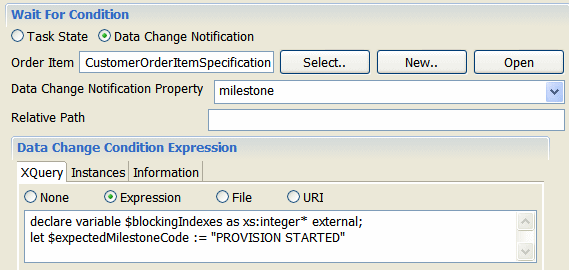

About Order Item Dependency Wait Conditions Based on Data Changes
You can base a dependency on a change to data. The data must be included in an order item property, and it must be in the task data of the task associated with the blocking order item.
To configure the dependency, you define the following:
The order item property that is evaluated. Any change to the data in the order item property triggers an evaluation of the data to determine if it matches the conditions required for the dependency.
An XQuery expression that evaluates the data retrieved from the blocking order item. The expression returns true or false; if true, the dependency has been met.
Figure 5-19 shows a data change dependency in Design Studio.
Figure 5-19 Data Change Dependency in Design Studio
Description of "Figure 5-19 Data Change Dependency in Design Studio"
In Figure 5-19:
The Order Item field specifies the order item specification to use.
The order item property that the dependency is based on is milestone.
The Relative Path field (not used in this example) is an optional field you can use to specify a child data element in the order item properties.
The XQuery expression evaluates the data in the milestone property to determine if the dependency has been met. See "About Order Data Change Wait Condition XQuery Expressions" for more information.

Figure 5-21 shows the dependency relationships shown in Figure 5-20. Note that fixed provisioning is the blocker for broadband provisioning and for fixed billing.
Figure 5-21 Dependency Relationships for Fulfillment Pattern Dependency
Description of "Figure 5-21 Dependency Relationships for Fulfillment Pattern Dependency"

OSM is able to create dependencies at run time by inferring dependencies. For example, you might create this series of dependencies:
Provisioning - Billing - Marketing
If the order item has no billing function, there is an inferred dependency between Provisioning and Marketing, even though you have not modeled that dependency. Provisioning must complete before Marketing can start.
Inferred dependencies mean that whenever A is dependent on B and B is dependent on C, A is dependent on C. This avoids the need to model every dependency that might be possible.
Figure 5-22 shows a sample dependency configuration. Figure 5-23 shows the run-time view of the same configuration when there is no billing function. In this case, the Order Management web client shows dependencies from provisioning to marketing, synchronize customer, and collections.
Figure 5-23 Inferred Dependencies at Run Time
Description of "Figure 5-23 Inferred Dependencies at Run Time"
Inferred dependencies are supported within a fulfillment pattern, but they are not supported across fulfillment patterns. For example, OSM does not infer a dependency from ProvisioningFunction(Service.Fixed) to BillingFunction(Service.Broadband). You must specifically model that dependency.
About Modeling Orchestration Dependencies
You use orchestration dependencies to create dependencies between order components that are not based on fulfillment patterns. For example, if you need to define a generic dependency or want to model one without having to modify a fulfillment pattern, you can use an orchestration dependency specification.
As with dependencies defined in fulfillment patterns, you can specify wait conditions and the type of order item dependency (for example, order item, fulfillment pattern, and property correlation).

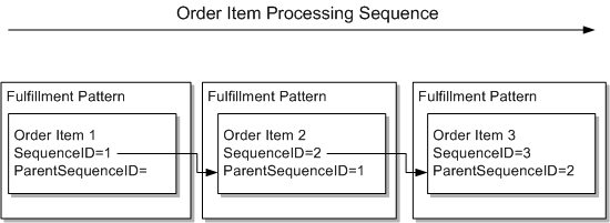

You can enable order items to process sequentially at run-time by setting an order item dependency hierarchy in the order item specification editor Order Item Hierarchies tab. When you model order items to run sequentially, avoid creating circular dependencies by ensuring that you do not include order items with a predecessor successor relationship into the same order component.
For example, you can ensure that only one order item processes at a time by configuring the orchestration granularity for a component to process only one order item at a time. Or you could also set the granularity for a component to process only a bundle of order items at a time. For example, between a bundle for VoIP and another bundle for Broadband. If parameters designating the successor predecessor relationship always establish a relationship between order items across two different bundles, then you avoid circular dependencies in this way as well.
Figure 5-24 shows how order items can be configured to process sequentially based on two order item properties defined in an order item specification order item hierarchy. You can use any order item property, so long as you can use the properties to establish the predecessor and successor relationship.
Figure 5-24 Order Item Processing Sequence
Description of "Figure 5-24 Order Item Processing Sequence"

You can create inter-order dependencies that involve order item hierarchies. For example, you can specify that the blocking order item include all of the order items in its hierarchy. To do so, you select the child completion dependency when specifying an order item hierarchy (see Figure 5-25). For more information about order item hierarchies, see "Modeling Order Item Hierarchies").
Figure 5-25 Use for Child Completion Dependency Selected in Design Studio
Description of "Figure 5-25 Use for Child Completion Dependency Selected in Design Studio"
Figure 5-26 shows an orchestration dependency in Design Studio.
Figure 5-26 Orchestration Dependency in Design Studio
Description of "Figure 5-26 Orchestration Dependency in Design Studio"
