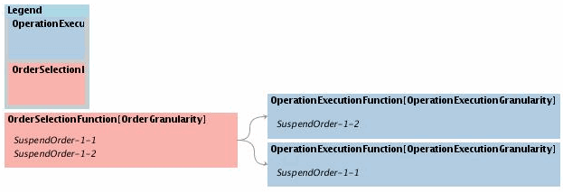

  4. In the Concurrent Operations Among Orders field, specify the number of executable components created for each action in the job. If specified, this value overrides the default value of 1. For example, if you select four orders with a suspend order action and configured the concurrent orders field with a value of 2, then OSM generates two executable order components that run in parallel as illustrated in Figure 5-1. Each order component would process two of the four orders.
    Figure 5-1 Job Control Order with 2 Concurrent Orders
    Description of Figure 5-1 follows
    Description of "Figure 5-1 Job Control Order with 2 Concurrent Orders"

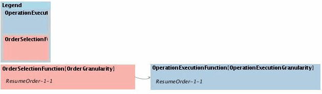

    In the same way, if you select the same four suspended orders with a resume action and configured the concurrent orders field with a value of 1, then OSM generates one executable order component that runs the resume action on all four orders, one after the other, based on the sequence in which the orders were selected (see Figure 5-2).
    Figure 5-2 Job Control Order with 1 Concurrent Order
    Description of Figure 5-2 follows
    Description of "Figure 5-2 Job Control Order with 1 Concurrent Order"
