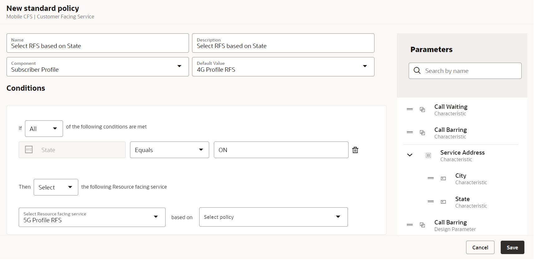

- Design Parameters: Configure the design parameters for the CFS using the existing data elements or create new data elements. Design parameters are carried from the upstream order management systems and you define them in the CFS. See "Defining Design Parameters" for details on how to define design parameters.
- Entity Characteristics: Configure the characteristics for the CFS using the existing data elements or create new data elements. Data elements are added as characteristics to realize them in UIM run-time environment. See "Defining Entity Characteristics" for details on how to define entity characteristics.
- Parameter Mapping: Configure the mapping of the design parameters from upstream systems to characteristics in the downstream systems such as UIM and between the child specifications. See "Mapping Design Parameters" for details on parameter mapping.
- Design Policies: Configure the design policies to provision the services in UIM. UIM provisions the service based on the defined design policies. See "Defining Design Policies" for details on defining design policies.
Standard Policies for Specification Selection: Define the standard policies within Solution Designer for designing and assigning specification based on the design parameters or characteristics. These are simple policies that have if-then conditions. In the Mobile Service example, if the State is ON; then select the 5G Profile RFS else select the 4G Profile RFS. As another example, based on Service Address, reserve and assign the phone numbers from the range in the inventory.
Standard Policies for Naming: Define the standard policies within Solution Designer for naming policies, when a specification instance is created in the run-time application. You can define a naming policy based on the design parameter, ID, string, or combination of them. The naming policy is applicable only for resource specifications.
Advanced Policies: Define advanced policies in Solution Designer. A developer implements the advanced policies in Design Studio Eclipse environment using the extended designer class. Solution Designer builds the solution with standard policies and advanced policies. In the Mobile Service example, select UDR in the same State as the 5G Profile RFS is an advanced policy.
Defining Standard Policies
To define a standard policy:
In the Solution Designer landing page, click the application that you want to work with.
Do one of the following:
In Specifications applications, search and open the specification editor page and click the Design Policies tab.

In Design Policies tab, click the + drop-down and select Standard policy.
The New standard policy page opens.
- If you are creating a standard policy for a resource specification,
select Specification selection as the Standard policy type.
Enter the name, description, component, and default value. The Component drop-down lists only those components that are related to the selected specification. The then part of the condition is displayed based on the component that you select. If you select an RFS component, the Then clause is displayed with RFS. The Default Value drop-down lists the specifications that are related to the component that was selected in the Component drop-down.
In the Conditions section, do the following:
Drag and drop the design parameters and the characteristics from the Parameters panel on the right. The Parameters panel displays the design parameters and characteristics for that specification and also from its child specifications.
Figure 5-1 illustrates the New standard policy page.
- Select the operator from the available operators. The available operators are Contains, Equals, Not equals, Equal ignore case, Contains ignore case, and Not equal ignore case.
Select or enter a value in the Select Value field that must be validated with the actual value. Select a value if you have to defined valid values for the parameters or enter a value if you do not have valid values defined for design parameters.
- In the Then drop-down, select the option Create or
Select. Create option creates the selected specification at
runtime. Select option selects the specification based on the selected
advanced policy in the Select policy drop-down at runtime.
When you select the option Select in the Then drop-down, that standard policy must have a corresponding advanced policy to select the entity. - Click Add New Group to add more conditions and repeat steps 5 and 6.
- Click Save.
The standard policy is listed in the Design Policies page.
