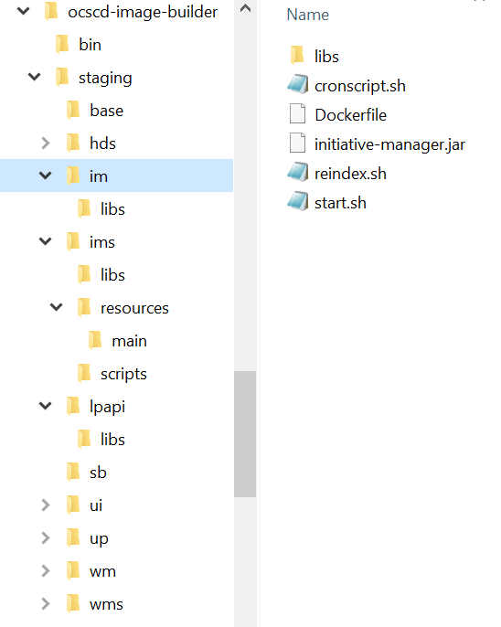

The staging directory structure contains the files for the microservices. Each directory structure contains a Dockerfile and the contents of the container image. Figure 3-1 illustrates the staging directory structure.
