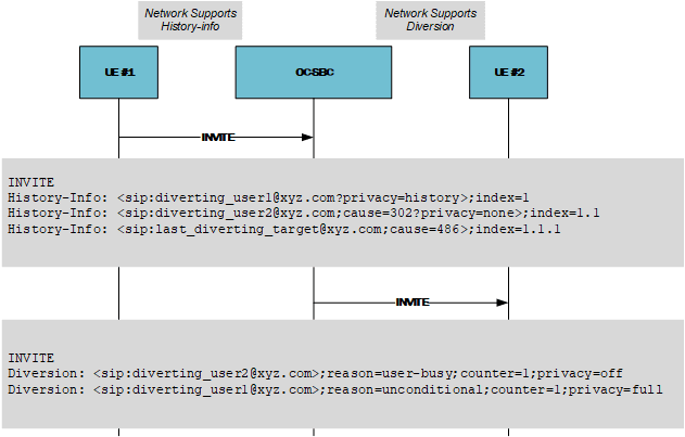

History-Info to Diversion Header Interworking
When configured for this interworking, for any malformed or corrupted History-Info headers in the incoming initial INVITE, the SBC does not perform interworking and includes the unchanged History-Info headers on the outgoing INVITE.
For all correctly formed History-Info headers in the incoming initial INVITE, except the last, the SBC takes the following steps:
  1. Create a new diversion header.
  2. If there is a subsequent HI header, extract the cause parameter, map it to the corresponding reason parameter, and add this reason parameter to the interworked Diversion header, using the following conversion table.
    History-Info Cause Diversion Reason
    404 Unknown (default value)
    302 unconditional
    486 user-busy
    408 no-answer
    480 deflection
    487 deflection
    503 unavailable
  3. If an HI entry includes a cause that is not in the list of valid causes, per RFC 7544, use the default value Unknown for the reason parameter.
  4. If the History-Info header contains a privacy parameter, add a Privacy parameter to the Diversion header, using the following conversion table.
    History-Info Privacy Diversion Privacy
    history full
    Field absent or none Off (default value)
  5. If there is no privacy parameter, use the default value Off in the Diversion header.
  6. Add a counter parameter with the value 1.
  7. Delete the History-Info header.
The diagram below provides an example flow and the header text used for this example.
This call flow displays an example of history-info to diversion header interworking.

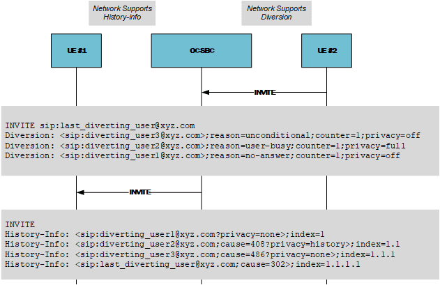

Diversion to History-Info Header Interworking
When configured for this interworking, for any malformed or corrupted Diversion headers in the incoming initial INVITE, the SBC does not perform interworking and includes the unchanged Diversion headers on the outgoing INVITE.
For correctly formed Diversion headers in the incoming initial INVITE, the SBC takes the following steps:
  1. Create a new History-Info header.
  2. Add the index header parameter.
  3. Set the value for the first header to 1. Append .1 to the value of the last_index_value for the subsequent headers.
  4. If the Diversion header contains a privacy parameter, add the Privacy header parameter to the History-Info header using the following conversion table.
    Diversion Privacy History-Info Privacy
    full history
    name history
    uri history
    off none
  5. If the previous Diversion header contains a reason parameter, add the cause header parameter to the History-Info header using the following conversion table. The SBC does not add a cause parameter to the first History-info entry.
    Diversion Reason History-Info Cause
    unknown 404 (default value)
    unconditional 302
    user-busy 486
    no-answer 408
    deflection 480
    unavailable 404
    time-of-day 404
    do-not-disturb 404
    follow-me 404
    out-of-service 404
    away 404
  6. If the presented reason parameter is not in the table above, set the parameter to the default value of 404.
  7. Remove the diversion header from the outgoing INVITE.
This call flow displays an example of diversion to history-info header interworking.
