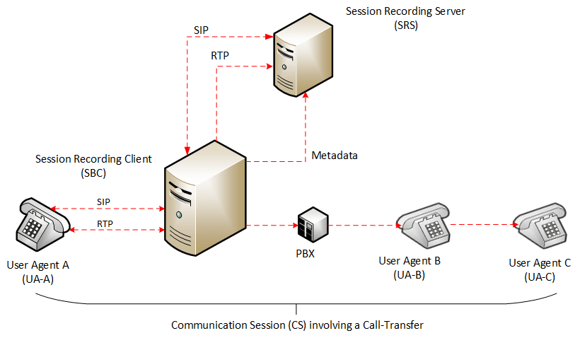

Session Recording Server (SRS)
The Oracle Communications Interactive Session Recorder’s RSS acts as the SRS in the network. A session-recording-server attribute under the session-router element in the SBC ACLI allows you to enable or disable the SRS. This object is the session recording server that receives replicated media and records signaling. Additional parameters for SRS may be configured under session-agent, realm-config, or sip-interface. Attributes in the session-agent element take precedence over attributes in realm-config element, which in turn take precedence over attributes in the sip-interface element.
Each SRS is associated with a realm-config. The realm specifies the source interface from which replicated traffic originates. The destination is an IP Port parameter (IP address or hostname with an optional port) that defines the SIP address (request URI) of the actual SRS.
If you have an HMR manipulation applied to a session-agent, your manipulations will not be applied to messages sent to the SRS server. To capture the modified messages, you can apply your HMR manipulations to a realm or SIP interface that includes both your session agent and your SRS.
For an additional level of security, Oracle recommends the SRS be configured in its own realm so as to apply a set of access control lists (ACLs) and security for the replicated communication. Although the SBC supports large UDP packets, Oracle recommends the sip-interface associated with the SRS realm, be provisioned with a TCP port.
Enforcing Parity Check on Media Port Numbers with the SRS

Session Recording Group
The Oracle Communications Session Border Controller uses the session-recording-group attribute under the session-router object in the ACLI to set high availability (HA) for 3rd party call recorders. Using this object, you can define a collection of one or more SRSs. The Oracle Communications Session Border Controller utilizes SIP’s transport mechanism and keeps track of statistics on each SRS to manage the distribution of traffic and load balancing. (For more information on Oracle Communications Session Border Controller load balancing in session recording groups, see Load Balancing). When multiple SRSs are in a session recording group, the Oracle Communications Session Border Controller uses heuristics to intelligently route the recording dialog to one or more SRSs utilizing the selection strategy.
The simultaneous-recording-servers configuration attribute controls the number of simultaneous SIP dialogs that the Oracle Communications Session Border Controller establishes to the SRSs in the session recording group per communication session. For instance, if a session recording group contains 3 SRSs, and simultaneous-recording-servers is set to 2, the recording agent initiates a SIP INVITE to the next two SRSs based on the session recording group strategy. In this way, duplicative recording sessions are instantiated, allowing for recording redundancy in multiple SRSs or within a session recording group.
The Oracle Communications Session Border Controller streams media to all SRSs. Each SRS chooses whether or not to ignore the media by returning a recvonly(receive only) media line. This permits an SRS to select specific media to record in the recording session, as well as determine whether or not to record the media.
The number of simultaneous recording servers does not dictate the number of recording devices required to be active for a communication session. If two SRSs exist in a session recording group and simultaneous-recording-servers is set to 2, if at least one recording device to any of the servers completes, the recording server is treated as being established.

Session Recording Group within Logical Remote Entities
Each logical remote entity (session-agent, realm-config and sip-interface) has a session-recording-server attribute. This attribute is a reference to a specific SRS configuration and can be used to specify a session recording group instead. If a session recording group is specified instead of an SRS, the session recording group name must be prefixed with "SRG:" followed by the session recording group name. This distinguishes between an SRS being referenced and a session recording group being referenced.
With SIPREC, if an SRS or session recording group is configured on both the ingress and egress logical remote entities, both the ingress and egress SRS/session recording groups are used. This means that the SBC records the media between participants twice (or more) - once for the ingress recorders and once for the egress recorders.
If both the ingress and egress SRS/session recording group are the same, the SBC makes an optimization and only records the media once. Even if the ingress session recording group is the same exact set of SRSs as the egress session recording group (but with a different name), the SBC replicates media to both destinations. However, if the same set of SRSs has the exact same identifier, the
SBC sends media to one and not both SRSs.

P-Asserted Identity and Diversion Headers in SIPREC Metadata
The Oracle Communications Session Border Controller supports some call transfer scenarios in which the contents of the P-Asserted-Identity, Diversion and History-info headers must be included in the SIPREC metadata for in-dialog requests (re-INVITE and UPDATE) as well as initial requests.
During a Communication Session (CS) between user-agents, Oracle Communications Session Border Controllerupdates the SRS, for in-dialog requests like Re-INVITE and UPDATE, in the Recording Session (RS). In call transfer scenarios, the participant information available in the headers is updated in the extension data under SIPREC Metadata. When the option disable-re-invite-on-update is configured in the session-agent, sip-interface, or real-config configuration elements, the SBC restricts the Re-INVITE to RS for the in-dialog UPDATE in CS.
You will have to configure the system with the SipHeaderExtensionMetadata.spl (SBC Processing Language) plugin for the disable-re-invite-on-update option to work. For more information, see Inserting SIP headers into SIPREC Metadata.
Consider a call transfer scenario between User Agent A (UA-A) and User Agent C (UA-C). The session will be recorded by Oracle Communications Session Border Controlleracting as an SRC and an SRS. The SRS does not record the session with User Agent B. In order to record the session between UA-A and UA-C it is vital to correctly identify the User Agents in the session. The system uses the headers in the metadata to reflect the identities of the participating agents.
This image depicts the use of metadata in support of SIPREC.
The header information such as P-Asserted Identity, Diversion and History-info for INVITE/Re-INVITE and UPDATE cases will be updated in the extension data of participant xml element.
You can configure the option disable-re-invite-on-update to stop the Re-INVITE requests towards the Recording Session (RS) for any in-dialog UPDATE in Communication Session (CS). This option can be configured under a specified sip-interface , realm-config , or a session-agent .
ORACLE#(session-agent) options +disable-re-invite-on-update
Session-agent takes precedence over realm-config, and realm-config takes precedence over sip-interface.
