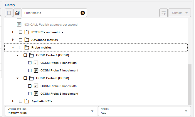

There are two KPIs that are associated with each added probe:
Bandwidth, which is the amount of traffic, both forwarded by the probe in bits/second. Includes signal and also voice if it was recorded and forwarded to the Mediation Engine (ME).
Impairment, which is a Boolean value. Has the value of 1 for each minute that a problem has been detected with the probe. For more information on the problem the system log should be consulted.
Probe metrics are shown in the KPI/Metrics page, inside its own folder, as shown.
Figure 7-4 Library View of the Probe metrics FolderMetrics

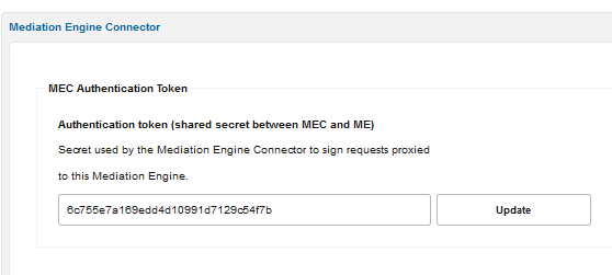

Mediation Engine Connector
If Operations Monitor installation has been configured to use a Mediation Engine Connector, the authentication token, which this Mediation Engine uses to authenticate itself to the Mediation Engine Connector, can be configured on this page as shown here:
Figure 7-5 Authentication Token Configuration
To configure Mediation Engine Connector:
Log into Operation Monitor.
Click Admin and then click Settings.
Click Network.
Click Mediation Engine Connector.
In the Authentication Token field, enter your choice of token details for the Mediation Engine, and click Update.
Result: Mediation Engine connects with the Mediation Engine Connector.
You must note down the token details for future reference.
(Optional) Perform the following steps if you have disabled the Mediation Engine.
Log into Mediation Engine.
Under Settings, click ME Management.
Select the node and double-click the disabled column field select yes from the drop-down list.
If a node is marked as Disabled, the devices do not propagate to other Mediation Engines and the other Mediation Engine Connector controlled node Mediation Engines do not query for retrieving information about calls.
Click Save.
Result: Mediation Engine is added.
