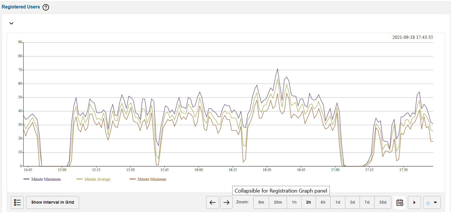

Registered Users Panel
The top panel contains a chart that traces the total number of registered users over time. The sampling interval is 1 minute for drawing the sample's minimum, maximum, and average values.
By default, a window of three hours is presented. The time frame can be adjusted and the chart allows for panning. For more information on using charts, see " Charts ".
Figure 4-48 Registered Users Panel While Dragging Time Window
If Operations Monitor has no registration information over a period of time (due to factors like recent start up, downtime, or lack of traffic), that interval is indicated in the chart by a gray area.Registrations Table

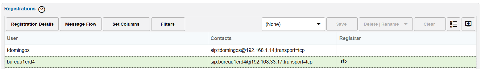

The Registrations panel contains a table of the registrations events, grouped by SIP user. The list is ordered chronologically, presenting the latest event as the first entry by default. The table can be resorted and/or filtered. For more information, see "Filtering".
If the system setting Group New Registrations from the Same User is true, duplicate registration events in state 'New' from the same users are grouped together. However, since the grouping is done on each requested chunk, duplication removal over different chunks does not work.
Table 4-11 lists the column descriptions for the Registrations table:

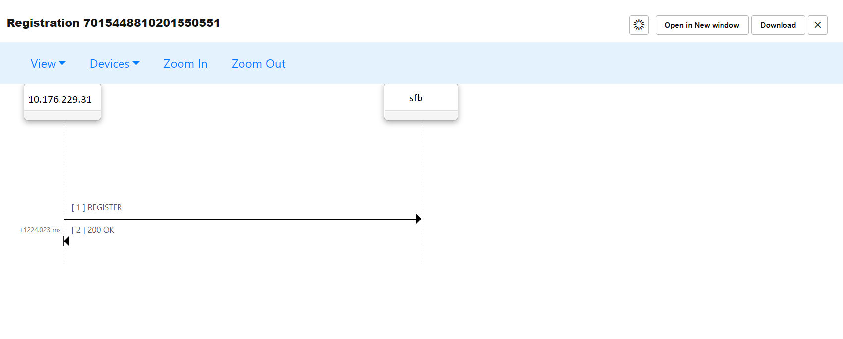

Click the Message flow button to open a SIP message flow diagram window that depicts the network entities involved and message exchange of the registration event.

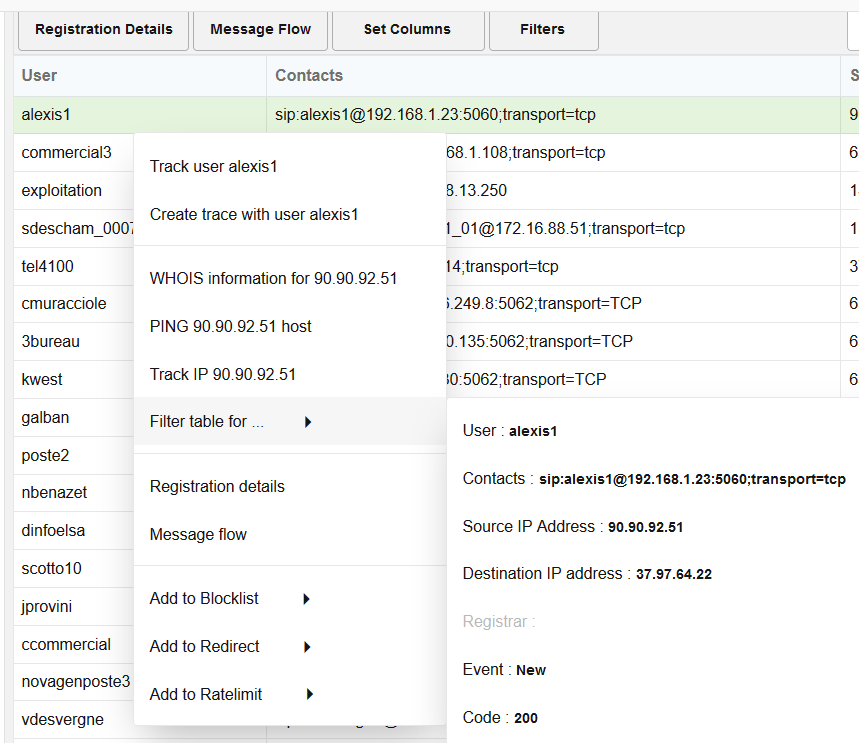

Many of these actions are available by right-clicking on a row.
Right-Click Contextual Menu - Registrations
Right-click menu actions are as follows:
Table 4-12 Right-click menu options
| Menu option | Description |
| Track user <user name> | Loads the User Tracking page with the User field pre-filled in the search panel taken from the event |
| Create Trace with user <user name> | Loads the Traces page with the User field pre-filled with the value taken from the corresponding registration event. |
| WHOIS | Allows you to inquire who is the owner of the IP used as the source of the registration. A window appears that contains the record stored into the WHOIS database for the given address |
| PING | Pings the source IP address. |
| Track IP | Redirects you to the IP tracking page to get the details about the specific IP. For more information, see IP Tracking |
| Filter Table for... | Filter table for ... allows you to filter for:
| Registration Details | Opens the Registration Details window |
| Message Flow | Opens the Message Flow window |
| Add to Blocklist | Adds user to the Blocklist. |
| Add to Redirect | Adds user to the Redirect list |
| Add to Ratelimit | Adds user to the Ratelimit list |

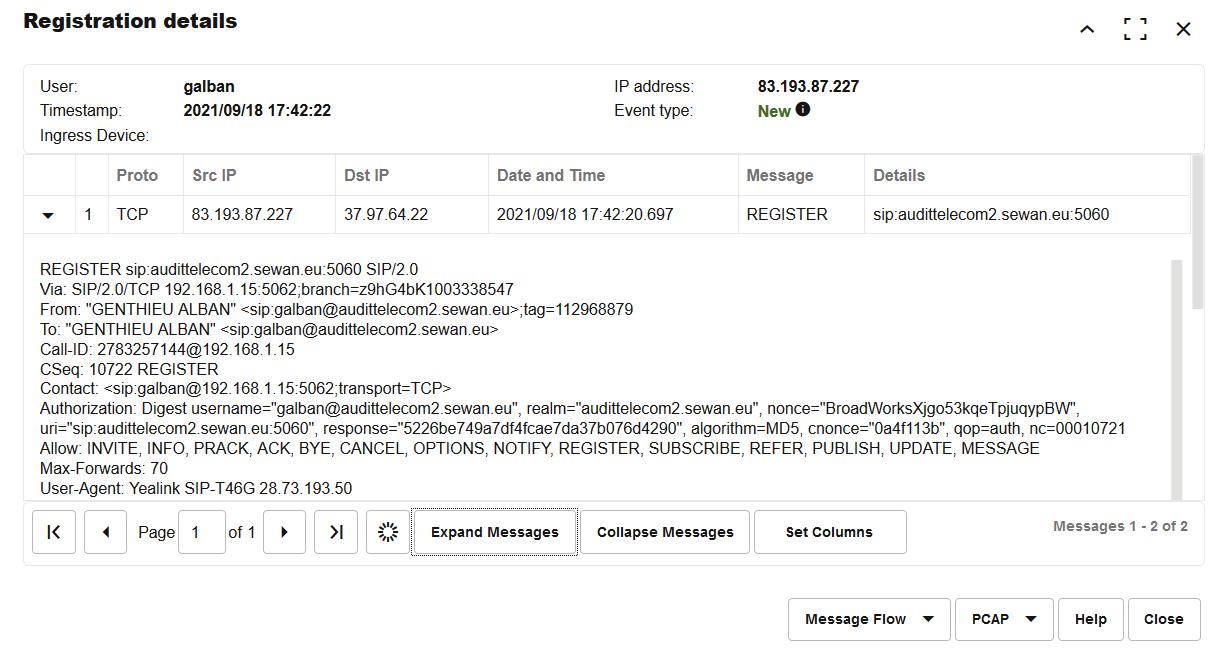

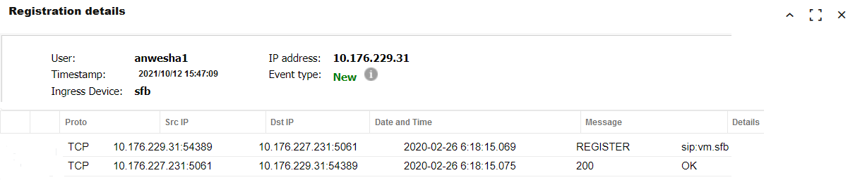

The details window for a registration event contains the following information:
The user of full AOR (subjected to settings).
The timestamp when the event occurred.
The network entity of the platform having received the registration request (the ingress device).
The IP address used to originate the requests.
The type of registration event.
A table that contains details about the exchanged messages in this event, listed in chronological order.
The table lists the columns in Registration Details window.
Table 4-13 Registration Details Window
| Column | Description |
Proto |
The network transport protocol used to carry the SIP messages from client to the platform. This field can be either UDP or TCP. |
Src IP |
The IP address of the device that generated the message; can be either the client's or one of platform boxes, depending on the direction. |
Dst IP |
The IP address of the device that received the message; just as with Source, it can be either the client's or platform's. |
Date and Time |
The moment in time when the mirrored network packet was received by Operations Monitor. |
| Message | SIP message which caused the particular event |
| Details | Details about a event. |
Registration Details Actions
In the Registration Details window, Click Expand messages to view all the raw SIP message as seen on the network. You can click Collapse Messages to display the brief view of the messages.
You can view one raw message at a time by clicking the Triangle button on any of the table's entries, as shown.Figure 4-52 Registration Details Window with One Expanded Raw Message
Beside the Help and Close buttons, the details window contains a Message flow button and a PCAP button. The Message flow button creates a SIP message flow diagram, and the PCAP button allows you to save the shown network packets into a PCAP file.
