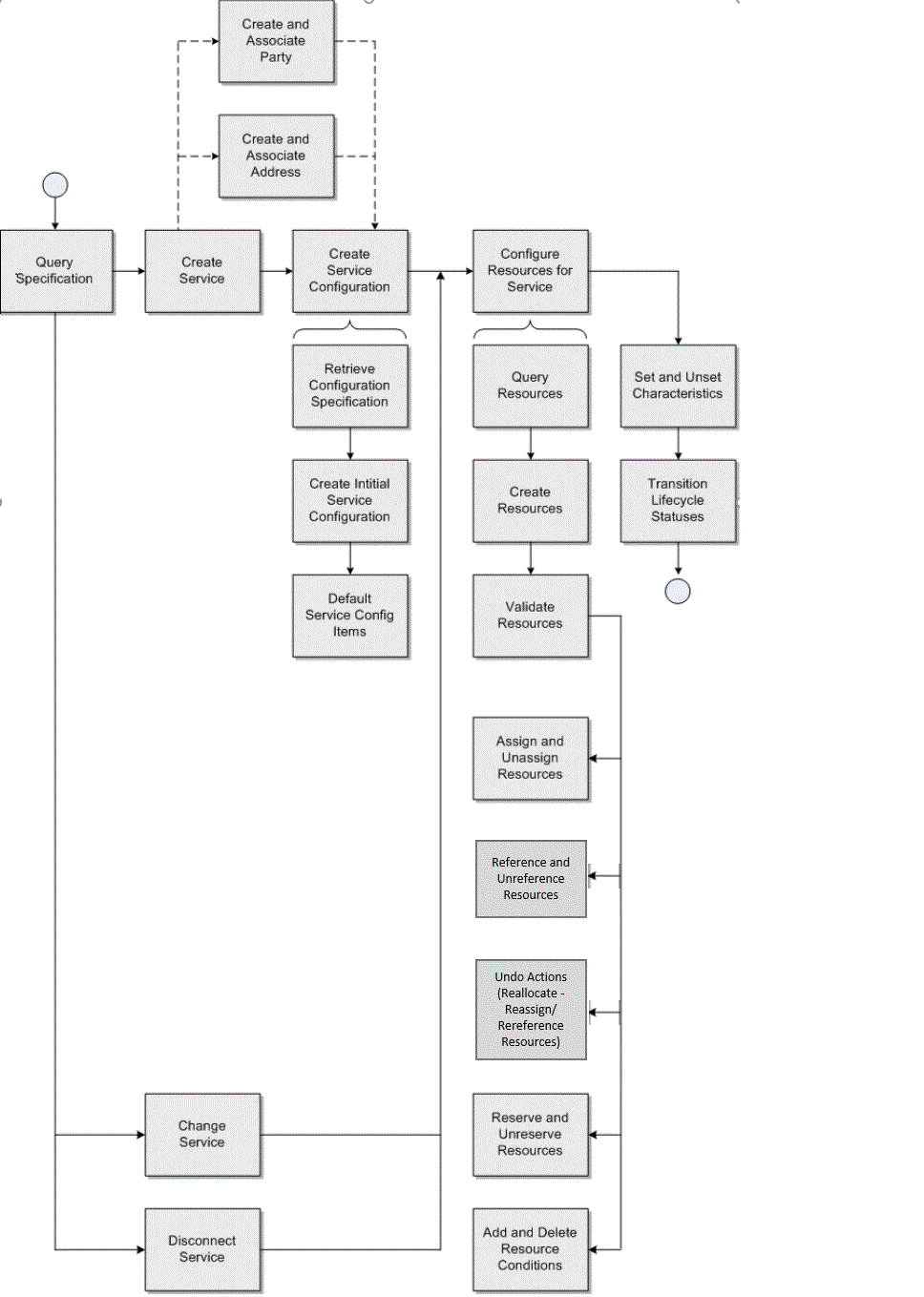

Figure 3-1 shows the process flow for a generic service fulfillment scenario:
Figure 3-1 Process Flow of Generic Service Fulfillment Scenario
Description of "Figure 3-1 Process Flow of Generic Service Fulfillment Scenario"
The process flow begins with querying for the service specification, which is used in subsequent steps in the process flow, such as creating the Service and searching for resources.
The process flow continues with creating the service, based upon the retrieved service specification.
Next is creating the service configuration, which involves querying for the service configuration specification, creating the service configuration based upon the retrieved service configuration specification, and any creating default service configuration items.
The process flow continues with the optional steps of creating additional entities, such as Party and Geographic Address (a concrete Geographic Place entity representing a Service Address). These entities are created and associated to the Service with specific inventory roles.
Next in the process flow is configuring the resources for the service (resource management), which involves querying for resources based on specific criteria using core API searches or using custom searches. For example, you can call an API directly to search for a Custom Object by ID, or you can call a custom API to search for a Custom Object by its association to an Inventory Group or association to another Custom Object. You can also create resources for immediate assignment to the service. The main goal of resource management is to retrieve and validate the correct resources for assignment to the service. However, you can also manage the resources with alternate flows, such as creating reservations and conditions. Assignments, references, reservations, and conditions are the main consumption concepts for a given resource.
In addition to resource assignments and references, the service and service configuration also have characteristic values. These values are used to setup and configure the service instance.
After the service has been configured through resource and characteristic value assignments, the process flow continues with transitioning the lifecycle status of various entities. APIs are presented to show the transition of the statuses, and how the statuses are managed within the core API functionality.
The process flow shown in Figure 3-1 shows the initial creation of the service, and also shows other scenarios, such as changing the service configuration and disconnecting the service. These additional scenarios are also described.

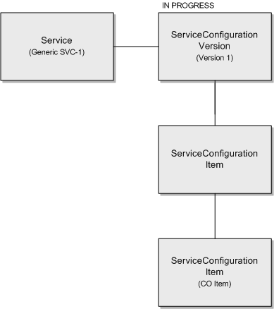

This section describes the UIM API methods used to create the service and service configuration, and to create default configuration items on the service configuration. The API methods are listed in the order in which they must be called.
Figure 3-2 shows the generic service configuration specification used in the generic service fulfillment scenario:
Figure 3-2 Generic Service Configuration Specification Example
Description of "Figure 3-2 Generic Service Configuration Specification Example"

}Finding the Current Service Configuration Version
To find the current service configuration version:
Find the service. See "Finding the Service".
Select the service configuration versions using service.getConfigurations().
Process the retrieved service configuration versions, looking for one with a configState of IN_PROGRESS, DESIGNED or ISSUED.
There will only be one service configuration version in one of these states at a given point in time for a service. If a service configuration version is not found in one of these states, you cannot proceed with resource assignment.
In the generic service fulfillment scenario, Version 1 would be selected.
Example 3-18 Finding the Current Service Configuration Version
InventoryConfigurationVersion invConfigVersion = null;
ServiceConfigurationManager scm = PersistenceHelper.makeServiceConfigurationManager();
BusinessInteractionState configState = BusinessInteractionState.IN_PROGRESS;
/*similarly, other BusinessInteractionStates (COMPLETED, CANCELLED) can also be passed as parameter*/
List<InventoryConfigurationVersion> configs = scm.getEntityConfigurationVersions(configurable, configState);
InventoryConfigurationVersion latestConfig = null;
if (!Utils.isEmpty(configs)) {
invConfigVersion = configs.get(0);
ServiceConfigurationVersion scv = (ServiceConfigurationVersion) invConfigVersion;Finding the Service Configuration Item
To find the service configuration item:
Find the current service configuration version. See "Finding the Current Service Configuration Version".
Select the service configuration items using service.getConfigItems().
Process the retrieved service configuration items, looking for one with the configType of ITEM.
In the generic service fulfillment scenario, CO Item would be selected.
In this simplified example, we know there is only one item level configuration item, and we know it is associated to an option for a custom object specification, which is why the following sections find or create a custom object to assign.
Example 3-19 Finding the Current Service Configuration Item
List<? extends InventoryConfigurationItem> items = confVersion.getConfigItems();
InventoryConfigurationItem invConfigItem = null;
for (InventoryConfigurationItem item : items) {
if (name.equalsIgnoreCase(item.getName())) {
invConfigItem =item;
break;
}Example 3-20 Finding the Current Service Configuration Item - Alternate Way Including Checks for Existing References or Assignments on the Item
