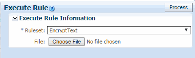

You must update these values in the XML file with the correct values to connect to the external system. To set the user name and password values, you run the rule EncryptText under the Execute Rule option in UIM GUI. Figure B-1 shows the GUI to run a rule and encrypt these values.
Figure B-1 Execute EncryptText Rule UI in UIM
Description of "Figure B-1 Execute EncryptText Rule UI in UIM"
See Base Rulesets for examples of running base rulesets.
