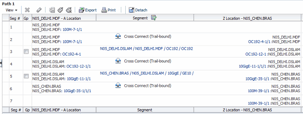

You can use service connectivities to represent services such as VoIP that are enabled by other connectivity. For example, Figure 16-1 illustrates a VoIP service that is enabled by an OC192 connectivity in one segment and a 10 Gbps Ethernet connectivity in another segment.

You can also use service connectivities to represent circuits that are designed internally by a provider and are not initially part of a service. They can be included subsequently in customer service designs. These connectivities are sometimes called Official Use or Company Use circuits.

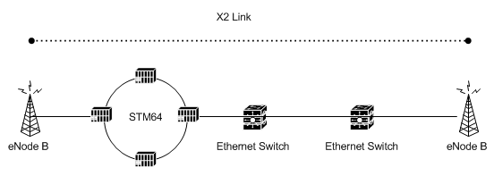

For example, a service connectivity could be used to represent an X2 link connecting cell towers in an LTE backhaul scenario. Figure 16-2 illustrates an X2 link enabled by other connectivities of various different technologies.
Figure 16-2 Service Connectivity for LTE Backhaul
Description of Figure 16-2 follows
Description of "Figure 16-2 Service Connectivity for LTE Backhaul"

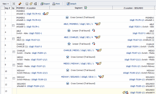

Figure 16-3 illustrates the Connectivity Design tab of this service connectivity. The service connectivity is enabled by five Ethernet connectivities, one of which is enabled by the STM64 ring.

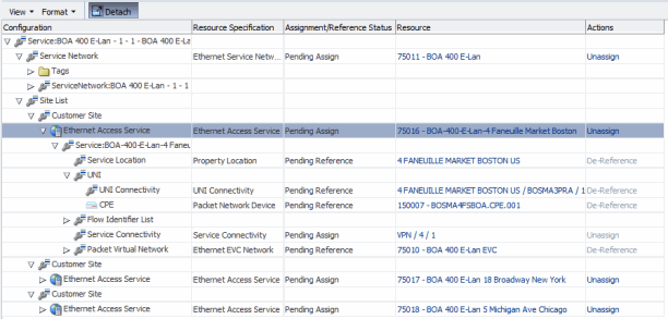

In a multipoint Carrier Ethernet network, service connectivities are network segments that connect service locations to a service provider network. For each service location, there is an Ethernet Access Service with a corresponding service connectivity. The service connectivity is enabled by the UNI connectivity that connects the CE device at the service location to the PE device at the provider network.
For example, Figure 16-4 illustrates the configuration of an E-LAN service. The service has three customer sites in Boston, Chicago, and New York. The Boston location's service connectivity is VPN / 4 /1, which is enabled by the 4 FANEUILLE MARKET BOSTON US/BOSMA3PRA UNI connectivity. Figure 16-5 illustrates the Connectivity Design tab of the service of VPN / 4 /1.
Figure 16-4 E-LAN Service with Ethernet Access Service and Service Connectivity
Description of Figure 16-4 follows
Description of "Figure 16-4 E-LAN Service with Ethernet Access Service and Service Connectivity"
Figure 16-5 Service Connectivity Design Tab
Description of Figure 16-5 follows
Description of "Figure 16-5 Service Connectivity Design Tab"

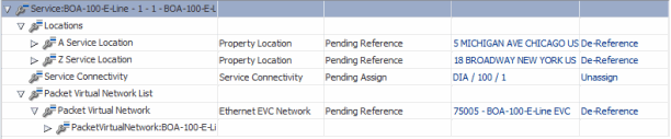

Service Connectivities in Point-to-Point Services

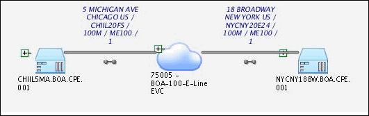

In a point-to-point service, such as an Ethernet E-Line service, the service connectivity spans the whole service from the A service location to the Z service location. Figure 16-6 and Figure 16-7 illustrate a service connectivity in the context of an E-Line service.
Figure 16-6 E-Line Service with Service Connectivity
Description of Figure 16-6 follows
Description of "Figure 16-6 E-Line Service with Service Connectivity"
Figure 16-7 E-Line Service with Service Connectivity - Schematic View
Description of Figure 16-7 follows
Description of "Figure 16-7 E-Line Service with Service Connectivity - Schematic View"

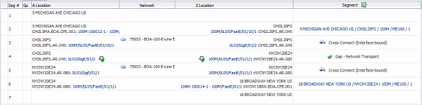

The service connectivity is enabled by UNI connectivities on the service location ends and network transport inside the service provider networks. Figure 16-8 illustrates the design of the service connectivity shown in the previous figures.
A gap enables the service connectivity within the provider network because the service connectivity reflects only the UNI connectivities up to their PVN trunk interfaces. The gap is automatically labeled Gap – Network Transport.
Figure 16-8 E-Line Service Connectivity Design
Description of Figure 16-8 follows
Description of "Figure 16-8 E-Line Service Connectivity Design"
