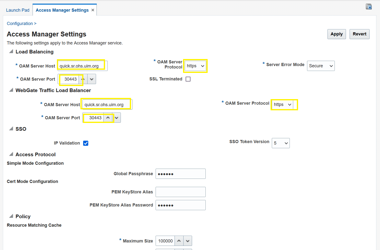

To configure OAM before using it for SSO authentication:
- Log in to Oracle Access Management (OAM)

- From Configuration Launch Pad, select Access Manager from the
View menu in the Settings section:
- Under Load Balancing and WebGate Traffic Load
Balancer, modify
OAM Server Hostwith<instance>.<project>.ohs.<hostSuffix >. ThehostSuffixvalue is taken from $SPEC_PATH/sr/quick/applications.yaml. By default, it is .uim.org. - Modify
OAM Server Protocoltohttps. - Modify
OAM Server Portto<loadBalancerPort>. This value is from $SPEC_PATH/sr/quick/applications.yaml. - Secure the load balancer port.
- Click Apply to save.
