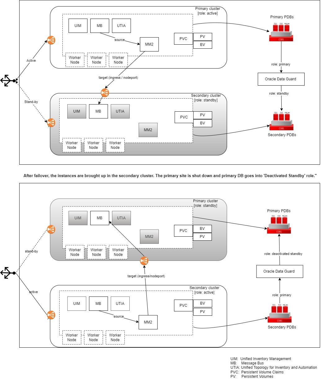

Figure 13-1 documents the disaster recovery plan for the data center. A parallel passive data center is maintained, where the runtime data is periodically replicated from the active data center to the passive data center. In the event of any catastrophic failures in the primary (or active) data center, the load must be switched to secondary (or passive) data center. Before switching the load to secondary data center, you should shutdown all the services in the primary data center and start all the services in the secondary data center.
Figure 13-1 Disaster Recovery Plan for Data Center
About Switchover and Failover
The purpose of a geographically redundant deployment is to provide resiliency in the event of a complete loss of service in the primary site, due to a natural disaster or other unrecoverable failure in the primary UIM site. This resiliency is achieved by creating one or more passive standby sites that can take the load when the primary site becomes unavailable. The role reversal from the standby site to the primary site can be accomplished in any of the following ways:
  • Switchover, in which the operator performs a controlled shutdown of the primary site before activating the standby site. This is primarily intended for planned service interruptions in the primary UIM site. Following a switchover, the former primary site becomes the standby site. The site roles of primary site and standby site can be restored by performing a second switchover operation, which is switchback.
  • Failover, in which the primary site becomes unavailable due to unanticipated reasons and cannot be recovered. The operator then transitions the standby site to the primary role. The primary site that is down cannot act as a standby site and will require reconstruction of the database as a standby database before restoring the site roles.

Switchover Sequence
To perform a switchover between site A (active) and site B (standby):
  1. Bring down instances in site A. These include UIM and ATA. Message Bus must be enabled to perform the replication using Mirror Maker.
    #Disable topology
    $COMMON_CNTK/scripts/delete-applications.sh -p uimprimary -i dr -f $SPEC_PATH/<project>/<instance>/applications.yaml -a ata
    #Disable UIM
    $UIM_CNTK/scripts/delete-instance.sh -p uimprimary -i dr -s $SPEC_PATH
  2. Perform switchover on DB. Site B DB will now become Primary. Site B DB will assume Standby role. Refer to Oracle 19c Documentation.
  3. Bring up instances in site B. This includes UIM and ATA. Message Bus should already be active:
    #EnableUIM
    $UIM_CNTK/scripts/create-instance.sh -p uimsecondary -i dr -s $SPEC_PATH
    #Enable topology
    $COMMON_CNTK/scripts/create-applications.sh -p uimsecondary -i dr -f $SPEC_PATH/<project>/<instance>/applications.yaml -a ata
  4. Perform DNS switching to route all traffic to site B.
Failover Sequence
In case of any irrecoverable failure in the primary site, perform a failover operation on the standby site. To do so:
  1. Perform failover on DB. Standby (secondary) DB will now become Primary. Primary site DB will assume Deactivated Standby role. Refer to Oracle 19c Documentation.
  2. Bring up instances in standby. This includes UIM and Topology. Message Bus should already be active:
    #EnableUIM
    #Enable topology
  3. Perform DNS switching to route all traffic to secondary instances.
Once the primary site to restored, establish a synchronization between secondary and primary site. To do so:
  1. Bring up Message Bus and DB in primary site:
    #Enable message bus
    $COMMON_CNTK/scripts/create-applications.sh -p uimprimary-i dr -f $SPEC_PATH/<project>/<instance>/applications.yaml -a messaging-bus
  2. Setup Kafka Mirror Maker with secondary Message Bus as source and primary Message Bus as target. See "About Kafka Mirror Maker" for more information.
  3. Switch primary DB role from Deactivated Standby → Standby. See "Deploying Unified Operations Message Bus" for more information.
As the synchronization between secondary and primary site is established, perform a switchover to the primary site. To do so:
  1. Bring up UIM in primary site:
    $UIM_CNTK/scripts/create-instance.sh -p uimprimary -i dr -s $SPEC_PATH
  2. Bring up Topology in primary site:
    $COMMON_CNTK/scripts/create-applications.sh -p uimprimary-i dr -f $SPEC_PATH/<project>/<instance>/applications.yaml -a ata
  3. Perform DNS switching to route all traffic to primary instances.
  4. Bring down instances in secondary site. This includes UIM and Topology. Message Bus should remain active for Kafka Mirror Maker synchronization:
    #Disable topology
    $COMMON_CNTK/scripts/delete-applications.sh -p uimsecondary-i dr -f $SPEC_PATH/<project>/<instance>/applications.yaml -a ata
    #Disable UIM
    $UIM_CNTK/scripts/delete-instance.sh -p uimsecondary -i dr -s $SPEC_PATH
