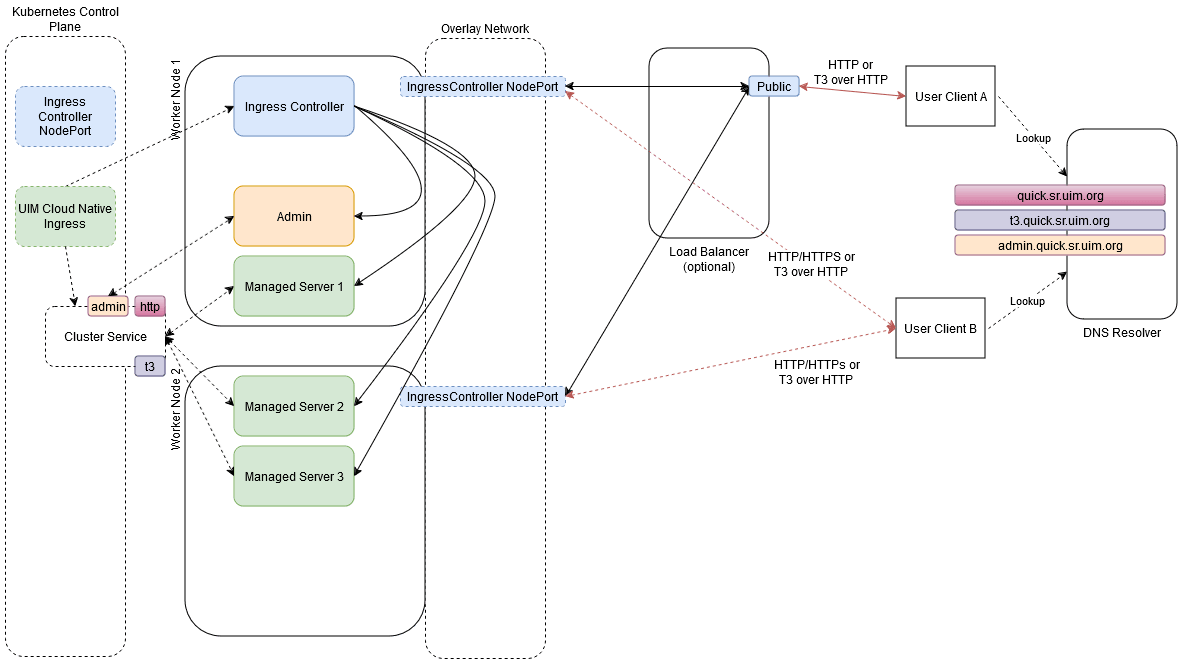

Connectivity Between the Building Blocks
The following diagram illustrates the connectivity between the building blocks in a UIM cloud native environment using an example:
Figure 9-1 Integration Across Building Blocks in UIM Cloud Native Environment
Invoking the UIM cloud native Helm chart creates a new UIM instance. In the above illustration, the name of the instance is "quick" and the name of the project is "sr". The instance consists of the WebLogic cluster that has one Admin Server and three Managed Servers and a Kubernetes Cluster Service.
The Cluster Service contains endpoints for both HTTP and T3 traffic. The ingress creation script creates the UIM cloud native Ingress object. The Ingress object has metadata to trigger the Generic ingress controller as a sample. Ingress controller responds by creating new front-ends with the configured "hostnames" for the cluster (quick.sr.uim.org and t3.quick.sr.uim.org in the illustration) and the admin server (admin.quick.sr.uim.org) and links them up to new back-end constructs. Each back-end routes to each member of the Cluster Service (MS1, MS2, and MS3 in the example) or to the Admin Server. The quick.sr.uim.org front-end is linked to the back-end pointing to the HTTP endpoint of each managed server, while the t3.quick.sr.uim.org front-end links to the back-end pointing to the T3 endpoint of each managed server.
The prior installation of Ingress Contoller has already exposed HAProxy itself through a selected port number on each worker node.
Inbound HTTP Requests
A UIM instance is exposed outside of the Kubernetes cluster for HTTP access via an Ingress Controller and potentially a Load Balancer.
Because the Ingress Controller port is common to all UIM cloud native instances in the cluster, Ingress Controller must be able to distinguish between the incoming messages headed for different instances. It does this by differentiating on the basis of the "hostname" mentioned in the HTTP messages. This means that a client (User Client B in the illustration) must believe it is talking to the "host" quick.sr.uim.org when it sends HTTP messages to Port on the access IP. This might be the Master node IP, or IP address of one of the worker nodes, depending on your cluster setup. The "DNS Resolver" provides this mapping.
In this mode of communication, there are concerns around resiliency and load distribution. For example, If the DNS Resolver always points to the IP address of Worker Node 1 when asked to resolve quick.sr.uim.org, then that Worker node ends up taking all the inbound traffic for the instance. If the DNS Resolver is configured to respond to any *.sr.uim.org requests with that IP, then that worker node ends up taking all the inbound traffic for all the instances. Since this latter configuration in the DNS Resolver is desired, to minimize per-instance touches, the setup creates a bottleneck on Worker node 1. If Worker node 1 were to fail, the DNS Resolver would have to be updated to point *.sr.uim.org to Worker node 2. This leads to an interruption of access and requires intervention. The recommended pattern to avoid these concerns is for the DNS Resolver to be populated with all the applicable IP addresses as resolution targets (in our example, it would be populated with the IPs of both Worker node 1 and node 2), and have the Resolver return a random selection from that list.
An alternate mode of communication is to introduce a load balancer configured to balance incoming traffic to the Ingress Controller ports on all the worker nodes. The DNS Resolver is still required, and the entry for *.sr.uim.org points to the load balancer. Your load balancer documentation describes how to achieve resiliency and load management. With this setup, a user (User Client A in our example) sends a message to quick.sr.uim.org, which actually resolves to the load balancer - for instance, http://sr.quick.uim.org:8080/Inventory/faces/login.jspx. Here, 8080 is the public port of the load balancer. The load balancer sends this to Ingress Controller, which routes the message, based on the "hostname" targeted by the message to the HTTP channel of the UIM cloud native instance.
By adding the hostname resolution such that admin.quick.sr.uim.org also resolves to the Kubernetes cluster access IP (or Load Balancer IP), User Client B can access the WebLogic console via http://admin.quick.sr.uim.org/console and the credentials specified while setting up the "wlsadmin" secret for this instance.
Access to the WebLogic Admin console is provided for review and debugging use only. Do not use the console to change the system state or configuration. These are maintained independently in the WebLogic Operator, based on the specifications provided when the instance was created or last updated by the UIM cloud native toolkit. As a result, any such manual changes (whether using the console or using WLST or other such mechanisms) are liable to be overwritten without notice by the Operator. The only way to change state or configuration is through the tools and scripts provided in the toolkit.

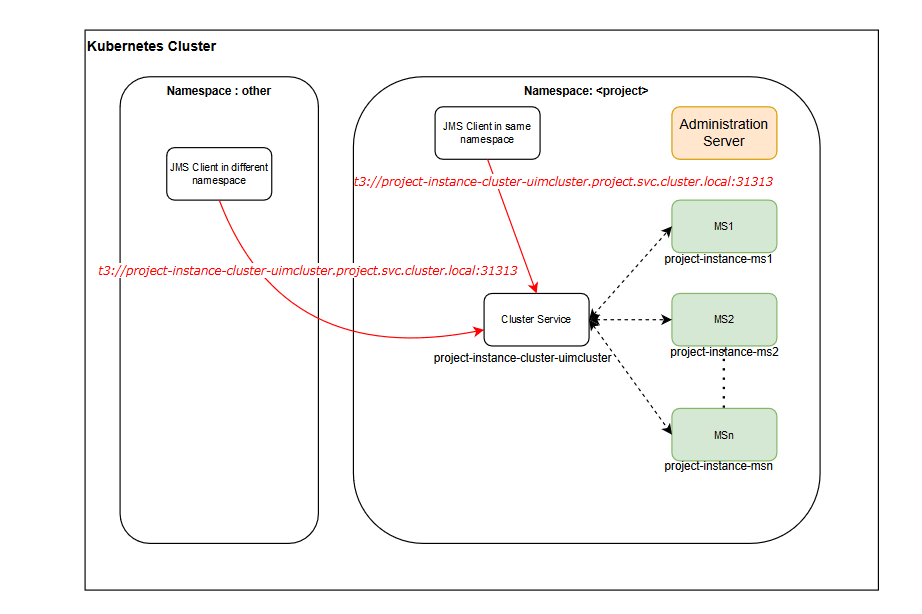

Inbound JMS Requests Within the Same Kubernetes Cluster
There can be situations where UIM cloud native needs to be accessed from within the same Kubernetes cluster where it is deployed. For example, in a Service and Network Orchestration (SNO) an upstream application (OSM) and downstream application UIM could be deployed in the same Kubernetes cluster. For such requirements, there is no need for the request to be routed via an Ingress Controller or a load balancer and resolved via a DNS Resolver.
UIM cloud native exposes a T3 channel exclusively for such connections and can be accessed via t3://project-instance-cluster-uimcluster.project.svc.cluster.local:31313.
This saves the various network hops typically involved in routing a request from an external client to UIM cloud native deployed in a Kubernetes cluster. The following diagram illustrates inbound JMS requests within the same Kubernetes cluster using an example. For the example, the URL is t3://sr-quick-cluster-uimcluster.sr.svc.cluster.local:31313.
The protocol is T3 as there is no need for wrapping in HTTP; the port is different.Figure 9-2 Inbound JMS Integration in a Kubernetes Cluster

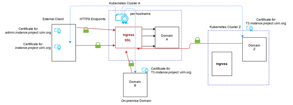

Configuring Secure Incoming Access with SSL
This section demonstrates how to secure incoming access to UIM cloud native. In the TERMINATE strategy, SSL termination happens at the ingress. The traffic coming in from external clients must use one of the HTTPS endpoints. When SSL terminates at the ingress, it implies that communication within the cluster, such as SAF between the UIM cloud native instances, is not secured.
The Common cloud native toolkit provides the sample configuration for HAProxy ingress. If you use Voyager or other ingress, you can look at the $COMMON_CNTK/charts/uim-ingress/charts/uim-ingress/templates/generic-ingress.yaml file to understand the configuration that is applied.
Generating SSL Certificates for Incoming Access
The following illustration shows when certificates are generated.
When UIM cloud native dictates secure communication, then it is responsible for generating the SSL certificates. These must be provided to the appropriate client. When a UIM cloud native instance in a different Kubernetes cluster acts as the external client (Domain Z in the illustration), it loads the T3 certificate from Domain A as described in "Configuring Access to External SSL-Enabled Systems".

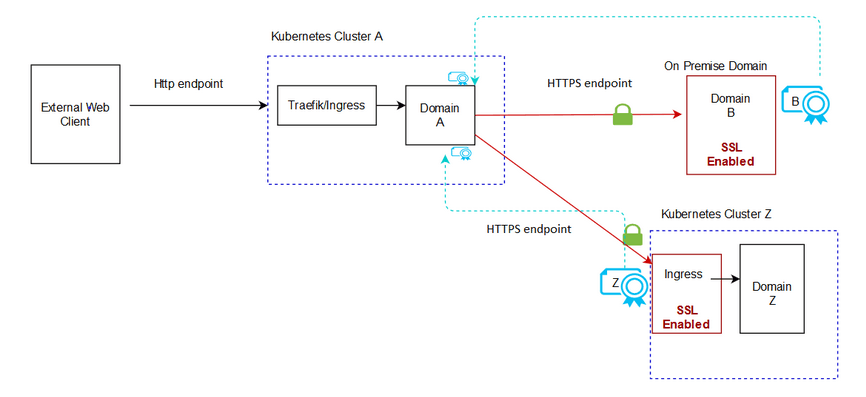

In order for UIM cloud native to participate successfully in a handshake with an external server for SAF integration, the SSL certificates from the external domain must be made available to the UIM cloud native setup. See "Enabling SSL on an External WebLogic Domain" for details about how you could do this for an on-premise WebLogic domain. If you have an external system that is already configured for SSL and working properly, you can skip this procedure and proceed to "Setting Up UIM Cloud Native for Outgoing Access".
Loading Certificates for Outgoing Access
In outgoing SSL, the certificates come from the external domain, whether on-premise or in another Kubernetes cluster. These certificates are then loaded into the UIM cloud native trust.
The following illustration shows information about loading certificates into UIM cloud native setup.
Figure 9-4 SSL Certificates for Outgoing Requests
To set up UIM cloud native for outgoing access:
- Set up custom trust using the following steps:
- Load the certificate from your remote server into a trust store
and make it available to the UIM cloud native instance.
Use the Java keytool to create a jks file (truststore) that holds the certificate from your SSL server:
keytool -importcert -v -alias alias -file /path-to/certificate.cer -keystore /path-to/truststore.jks -storepass passwordNote:
Repeat this step to add as many trusted certificates as required. - Create the commonTrust secret to store the created
truststore.jks
file.
$COMMON_CNTK/scripts/manage-app-credentials.sh -p project -i instance -s $SPEC_PATH create commonTrust #Provide Common TrustStore Details: Truststore Path: ./truststore.jks #provide truststore path Truststore Passphrase: ***** #provide truststore passphrase #verify secret created secret/project-instance-common-truststore created
- It is mandatory to Set up custom identity using the following steps
when trust is passed:
- Create the keystore from commoncert.pem and
commonkey.pem.
openssl pkcs12 -export -in <path-to-certs>/commoncert.pem -inkey <path-to-certs>/commonkey.pem -out keyStore.p12 -name "identity" keytool -importkeystore -srckeystore keyStore.p12 -srcstoretype PKCS12 -destkeystore identity.jks -deststoretype JKS - Create the
secret.
kubectl create secret generic secretName -n project --from-file=secretName.jks=</path-to/identity.jks> --from-literal=passphrase=passphrase # verify kubectl describe secret -n project secretName - Edit the app-uim.yaml file at location
$SPEC_PATH/project/instance, uncomment, and provide following
properties:
uim: identity: name: secretName . alias: identity #alias used to store key in keystore
commonkey.pem.
- Configure SAF by updating the SAF connection configuration in the UIM
cloud native app-uim specification file to reflect t3s and the SSL
port:
safConnectionConfig: - name: simple t3Url: t3s://remote_server:7002 secretName: simplesecret - Create the UIM cloud native instance as usual.
Adding Additional Certificates to an Existing Trust
You can add additional certificates to an existing trust while a UIM cloud native instance is up and running.
To add additional certificates to an existing trust:
- Set up UIM cloud native for outgoing access. See "Configuring Access to External SSL-Enabled Systems" for instructions.
- Copy the certificates from your remote server and load them into the
existing truststore.jks file you had created:
keytool -importcert -v -alias alias -file /path-to/certificate.cer -keystore /path-to/truststore.jks -storepass password - Re-create your Kubernetes secret using the same name as you did
previously:
$COMMON_CNTK/scripts/manage-app-credentials.sh -p project -i instance -s $SPEC_PATH create commonTrust #Provide updated TrustStore Details: Truststore Path: ./truststore.jks #provide updated truststore path Truststore Passphrase: ***** #provide truststore passphrase - Restart the instance to force WebLogic Operator to re-evaluate:
$COMMON_CNTK/scripts/restart-applications.sh -p project -i instance -s $SPEC_PATH -a uim -r all
Debugging SSL
To debug SSL, do the following:
- Verify Hostname
- Enable SSL logging
Verifying Hostname
When the keystore is generated for the on-premise server, if FQDN is not specified, then you may have to disable hostname verification. This is not secure and should only be done in development environments.
managedServers:
project:
#JAVA_OPTIONS for all managed servers at project level
java_options: "-Dweblogic.security.SSL.ignoreHostnameVerification=true"Enabling SSL Logging
When trying to establish the handshake between servers, it is important to enable SSL specific logging.
managedServers:
project:
java_options: "-Dweblogic.StdoutDebugEnabled=true -Dssl.debug=true -Dweblogic.security.SSL.verbose=true -Dweblogic.debug.DebugSecuritySSL=true -Djavax.net.debug=ssl"Using Wild Card SSL Certificates
UIM cloud native supports wildcard certificates. You can generate wildCard
Certificates with the hostSuffix value provided in the
applications-base.yaml spec files. The default is uim.org.
To use Wild Card certificates:
- To create a self-signed wild card certificate, run the following
command:
openssl req -x509 -nodes -days 365 -newkey rsa:2048 -keyout $COMMON_CNTK/certs/wildcardkey.pem -out $COMMON_CNTK/certs/wildcardcert.pem -subj "/CN=*.uim.org" -extensions san -config <(echo '[req]'; echo 'distinguished_name=req'; echo '[san]';echo 'subjectAltName=@alt_names'; \echo '[alt_names]'; \ echo 'DNS.1=*.uim.org'; \ ) - Change the
subDomainNameSeperatorvalue from period (.) to hyphen (-) so that incoming hostnames match the wild card DNS pattern and update the $SPEC_PATH/project/instance/applications-base.yaml file as follows:#Uncomment and provide the value of subDomainNameSeparator, default is "." #Value can be changed as "-" to match wild-card pattern of ssl certificates. #Example hostnames for "-" admin-quick-sr.uim.org, quick-sr.uim.org, t3-quick-sr.uim.org subDomainNameSeparator: "-" - For the above configured settings, use the following hostnames to access UIM
application for
project:sr,instance:quickandloadBalancerDomainName: uim.org:uim-admin hostname: admin-quick-sr.uim.org uim hostname: quick-sr.uim.org uim-t3 hostname: t3-quick-sr.uim.org
