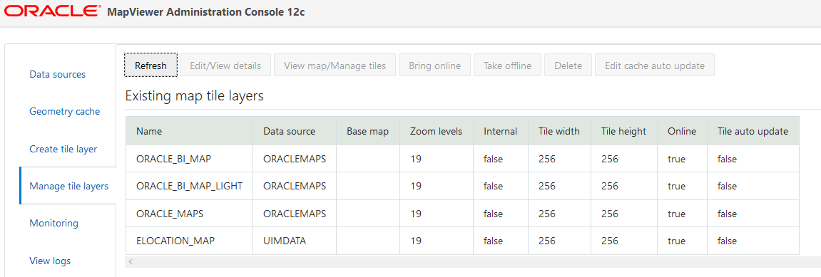

  6. Verify the map is set up changes from Existing map tile layers section in Manage tile layers page.
    Figure 11-1 shows an example of existing map tile layers.
    Figure 11-1 Example of Existing Map Tile Layers
The map tile layer is the link between UIM and MapViewer.
There is no limit to the number of map tile layers you can set up.
