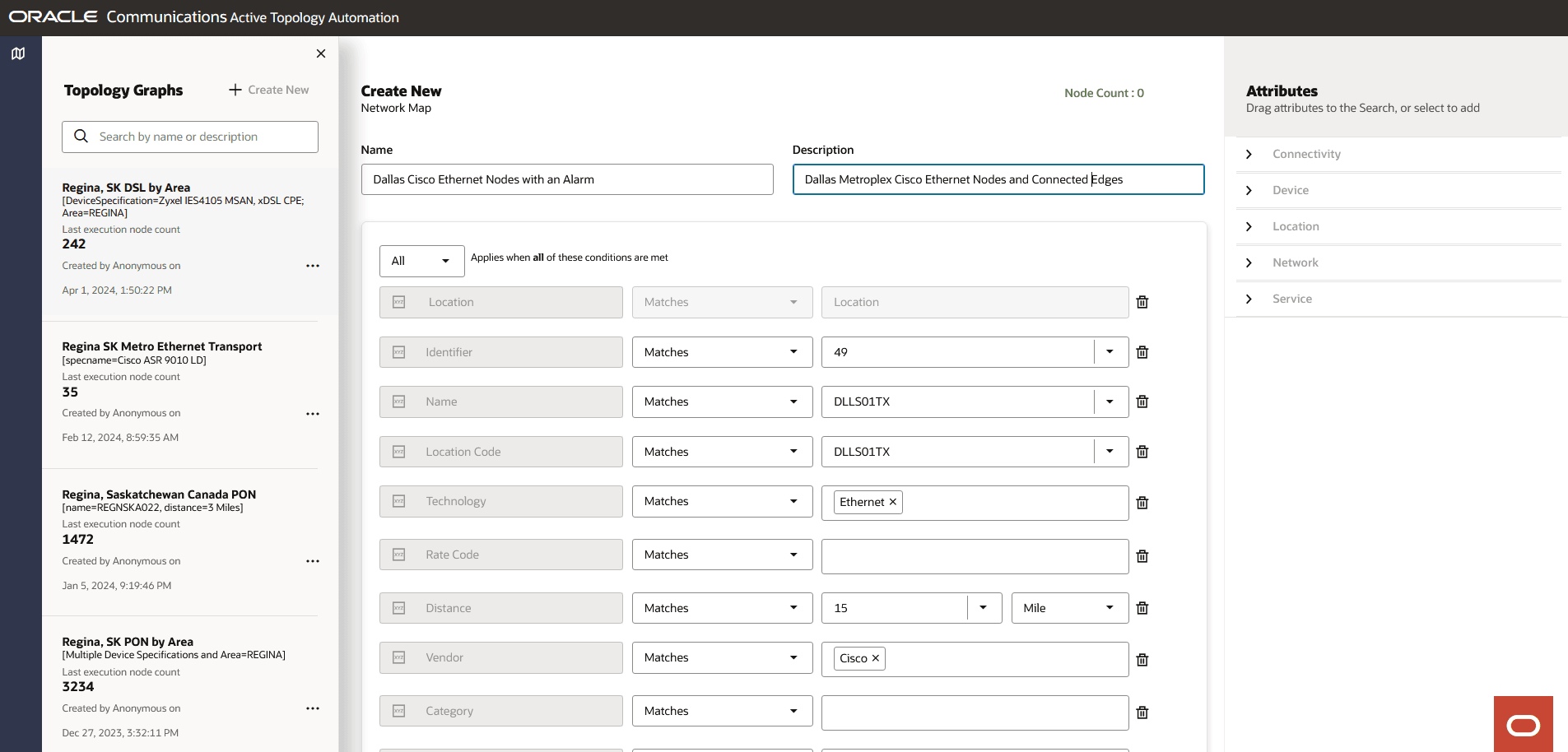

The following image shows the Create New search pane.
Figure 4-1 Customizing Network Search

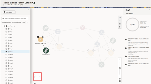

After you expand or isolate a subnetwork, you can view the subnetwork name on the top-left corner of the canvas.

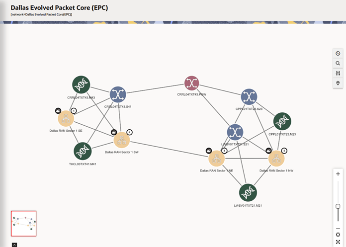

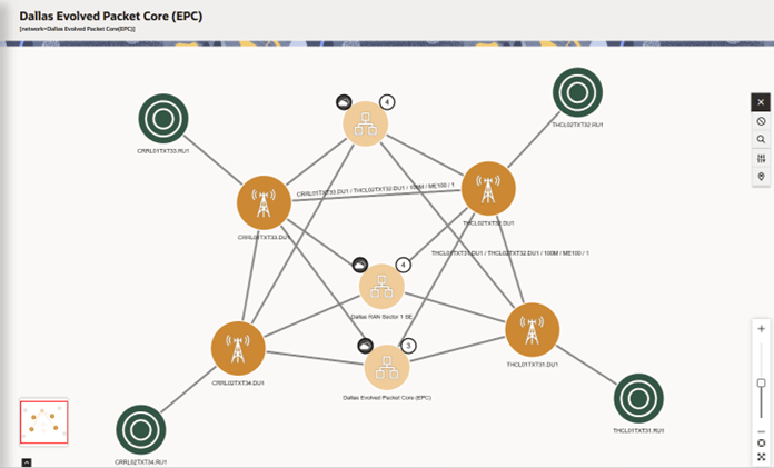

Figure 4-2 Network with Subnetworks
Figure 4-2 shows the Dallas EPC network with four subnetworks, where each subnetwork has four internetwork nodes.
Figure 4-3 Isolated view of Subnetwork
Figure 4-3 shows the Isolate view of the Dallas RAN Sector 1 SE subnetwork. It shows all the nodes in the subnetwork and all interconnections to that subnetwork.

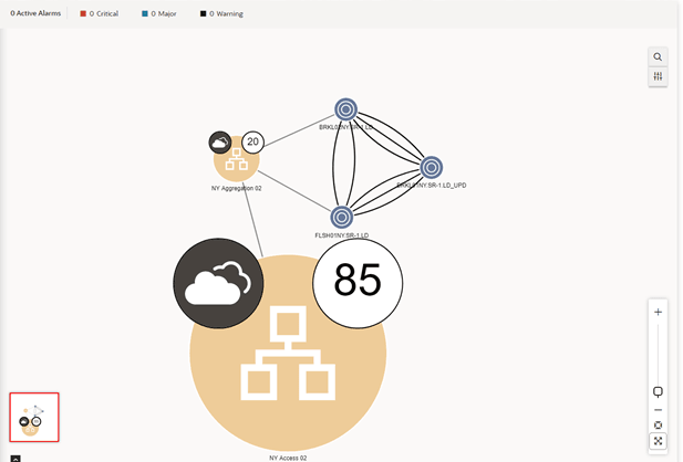

Figure 4-4 Expand Node view of a Subnetwork
Figure 4-4 shows the Expand Node feature with one internetwork node.

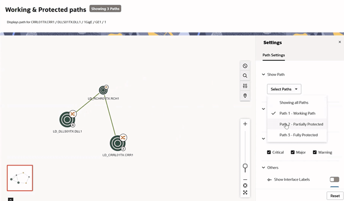

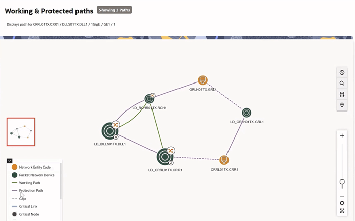

Viewing the Working and Protected Paths
You can view the available paths for any connectivity on the canvas by right clicking on the edge and selecting Show Paths. The Show Paths action opens the Working and Protected Paths page. As shown in Figure 4-6, the page displays that three paths are available for the selected connectivity 1GigE connectivity from CRRL01TX to DLLS01TX.
Figure 4-6 Working and Protected Paths
The legend in Figure 4-6 displays the following:
  • The green path represents working paths. There is one working path in the above figure.
  • The purple path represents protection paths. There are two protection paths in the figure.
  • The A and Z icons represent the termination points for the connectivity trail.
  • The This icon shows two crossed arrows. It indicates cross connection on a device. icon represents a cross-connection on the device.
  • The This icon represents a jumper on the device. icon represents a jumper on the device.
If you click on either the cross-connect or jumper icons, the device interface or port details are displayed, as shown in Figure 4-7.

You can filter specific paths in the Settings panel. For example, Figure 4-8 illustrates a scenario where only Working Paths are selected to be shown. It is also possible to view all paths, or any desired combination of paths. In this example, Path 2 provides Partial Protection and Path 3 provides full protection.
Figure 4-8 Customizing Paths to be Displayed on Working and Protected paths page
You can also choose the Show Interface Labels, Show Connectivity Labels and Show Node Labels options in the settings panel as in Figure 4-9. By default, Show Connectivity Labels and Show Node Labels are enabled and Show Interface Labels is disabled. Enabling the Show Interface Labels option will display the device interface ID/Name, or the Port ID/Name.
Figure 4-9 Interface Labels Enabled on Working and Protected Paths

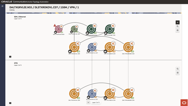

Viewing Connectivities in a Layered View
You can use the layered view to display the hierarchical structure of services and connectivities within the topology graph. You can use the following options:
  • To view connectivities below a selected connectivity, use Show Underlay.
  • To view services or connectivities above a selected connectivity, use Show Overlay.
To view connectivities in a layered view:
  1. Select the required connectivity from the topology graph.
  2. Right-click, and then select one of the following options from the context menu:
Viewing Underlay Connectivities in a Layered View
The layered view displays the name of the selected service or connectivity in the page title, with Underlay shown as the subtitle. The canvas shows the first two enabling layers. In the top-left corner of each layer, you can find the technology, layer number, and total number of layers. Nodes that exist in both visible layers are linked by a dashed line, called the bridge connection, making it easy to identify the shared nodes. Moving a common node in one layer automatically moves the corresponding node in the other layer. The following image shows the Underlay page with common nodes.
You can have unlimited number of enabling layers in a layered view.

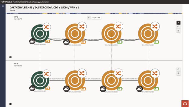

To view underlay connectivities in a layered view:
  1. Right-click on the required service or connectivity and select Show Underlay.
    The Underlay page appears, displaying a layered view of all nodes and connectivities under the selected connectivity or service.
  2. Select a network element or a connectivity in a layer to view its details.
  3. Click the Settings icon to adjust the settings.
  4. Use the Layer n tab or Global tab to customize layer-specific or global settings.
    Where, ‘n’ indicates the selected layer number.
  5. On the Layer n tab:
    • Select a layout from the Layout list.
      If you choose Geo Map Layout, the view switches to the map layout.
    • Enable the required options in Alarm Status.
      You can choose multiple alarm statuses.
  6. On the Global tab:
    • Select the desired path from the Show Path list.
      You can select either a single path or all available paths. By default, the first path is displayed on the canvas.
    • Set the maximum number of paths using the Max Paths list.
      The maximum number of paths supported is 10.
    • Enable required labels and synchronization settings under Other Settings. The options are:
      • Show Interface Labels: By default this label is turned off.
      • Show Connectivity Labels: By default this label is turned on.
      • Show Node Labels: By default this label is turned on.
      • Bridge Node Synchronization: By default this label is turned on. If you do not want the corresponding node in the adjacent layer to move when you move the selected node, turn off this label.
  7. In the layered view, click the Cross Connect icon above the network element to view the cross connects.
  8. View the node capacity by clicking the battery icon below the network element. The bottom-right corner shows the capacity badge that indicates the current node capacity in 0–25%, 25–50%, 50–75%, or 75–100% range.
    If there is an alarm on the node, an alarm badge appears. If the node is part of a network, the network badge appears in the bottom-right corner. Hover over the network badge or the node, the corresponding network name appears above the node.
  9. Zoom in or out on the desired layer using your mouse to adjust the view.
  10. Refer to the legend at the bottom of the layered view for icon, path, and specification definitions, and their corresponding colors and symbols.
  11. If there are more than two layers, a dropdown arrow appears indicating the number of additional layers available. Select the down arrow to navigate to the next layer. The canvas will scroll showing layers 2 and 3.
    Similarly, if more layers exist above the currently visible ones, an upward arrow appears indicating the additional layers above.
    The following image shows the view when there are more than two layers.

Searching within a Topology Graph
You can search for the required network elements within a selected topology graph. You use the Search icon at the right corner of your topology canvas.
Click on the Search icon opens a search panel on the left. You can select the following options while searching:
  • Select Search and Filter Topology to search, filter, and view the topology based on a search criterion. See "Using Search and Filter Topology" for more information.
  • Select Ring Search to search the naturally occurring rings in the topology graph displayed on the canvas. See "Using Ring Search" for more information.
The Search and Filter Topology panel has a search bar with filter options under it. Each filter option represents one filter type, such as Location, Network Type, and so on. Each option has a value chosen by default. Below the search bar is a list of all the nodes and edges in a topology graph. The nodes are grouped into categories by Location, while the edges are grouped separately.
The following filters and child filters are available in ATA:
  1. Location
    • Location Code
    • Alarm (Yes, No)
    • Device Type
  2. Network Type
    • Alarm (Yes, No)
    • Device Type
  3. Device Type
    • Alarm (Yes, No)
  4. Technology
    • Rate Code
    • Connectivity Specification
When a user selects any filter, the corresponding child filter (the second-level filter) appears, and it's corresponding values can be selected.
Use Search and Filter Topology as follows:
  1. Search for a network element or multiple network elements within the topology graph.
    You can use a global search by entering a required value to search for the network element.
    The search is case sensitive.
  2. View all nodes and edges in a tree view.
  3. Select the required nodes or edges from the tree view to the selected elements highlighted within the topology graph and an overview panel appears on the right-side that shows the details of the selected node or edge.
  4. Use the filter chip options to filter and search for the required network elements. You get the filter chip options based on the network elements you select.
  5. Use the filter chip options as follows:
    1. Select an option to view the corresponding list of network elements.
      You may select any number of filter chip options.
    2. Click on the selected option within the Search bar to view a list of values you can select.
    3. Select the required value to view the list of network elements for the selected value.
      The highlighted nodes appear along with their associated edges in the canvas. When filters are removed, the entire topology appears.
    4. Select Node or Edge to toggle between the list of nodes or edges.
      For edge search, the terminal nodes of the matching edges appear on the canvas.
    5. Click on a filter chip to change the value of the corresponding filter chip.
    6. Select a filter chip to view only the corresponding part of the topology graph in the canvas.
    7. Close the filter option to deselect the filter.

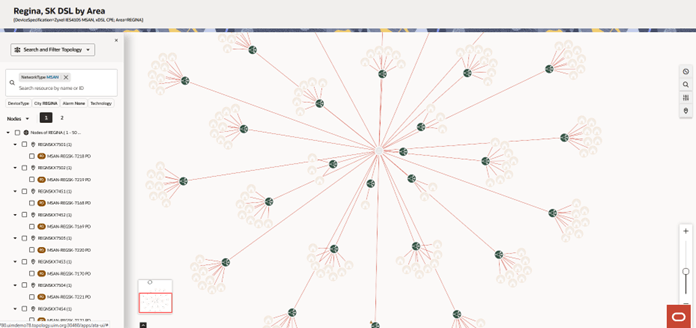

Figure 4-10 Example of Network Type Filter Applied to a Network
Figure 4-10 shows an example where the Network Type filter with value "MSAN" has been applied. The nodes are filtered in the tree-view on the left panel as per the value, and highlighted in the canvas.
Using Ring Search
A network ring is a closed loop of nodes and edges that starts from a node, connects other nodes and ends at the starting node.
Ring Search allows the user to find all the naturally occurring rings in a searched network displayed on the canvas. Using the Ring Search, you can search for all rings based on nodes and edges. The Ring Search can be customized by creating a custom graph based on the criteria you wish to use in identifying the rings. For example, you can build a search querying all devices with a specific technology and connectivity with a specific rate code for a specific area.
When you switch to the Ring Search, the list of rings in the graph appears on the left side of the screen.
For very large graphs the calculation of rings is limited, but you can choose to calculate all rings for a moderate graph.
You can view ring information by selecting a ring from the list. The chosen ring is highlighted on the canvas, and the Ring Capacity panel appears on the right side of the canvas.
The Ring Capacity panel provides the following details:
  • Total Capacity: The total capacity of all edges within the ring.
  • Capacity Consumed: The sum of the capacity values of all edges within the ring.
  • A linear visualization of the ring with all nodes and the corresponding edges within the ring.
You can choose to view any number of rings or all rings available on the topology. When you select a ring, the associated nodes and edges appear in a tree view in the Ring Search panel. If the list of nodes/edges/rings is too long, then it is divided into different pages that can be viewed by clicking the page numbers listed next to the dropdown menu.
You can also filter rings using the filter chip options below the search bar. For example, if you select a filter chip for a specific location, all rings that are available within the filtered location in the rendered network appear. See "Viewing and Filtering Rings within a Searched Network" for more information.
The following image shows the ring search within a searched network:
Figure 4-11 Search for a Ring within a Network
To view rings within a searched network:
  1. From the topology graph, click on the Search icon.
    The search panel appears.
  2. Select Ring Search from the dropdown list.
    The list of all rings available within the network appears.
  3. Select the required ring from the list.
    The selected ring gets highlighted within the network along with Ring Capacity panel on the right side. You can see the list of nodes and edges associated with the selected ring in a tree view.
    You can select multiple rings from the list of rings.
To filter rings:
  1. Use the filter chip options available under search to view the rings available for that filtered criteria within the searched network.
    You can use multiple filter chips to view the rings that meet the filtered criteria.
  2. Click on the selected filter chip to change the value of the filter.
  3. Search for any ring by its name or ID using the global search option.
  4. Search for any node or edge within the ring using the global search option.
