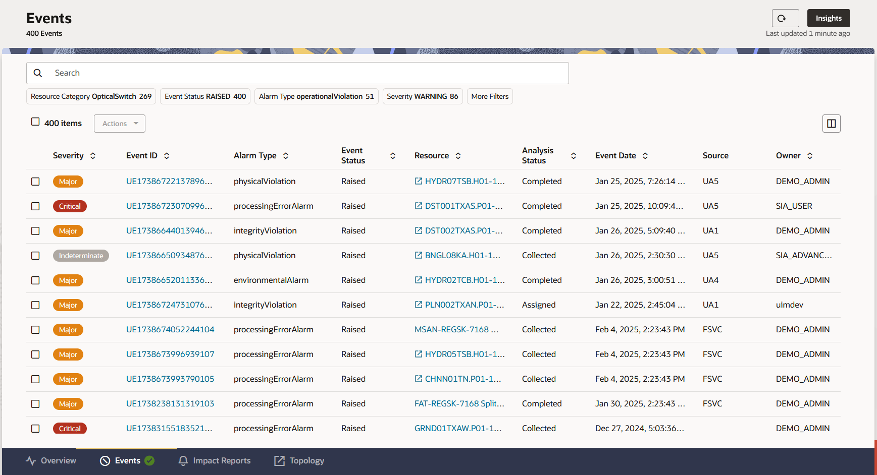

11 Using the Events Tab
You use the Events tab to view the list of all events occurred in a table with the following columns:
Table 11-1 Events Columns
Column Description
Severity The severity of the alarms. The alarm severities are:
  • Critical
  • Major
  • Warning
  • Indeterminate
  • Minor
Event ID A unique ID for the event.
Alarm Type The alarm type of the event. See "About Alarm Types" for the list of alarm types.
Event Status The event status that you get from the assurance system. See "About Event Statuses" for more information.
Resource The resource that on which the event has occurred. This is a hyperlink, clicking on which you can view the summary of the corresponding resource in UIM.
If you are an authorized user, you can decrypt the encrypted values using the Decrypt icon from the resource summary Characteristics side pane of the General Information tab.
Analysis Status The lifecycle status of the impact data analysis. See "About Analysis Status" for more information.
Created On The date when the event was created.
Source The source of the event, which is the unique identifier of the assurance system from which the event is collected.
Owner The person who is assigned to work on the alarm event.
Using the Events tab, you can perform the following:
  • Viewing the list of events.
  • Searching and filtering the events using customizable filter chips.
  • Customizing the columns.
  • Viewing insights of the events.
  • Performing actions on the selected events.
The following figure shows the Events tab of Service Impact Analysis.
Figure 11-1 Events tab of Service Impact Analysis
Viewing the List of Events
The Events tab provides the details of all events that have occurred. You can scroll down to view the list of all events.
To view the list of events:
  1. Navigate to the Events tab.
    The list of events appears in a table.
  2. Search the events using the filter options. See "Searching and Filtering the Events" for more information.
  3. Sort the columns using the corresponding sort options.
  4. Click on the required event ID link to view the event details.
    The Event Details panel appears that shows the event summary. See "Working with Event Details" for more information.
  5. Click on the required resource link to open the corresponding resource summary.
  6. Select a row using the corresponding checkbox.
  7. (Optional) Select all rows in the table using the total count checkbox.
  8. Select an option from the Actions list. See "Performing Actions on the Selected Events" for more information.
  9. Click Insights on the top-right corner of the Events page to view the insights. See "Viewing Insights of the Events" for more information.
  10. Click the Refresh icon beside the Insights button to refresh the events list.

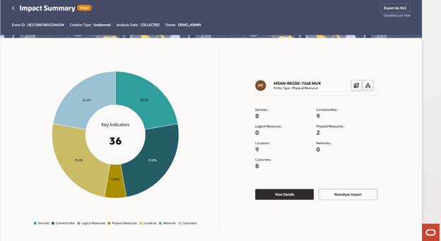

Viewing Impact Summary
You can view the summary of the impact analysis you perform.
To do so:
  1. From the Event Details panel of a selected event, click View Impact Summary after you perform a new impact analysis.
    The Impact Summary page appears with further analysis of the event. The impact analysis details include Event ID, Creating Type, Analysis State, and Owner.
  2. Use the pie chart to understand the impact analysis.
  3. Hover over the pie chart for more details on the event.
  4. Hover over the resources legend to highlight the corresponding resource details in the pie chart.
  5. Click on the View Resource in Inventory icon to open the resource summary in UIM.
  6. Click on the View Resource in Topology icon to open the resource details in ATA.
  7. Click View Details at the bottom of the page to view further details on the impact analysis details.
    The Impact Analysis Details page appears. See "Working with Impact Analysis Details" for more information.
  8. Click Reanalyze Impact to delete the current impact and run the impact analysis again.
  9. On the top-right corner of the page, click Export As XLS to export the analysis into a spreadsheet.
    The spreadsheet is downloaded to your system.
  10. On the top-left corner of the page, click on the Back icon to go back to the Events tab.
The following figure shows the impact summary of a selected event:
Figure 11-2 Impact Summary View of a Selected Event

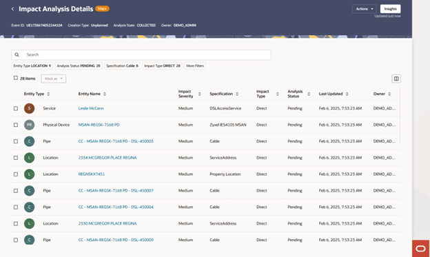

You use the Impact Analysis Details page to understand more about the generated impact analysis. The Impact Analysis Details page shows the following details of the analysis:
  • Event ID
  • Creation Type
  • Analysis State
  • Owner
The Impact Analysis Details page shows the following details of entities impacted because of the analysis:
Table 11-2 Impact Analysis Details
Impact Analysis Details Column Description
Entity Type The entity or resource type from UIM. The valid values are:
  • CONNECTIVITY
  • CUSTOMER
  • LOCATION
  • LOGICAL RESOURCE
  • NETWORK
  • PHYSICAL RESOURCE
  • RING
  • SERVICE
Entity Name The name or ID of the entity or resource from UIM. This is a hyperlink and displays the entity details in a side panel.
Impact Severity The severity level of the impact. The valid values are:
  • HIGH
  • LOW
  • MEDIUM
  • NO_IMPACT
Specification The resource or entity specification from UIM.
Impact Type The impact type. The valid values are:
  • DIRECT
  • INDIRECT
  • HORIZONTAL
Analysis Status The analysis status. The valid values are:
  • PENDING: The impacts have been identified by the system and are available to review.
  • ASSIGNED: A user is assigned to analyze the event.
  • QUALIFIED: The user has qualified the impacted item.
  • DISQUALIFIED: The user has disqualified the impacted item.
Last Updated The date when the impact was last updated.
Owner Name of the owner who is assigned with the impact to resolve.
To work on the Impact Analysis Details:
  1. Open the Impact Analysis Details page.
  2. Enter a name or a value in Search to view the corresponding search results.
  3. Use the filter tags available and select the corresponding values to choose the filter values.
  4. Click More Filters to customize the filters.
  5. From the results table, select the required analysis record.
    1. Select Assign Owner from the Mark as list to assign the owner.
    2. Select Change Impact Severity to select a severity value from the list in the Change Impact Severity panel and then click Save.
    3. Click Analyze Result, select the required value from the Analyze Result panel, and then click Mark.
  6. From the Actions list on the top-right corner, select either of the following:
    1. Export As XLS to export the analysis to a spreadsheet.
      The Export As XLS is disabled by default. It is enabled after you select the entities that you want to export.
    2. Generate Report to generate a report.
      The Analysis Status value gets changed to COMPLETED after the report is generated.
      You can no longer modify the analysis details after the Analysis Status value becomes COMPLETED.
      All impacted items of the event should be analyzed to either Qualified or Disqualified to generate the report.
  7. Click Insights on the top-right corner.
    The Insights panel appears that helps you understand further details about the analysis. See "Viewing Insights of the Events" for more information.
  8. (Optional) Hover over the corresponding insights details to view more details.
  9. On the top-left corner, click on the Back icon to go back to the Impact Summary page.
The following figure shows the Impact Analysis Details page that opens from the Impact Summary page.
Figure 11-3 Impact Analysis Details Page
You can search by entering the required value of the event or by using filter options. The filter options can be used to view the list of events according to the selected filter criteria. Each of the filter options displays the number of records or events exist for the corresponding filter option.
To search and filter the events:
  1. In the Events tab, enter the required value in the Search field.
    The list of events appears as per the searched criteria.
  2. To filter the list of events, use the following filter chips or options:
    • Resource Category
    • Event Status
    • Alarm Type
    • Severity
  3. (Optional) Use More Filters to customize the filter tags.
    The corresponding filter criteria is added to the search criteria.
  4. Select the corresponding values within the filtered criteria to filter the list further.
    The corresponding filtered list appears.

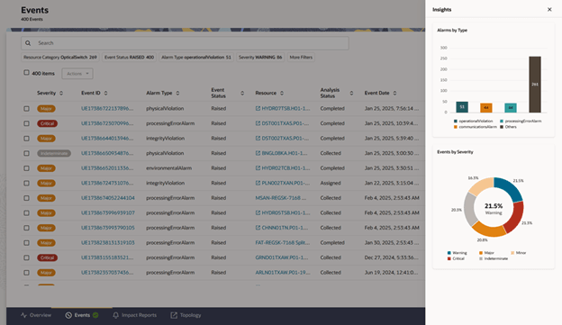

You can view additional analysis on the events using the Insights panel.
To view insights of the events:
  1. In the Events tab, click Insights on the top-right corner of the page.
    The Insights panel appears with additional analysis on the list of events.
  2. In the Alarm by Type section of the insights, hover over the corresponding alarm type to view the details.
  3. In the Events by Severity section of the insights, hover over the pie chart to view the details.
  4. Use the severity legend at the bottom of the Insights panel to understand the colors used for alarm severities.
Figure 11-4 Insights Panel on Events Page
