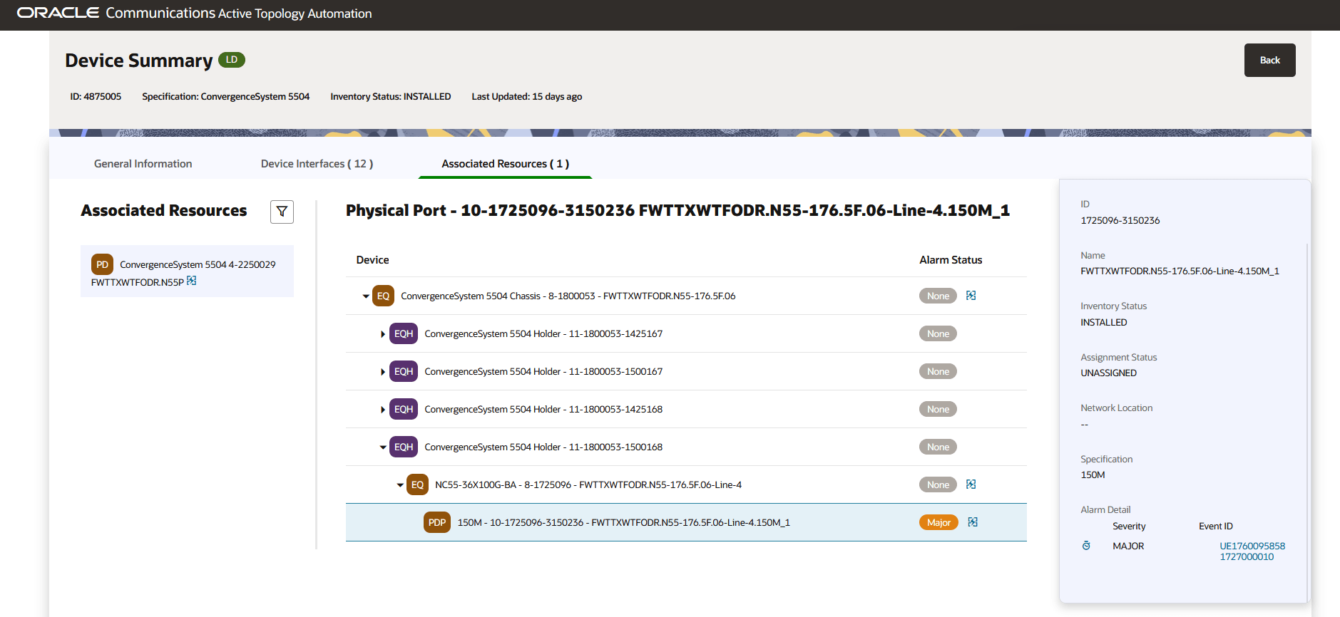

  • Associated Resources tab: The label of this tab shows the number of associated resources that the topology component has.
    For example: If a Logical Device and Equipment are associated with a Physical Device, the Associated Resources tab of the Physical Device shows the Logical Device and Equipment associated with it.
    After you open the tab, a list of all the associated resources (if any) appears. You can filter this list with the entity type. From the list, select a resource to view the details in the side pane. You can also view the summary of the resource from the Summary for <resource ID> side pane.
    You can view the alarms associated with the entities in a tree view. Clicking on the entity shows the alarm details in the Summary panel on the right. These alarms are always shown on the highest-level devices. For example, if there is an alarm on a Port in an Equipment, and the Equipment has association to a Physical Device which is associated to a Logical Device, the alarm appears on the highest-level device, which is Logical Device. You can use Viewing Alarm Details from ATA icon to view the alarm details within ATA.
  • Back button: Click this button to go back to the topology graph.
The following image shows the Associated Resources tab:
Figure 6-1 View of Associated Resources tab

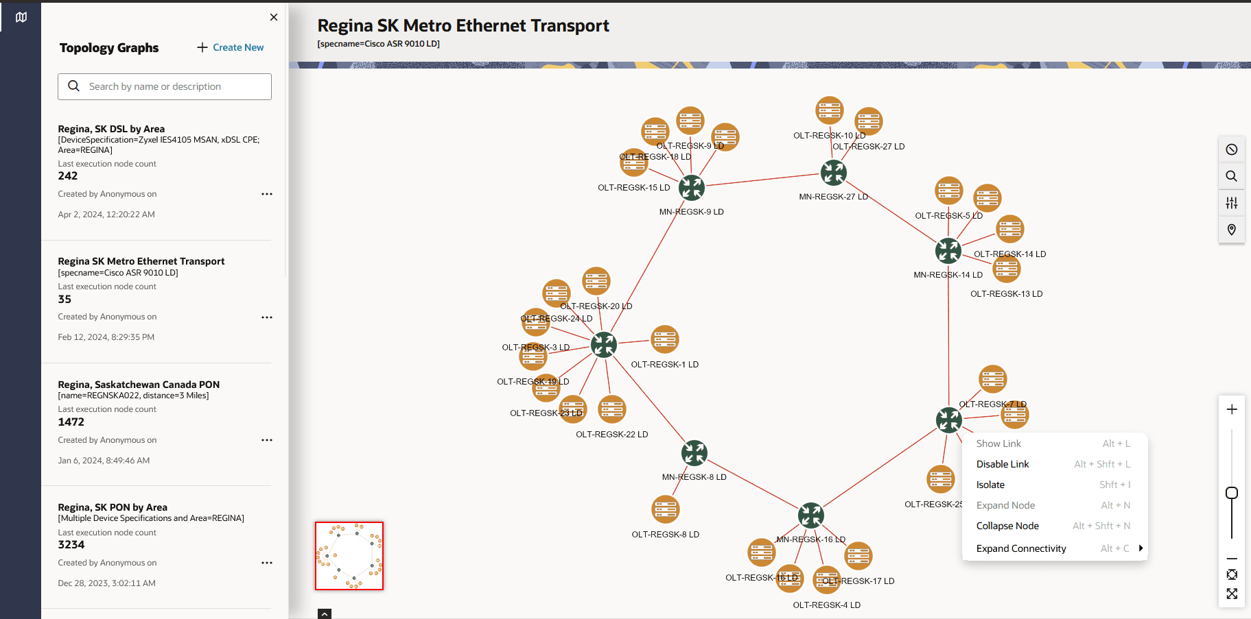

Adding Settings from a Context Menu
You can select a topology component and add settings using the context menu, which opens when you right-click on the component. You can also use the keyboard shortcuts for adding these settings.
The following image shows the context menu options and the corresponding keyboard shortcuts.
Figure 6-2 Context Menu for Adding Settings to topology Components
The following context menu options appear based on the entity/node you have selected:
  • Show Link: Displays the links that are connected to the selected component.
  • Disable Link: Disables all the links that are connected to the selected component.
  • Isolate: Isolates the selected component from the rest of the topology graph. You can go back to the original topology graph by clicking The image shows the isolation cancellation icon..
  • Expand Node: Displays all the internetwork nodes within the network.
  • Collapse Node: Collapses all the expanded subnetworks.
  • Expand Connectivity: Expands the connectivity by the number of hops that you select. For example, you can view the connectivity for an additional 3 hops even though the original query does not include these nodes.
