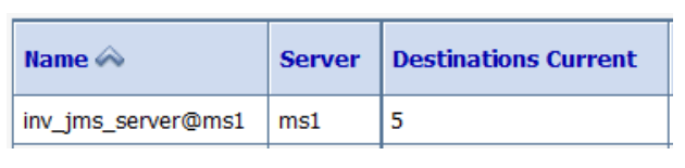

For example, for a JMS server when there is only 1 managed server running, you can see the server details as follows, in the WebLogic console:
Figure 13-1 Server Details for a JMS Server with One Managed Server
Notice that uim_jms_server@ms1 is targeting ms1.

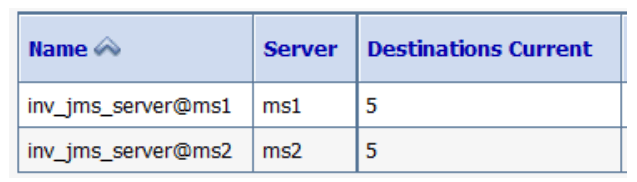

When scaled to 2 Managed Servers, the WebLogic console shows the following server details:
Figure 13-2 Server Details of WebLogic Console with Two Managed Servers
Notice that uim_jms_server@ms1 is targeting ms1 and uim_jms_server@ms2 is targeting ms2.

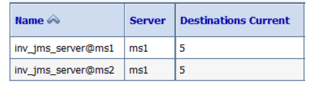

After scaling back to 1 managed server, the WebLogic console shows the following server details:
Figure 13-3 Server Details of WebLogic Console with One Managed Server
Notice that the JMS Server uim_jms_server@ms2 is not deleted and is targeting ms1.
This is completely expected behavior. This is a WebLogic feature and not to be mistaken for any inconsistency in the functionality.
